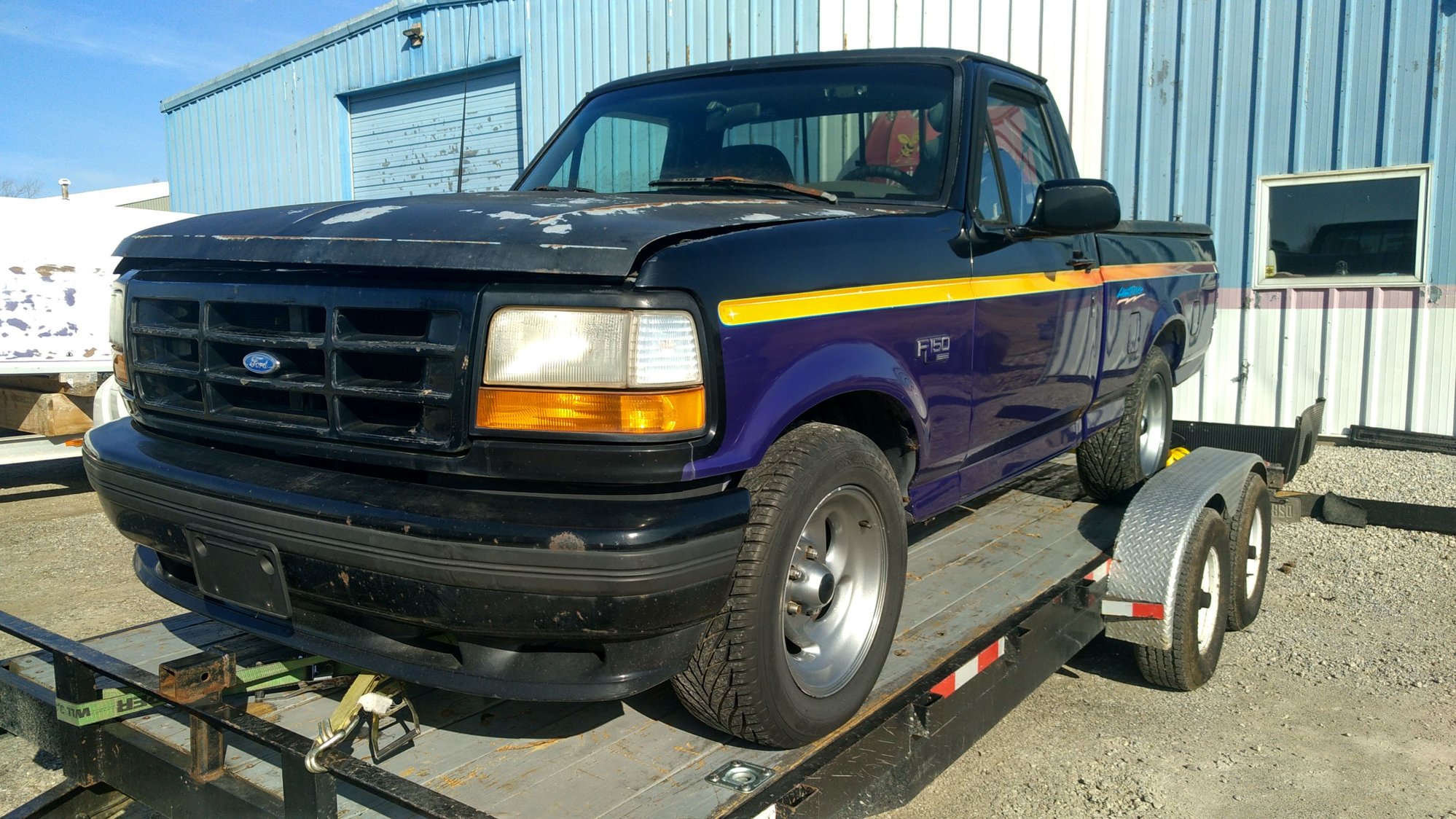

I just acquired a 93 Lightning from a customer that i would like to sort out and get running proper. Picked it up sight unseen with almost no history other then it has new red top injectors, new fuel tanks and pumps as well as fuel press reg. Guy i got it from had it at his auto shop and did misc work to it but never got to far because owner flaked out and did not keep up with bills on items done, my friend had no choice but to lean on it and take title. I picked it up in a trade deal and truth be told wanted it to do a Bronco Lightning (full size Broncs are my main thing). After getting it dropped of its far far to nice to take apart, its a bit weathered and has some crappy graphic treatment on the sides but very clean (maybe six or eight square inches of rust on entire truck. except for some surface stuff on hood and bumper the cab and bed are pretty clean, had a bedliner in from new that i just took out and bed floor is perfect. I would like to get it running proper but would consider swapping it for cash and a ratted out but complete gen one lightning in case any readers are interested. For now id like to sort out issues though
Current situation, at some point it appears to have had a fairly OEM looking speed density to mass air conversion done on it but other then seeing it has a MAF thats all i know of it. Knowing these were SD i assumed it was converted as it also has some other mods, Basani dual exh and a 4.10 gear to name a few. Truck will start and run rough with MAF un hooked and will not run with it hooked up or becomes very difficult to start. MAF has the numbers F50F-12B579-AA AFH80-01A SM28 if that helps and truck has maybe 70K miles on it.
My question is where can i find diagrams or info on doing the conversion to help me sort this out? Also any fox body mechanics near NW Ohio that come recommended? Thanks all . . . ohhh shes a cream puff lol

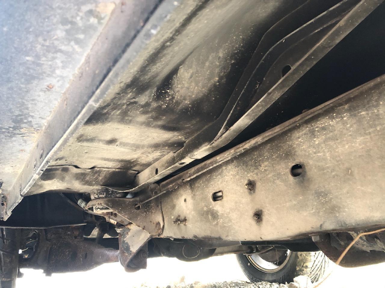

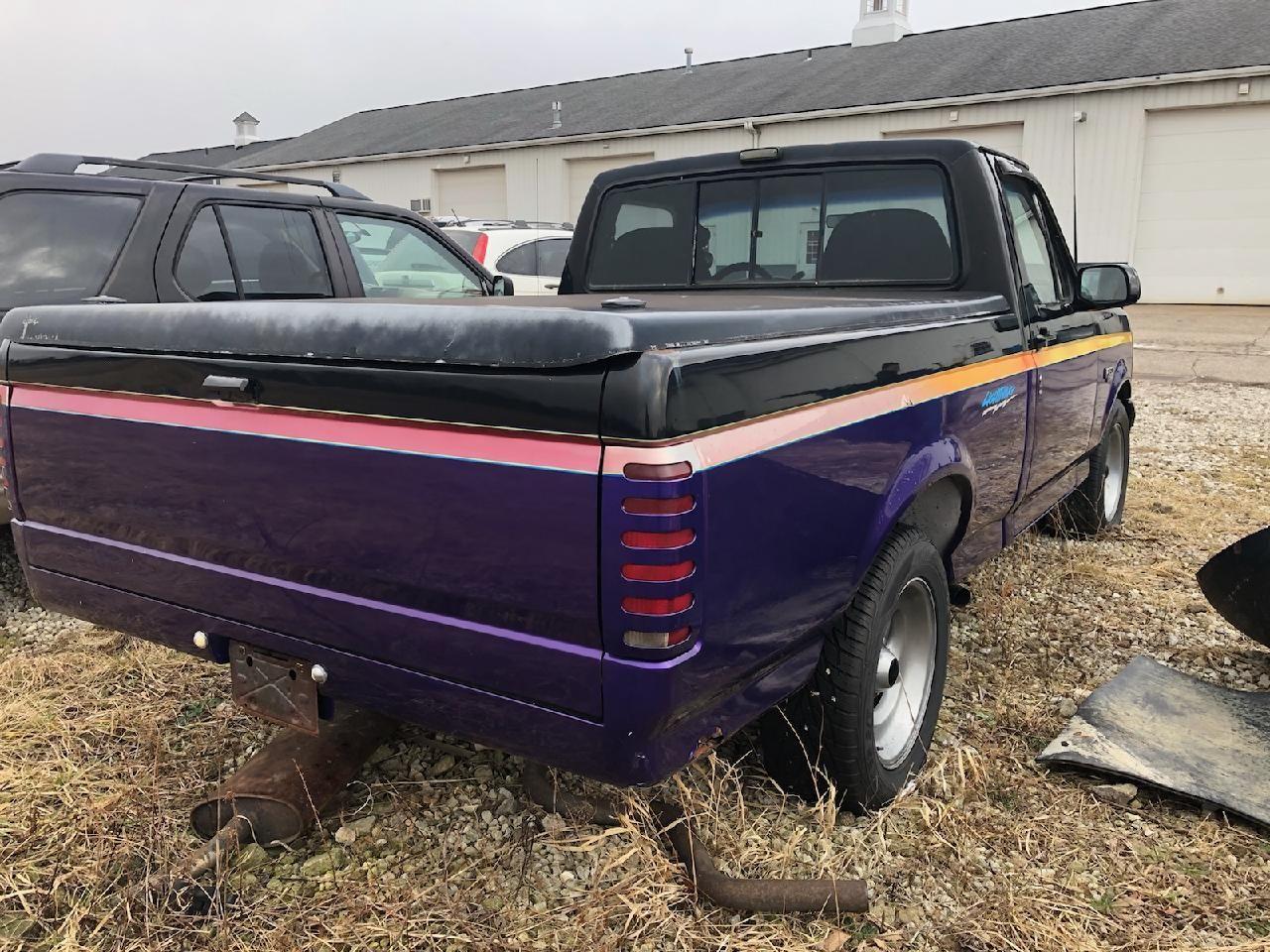

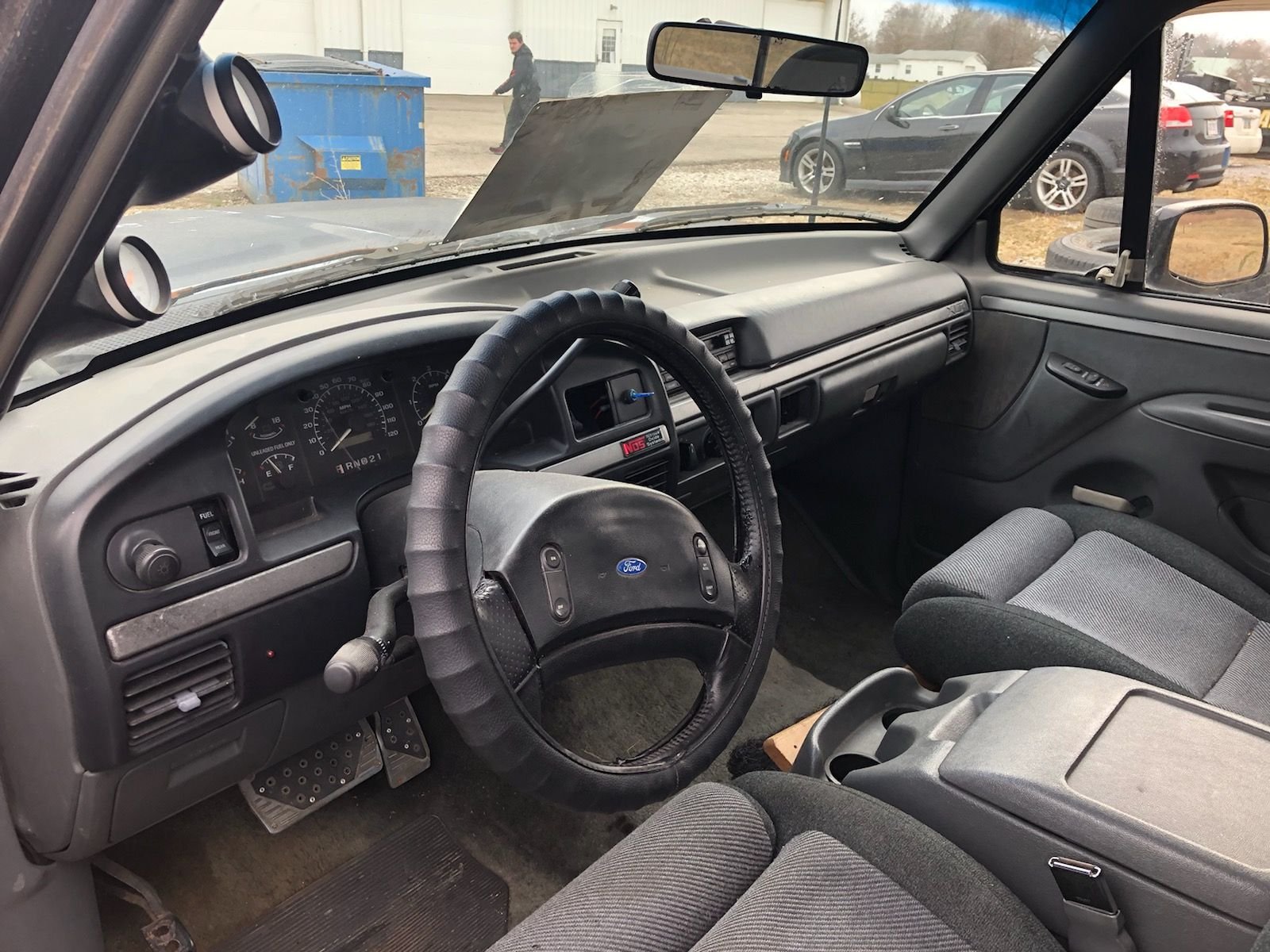

couple more pics for the heck of it, im pretty cheesed about finding this thing . . . or more accurately IT found me lol
Despite having had this hideous graphics treatment the body is in very good condition. Cab floors/rockers/mounts and stuff are near perfect and the bed has had a fiberglass cap and bedliner since new. I pulled the berlined the other day and the bed floor is near perfect with zero rust or dents and just a bunch of silicon tracked all over from when the put the liner in. Wheels are nice to, biggest bummer is the paint (i own a custom paint bodyshop) and the missing rear bumper. Interior is pretty good although a fresh carpet set is in the future but seats are free from stains or damage.

A couple of ways you can find the code on the ECU is to remove the drivers side kick panel and e-brake bracket to expose the rear of the ECU. Or remove the connector from the ECU, in the engine bay, under the cruise control servo, there is normally a tag on the ECU connector.
Nice find on the GEN 1! It'll be hard to find a factory tube bumper, but the rest of what you have can definitely be restored.

fortunately i have a high level of fab skills and if i can get some good pics/measurements for the bumper i can make a good copy. Never know may even find a Smittybuilt that is close, i remember they use to sell double tube bumpers.
