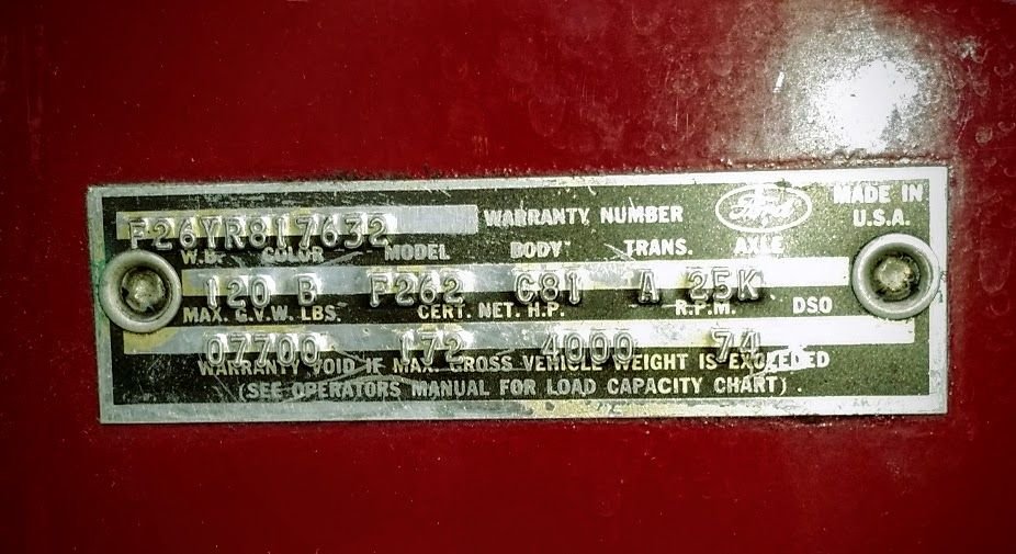

If you want post a pic of your warranty plate and I'll decode it. Seafoam Green was only used in 1951, 1953 and 1968. There was no Seafoam Blue, only Green - although it did look a bit bluish.
Oh, sure - I was just guessing, based on the OP's notes. It's some kind of light blue, shown in 2nd pic

That's Caribbean Turquoise - more of a green color than blue but is a nice color
Color Codes - Caribbean Turquoise Paint Cross-Reference (paintref.com)
F26 = F250-4x4
Y = 352 2V V8
R = San Jose, CA assembly plant
817632 = Assembled February 1966 - 1966 model year
120 = wheelbase in inches
B = Caribbean Turquoise
F262 = F250 4x4 7700 lbs GVWR
C81 - C = Medium green crush vinyl and medium green cody pattern woven plastic - 81 = Custom Cab
A = New Process 435 5NAT
25 = Dana 60 4.56:1 non-limited slip rear axle
K = Dana 44 4.55:1 locking front axle
7700 = Gross Vehicle Weight rating
172 = HP
4000 = @ RPM
74 = Seattle district sales office
