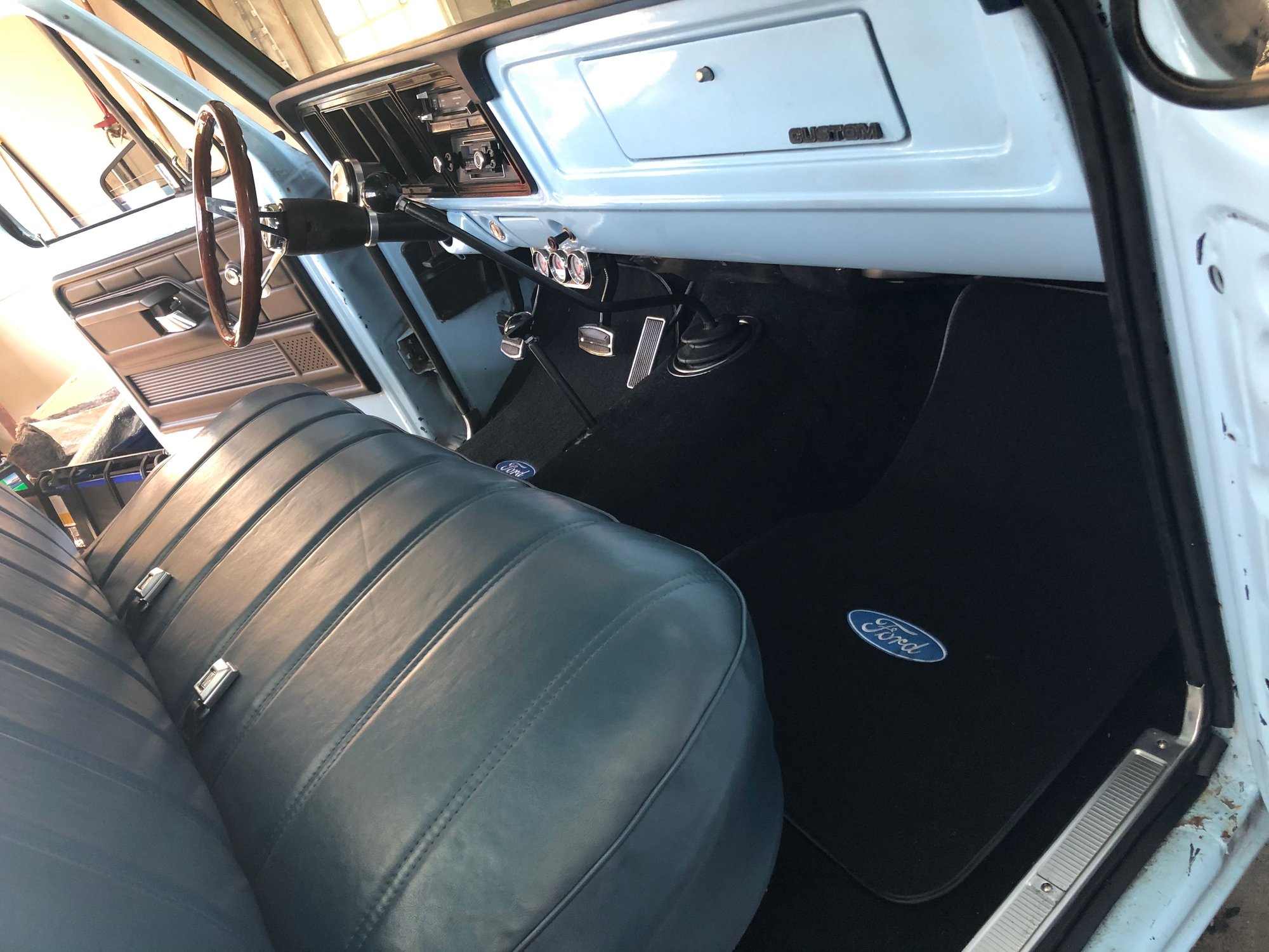

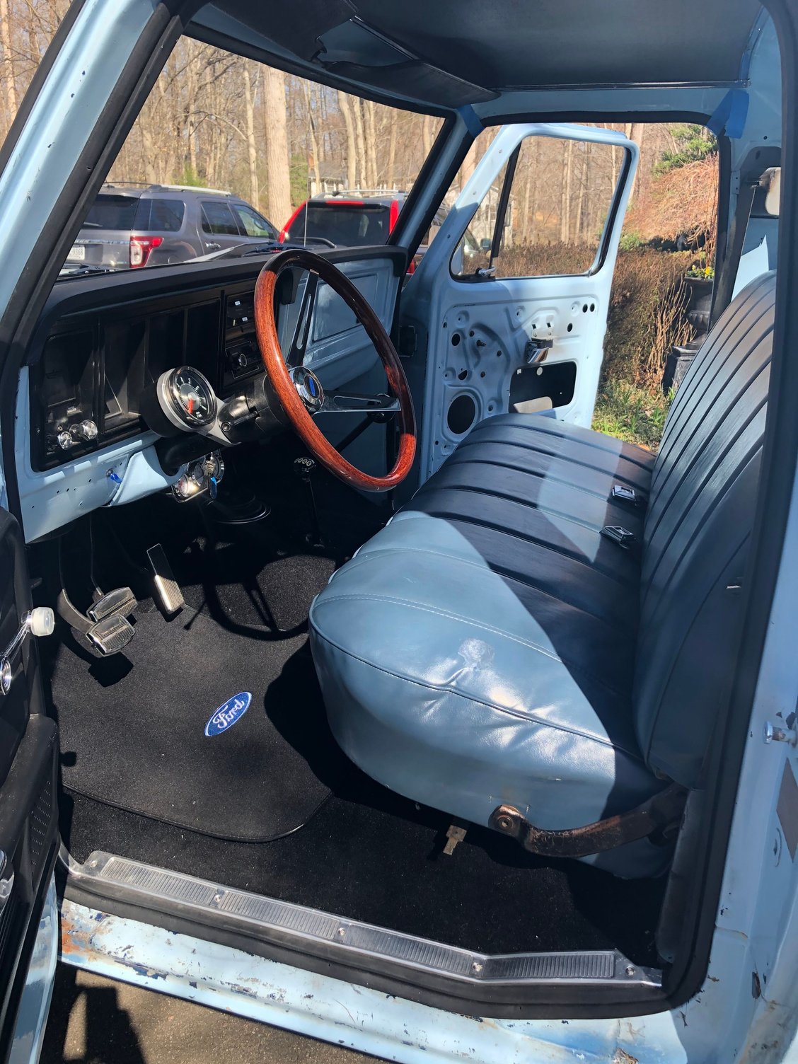

Thanks for everyone that have helped me and my son get our truck in better shape
have been working on the Interior and thought I would share some shots
really coming along
new windshield, rear window, insulation, Carpet, floor mats , rubber, boots, shift *****, steering wheel, tachometer, door panels. Next step seats and stereo

Wow, That looks beautiful. Very impressive. You guys are making a truck to be very proud of. Best of all, making forever father and son memories.

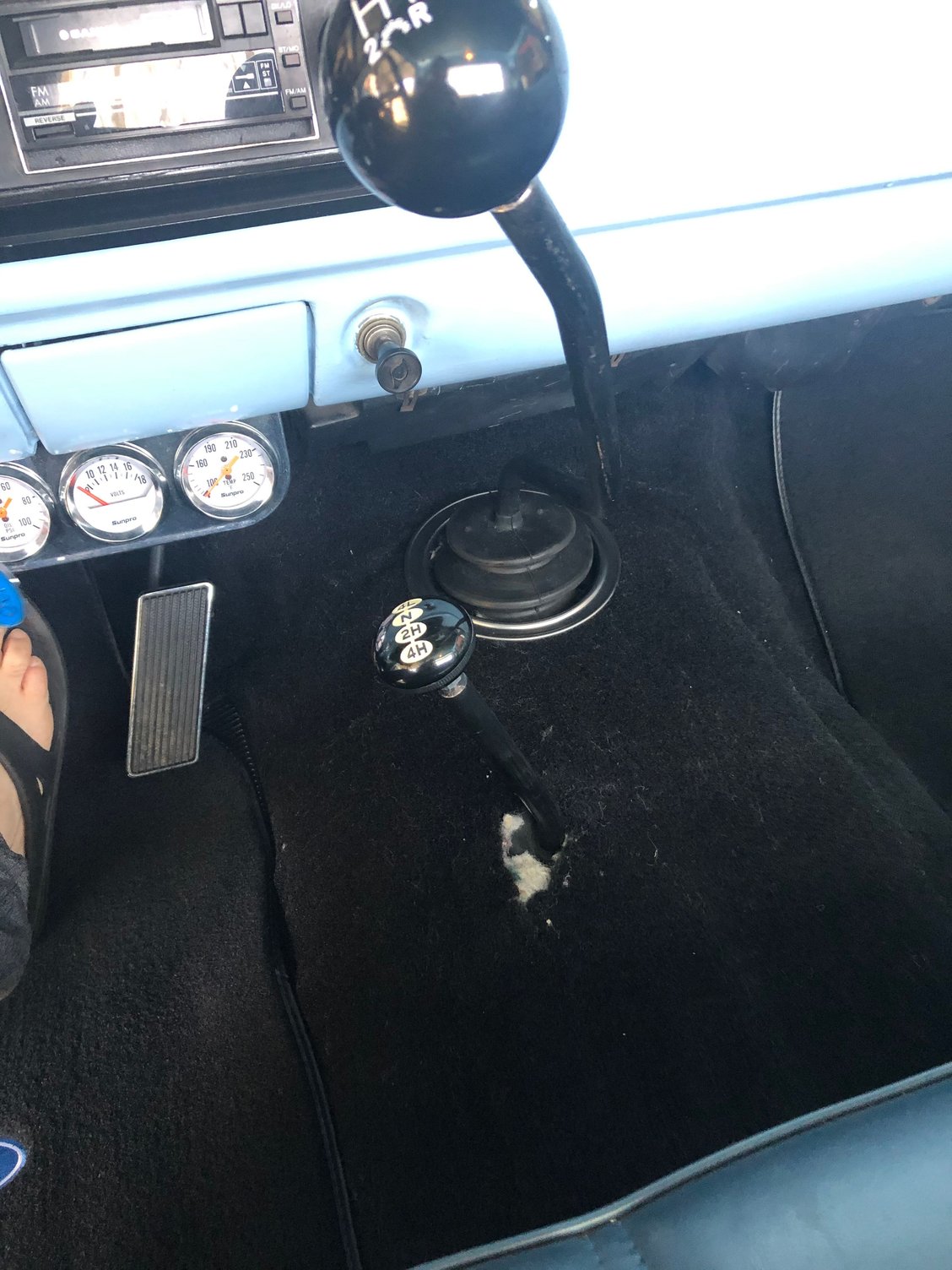

Looking good. You might think about putting the rubber shifter boots metal lip UNDER the carpet and that way the cab is sealed from splash up water. And then get the chrome trim rings for the shifters to cover the carpet edge. Yea...now I tell ya. Still looking good especially the chrome trim overlay on the pedals.
that’s a great idea
i haven’t screwed it all down yet and I have one of the two trim rings
i didn’t know what to do with them but now I do
thanks for the heads up! Was going to screw it all down today

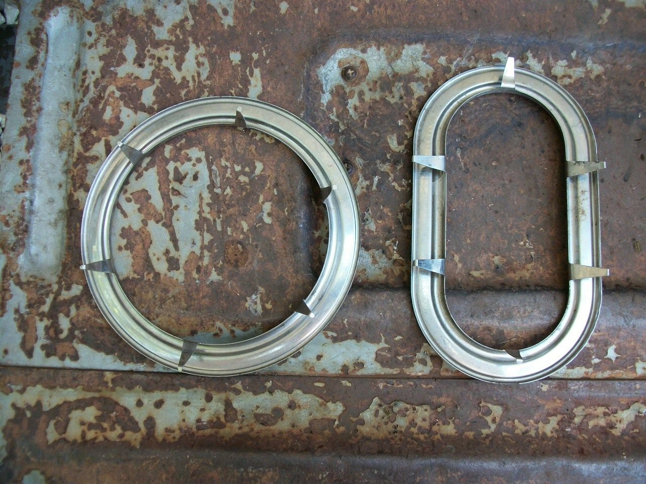

do you happen to know where to get the transfer case trim ring? I can’t seem to find them at my usual sources (LMC, Bronco Graveyard, etc)

I was not trying to be nit picky I just hate to see all your hard work get wet from a possible leak. I am sure someone on here has one (I am all out of stock of spares at the moment) or maybe ebay or Dennis Carpenter? Put a little RTV before you set the boot down to the cab floor, to be sure NO water gets thru. A idea of how it will look. OUCH https://www.ebay.com/i/154358635777?...DefaultOrganic

I am looking for a xfer case ring for you. That ebay price is crazy.

Maybe https://www.gpulsecom.com/index.php?...cts_id=393197\
Contact this guy maybe the trim ring BEHND the radio bezel is for sale?
https://www.ebay.com/itm/1973-1979-F...4AAOSw309gJAWK

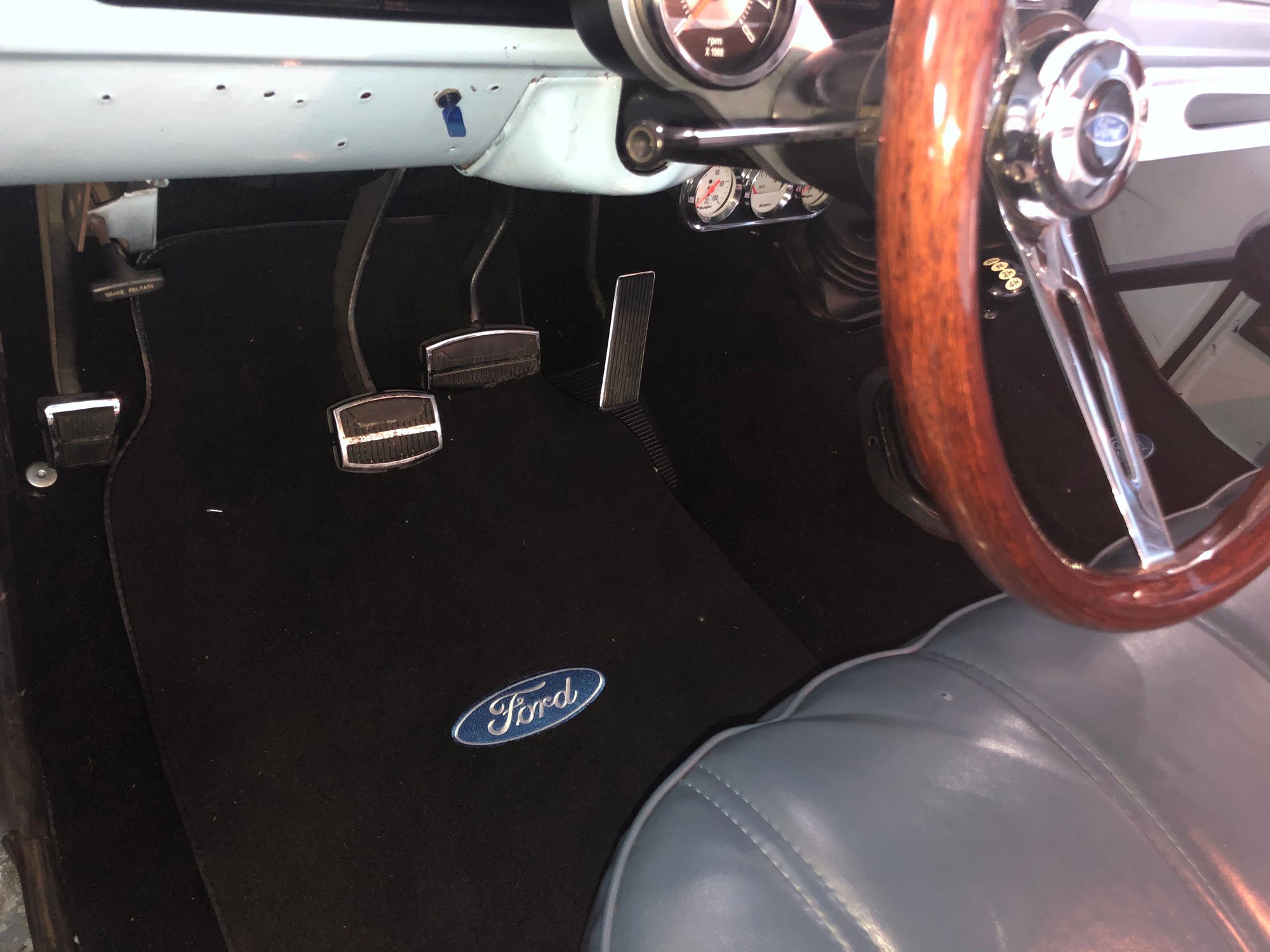

The interior is coming along (included a few pictures). Pulled the carpet backup, put the shifter boots down on the metal, then replaced the carpet. Put the trim bezel on the gear shift, but the 4WD bezel hasn’t come in yet - I sent some guy on the GPULSE website $50 on pay pal - hope it shows up. If not, no big deal.
Truck is now super quiet - put the LMC truck insulation and sound mat down, then carpet, then carpet floor mats. Have a little more to do on the gas tank (in cab) but I can hear the radio crystal clear now.
that was a great idea to use those trim bezels - thanks for the tip. Shifter bezel looks great and now it should be weather tight.

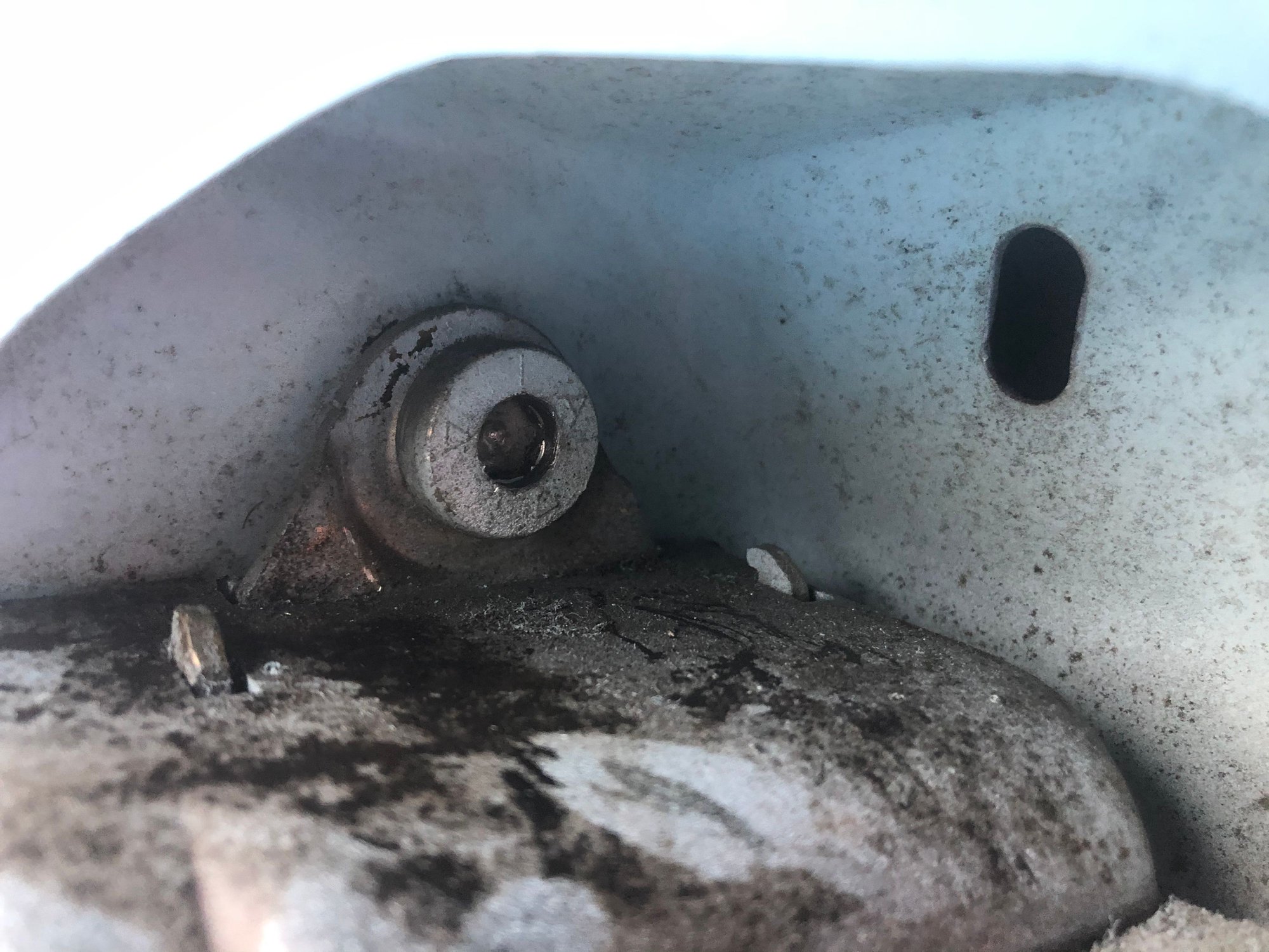

I have a NEW question - I have new seat belts, and striped the old bolt (see attached photo) and now I’m in a pickle. I bought an extractor, however, I can’t get a good bite because I haven’t been able to drill a good pilot hole - these bolts are hard. Any suggestions?
Striped shoulder harness seat belt bolt

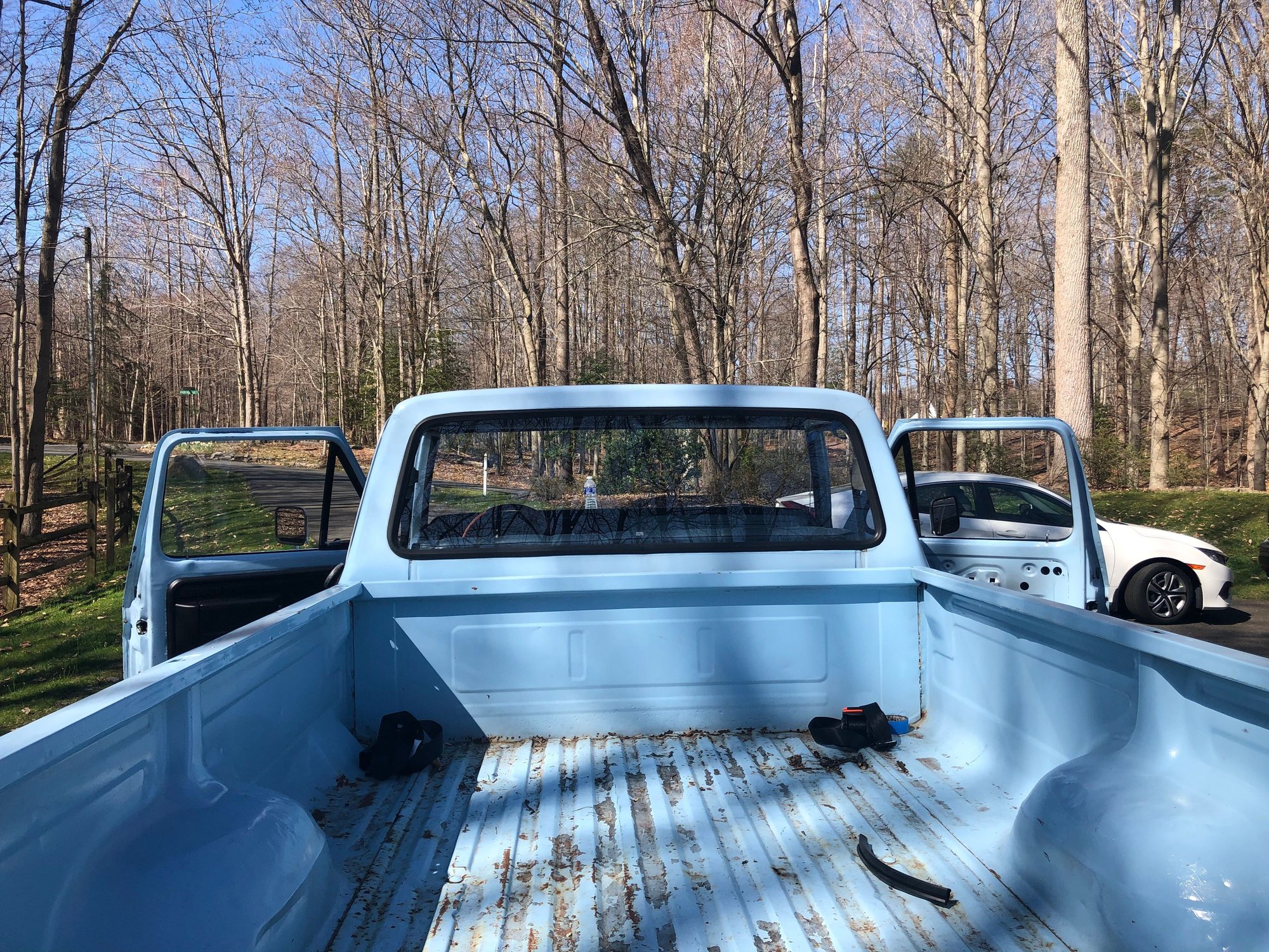

New rear window and windsheild - can see right through the truck now
Carpet down, insulation down (super quiet), trim down
