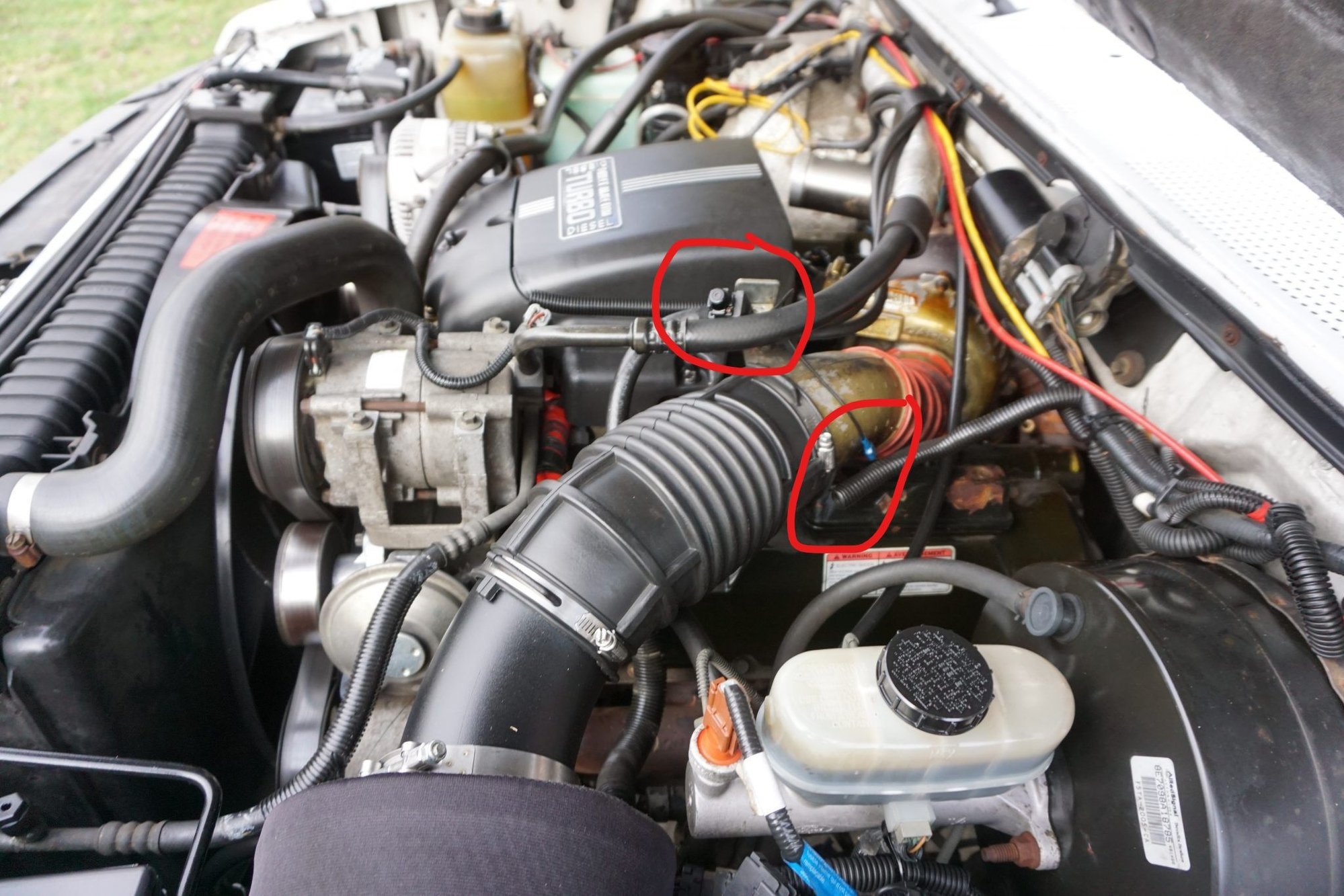

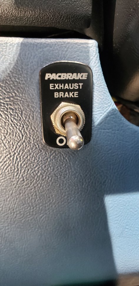

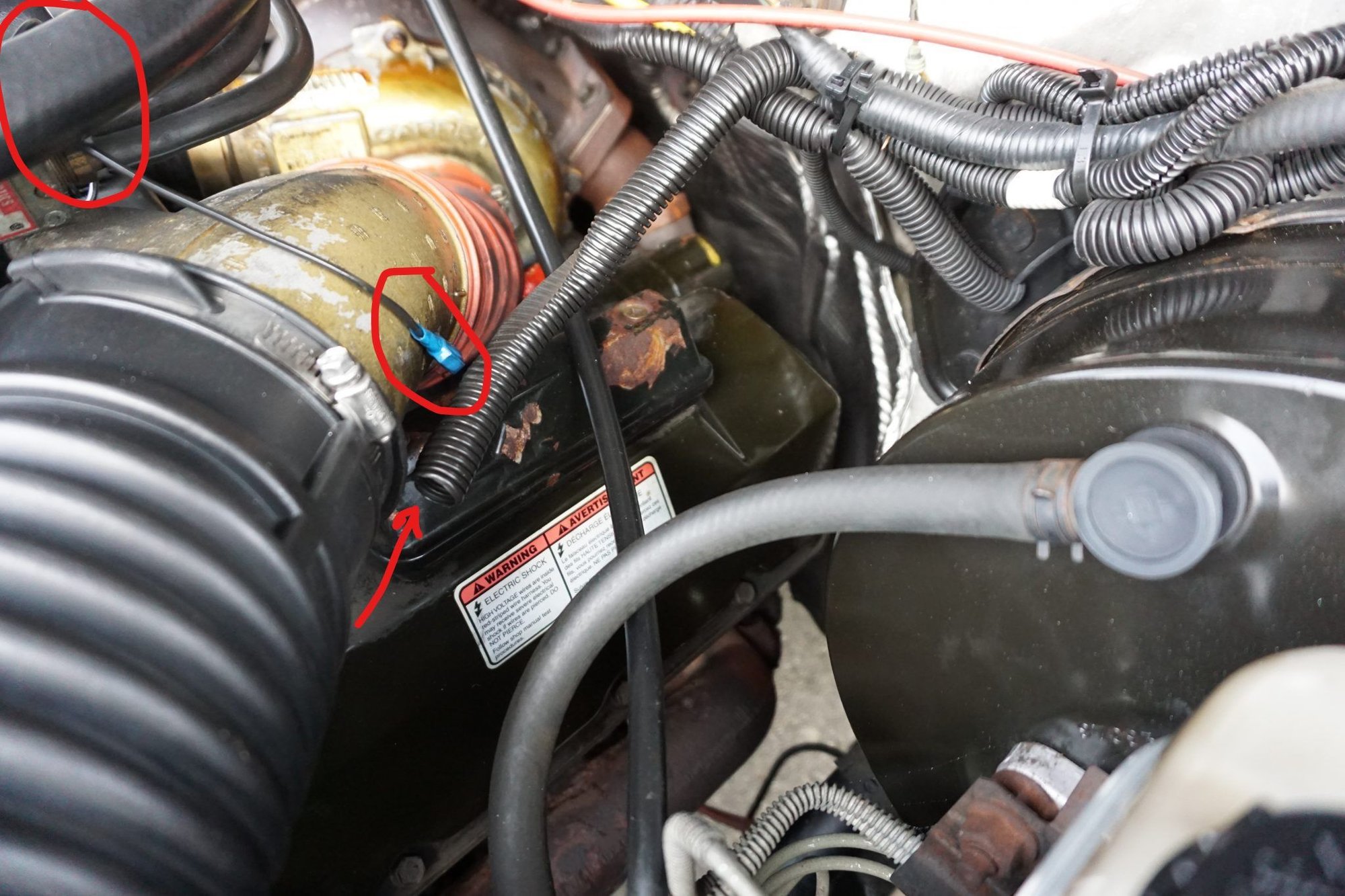

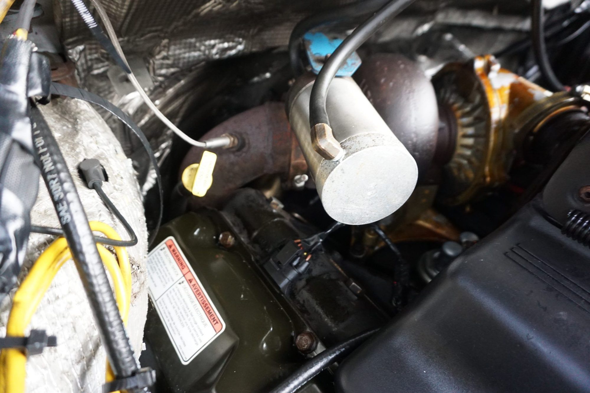

Re PacBrake, see attached photos and documentation. PacBrake tech said they EOL'd this vacuum-based product ~6 years ago, in favor of the compressed air system. I suspect this system was installed by the selling dealer in 1997. Electrical connection from dash switch is disconnected near actuator on turbo intake.

Top of downpipe by the brake looks round to me. Stock looks like an old East German transit bus ran it over.
I wonder if that kit included a full downpipe assembly to fit. One less thing for you to do...well could ceramic coat it like me!

For the PacBrake, is it me, or does it look like it is using the EPBV rather than an independent unit? If the PacBrake is using the EPBV, might consider ditching the PacBrake, overhaul the EPBV, and do the mod which turns the EPBV into an exhaust brake. But then again, if the PacBrake gutted the EPBV's actuation mechanisms, then will need to figure out how to move forward.
In the photos, noticed a probe in the downpipe's upper section. If this is for pyro, will need to consciously adjust for this location while monitoring EGTs. Put another way, preferable location for the probe is upstream of the turbine where surrounding metal has less of an effect on the temperature reading. Putting the probe downstream of the turbine tends to show delayed temperature effects. Most people put one probe in an exhaust manifold.
Toward the mental adjustment of placing a pyro probe downstream of the turbine, a crude analogy is a tsunami wave. When laying into the throttle and watching the EGT start to rise, know that things are already hotter upstream of the turbine as the metals are currently in an absorption phase and the crest of the heat wave is still working its way through the plumbing. Reverse for letting off of the throttle as the probe will read temperatures from the metals shedding heat as part of the EGT.
Old Mar 21, 2021 | 11:30 AM

An exhaust brake (*not* a Jake brake which is a completely different animal) works by way of a flap type valve (almost the size of the pipe's inside diameter) in the exhaust stream. When engaged, the flap turns perpendicular to the exhaust flow and causes a restriction in the same way as placing your thumb over the end of a garden hose (pressurizes upstream of the restriction). This pressurization makes it more difficult for the motor to expel exhaust during the exhaust stroke.
The EPBV works the same (and has the same physical design) as an exhaust brake, but its purpose is to warm the motor during a fast idle while cold and not act as an exhaust brake.
Bringing this full circle, the PacBrake looks like it is mounted on the EPBV as opposed to an independent unit. As far as I know, all is good with this design and just need to figure how to get it working again.
Regarding commentary in Kahn's thread about emissions tests, an exhaust brake should not have any bearing on the test as it does not effect emissions (unless for some odd reason it engages during the test). Same for the pyro probe.
