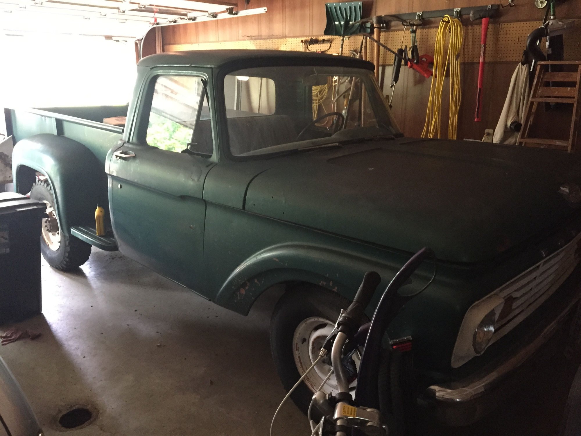

First this is my fathers truck, he bought it new in a small town in western Colorado. I was driving when it rolled over 100,000 miles and then personally have put 300,000 miles on it driving it for my dads construction company we were putting in power lines and sub stations. He gave the truck to my sister when he retired. She ended up parking it a friends farm in Nebraska where it sat for 12 years and called me up 6 years ago and asked if I wanted it. Easy to say yes. I started to work on it and the realization there was a big difference between the hot rod truck I dreamed about since I was 14 and what I wanted and can afford.
I decided the package still works I’ve got to many miles in it to not understand that, the 292 y block is a torquey motor, I pulled monarch pass in Colorado (11,300 ft) every trip out of my hometown lugging it in 4th gear at 48 mph, some of that pass has 7% grade. I’m giving up on the hot rod and replacing it with reclaiming a good solid truck. Honestly I don’t think people believe me when I tell stories about the things I’ve done in it. They are strong enough to spin on the rear axle, especially when you put 2 tons of logs for firewood in the back, just gotta keep her under 30 to keep the front tires on the ground
