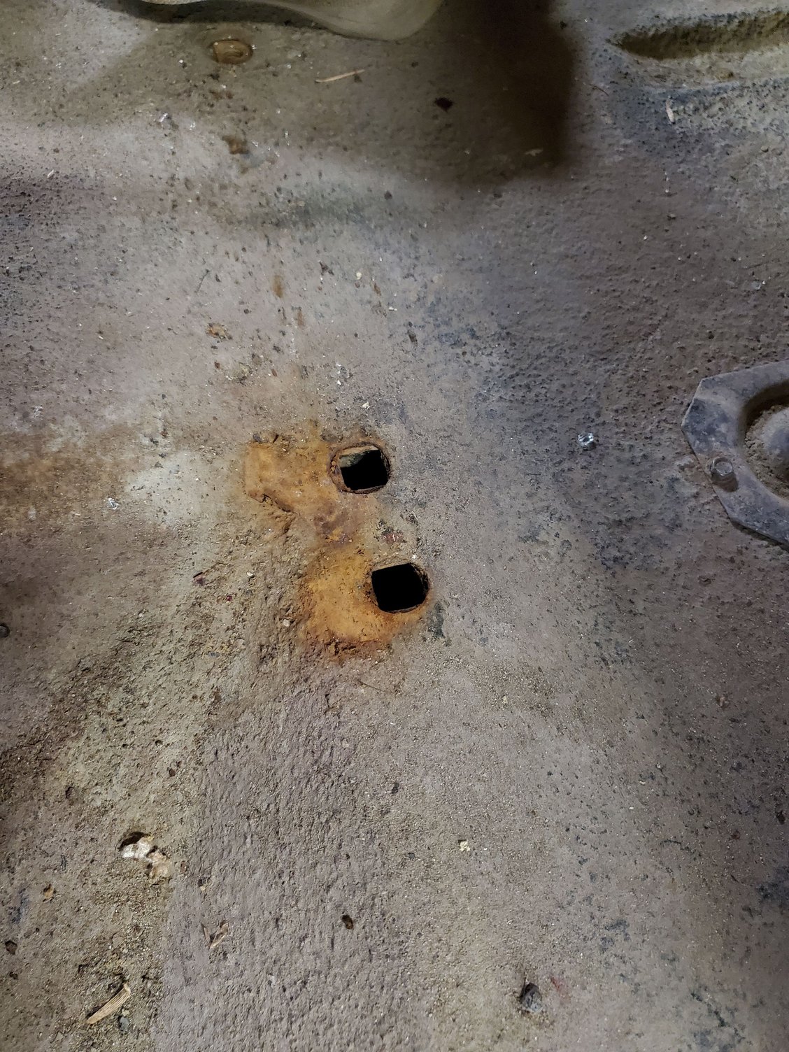

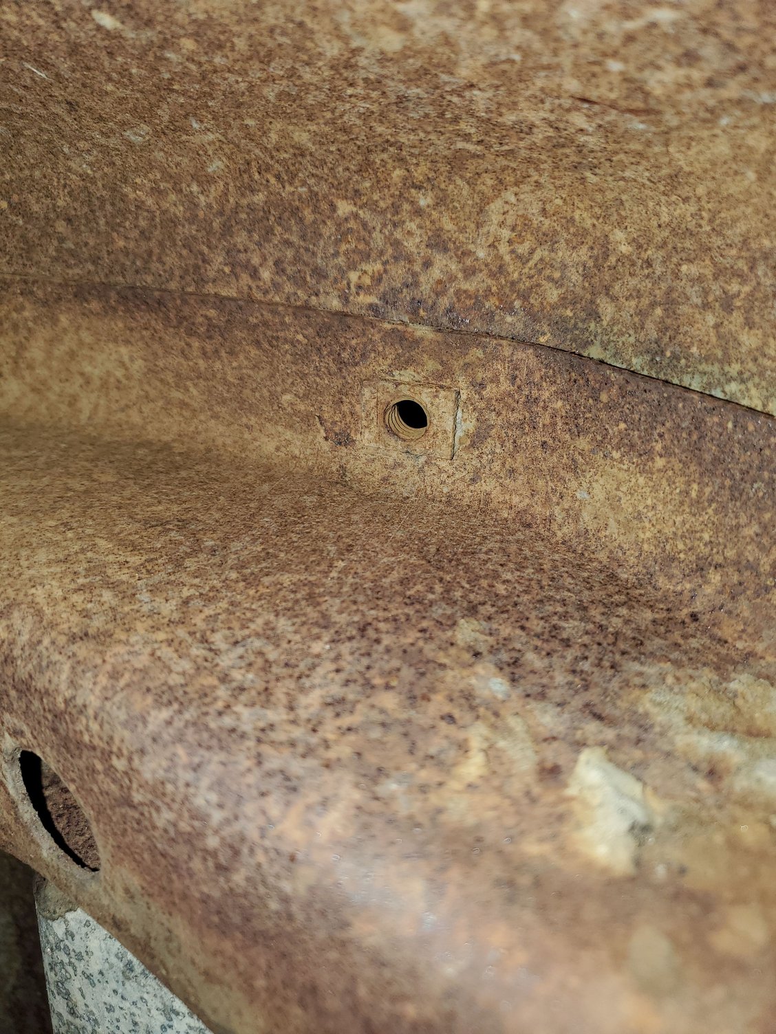

I am restoring a 79 bronco and a couple of the square nuts in the floor that the seat bolts to are missing. Does anyone know where to get these or what they are called? I'd just throw a nut on the backside but it's covered by a crossmemeber with a very small access hole that's offset.

You might be able to used a caged nut, they are available from AMK Products in Winchester, VA.
https://www.amkproducts.com/bulk-fas...forlookup=7125
