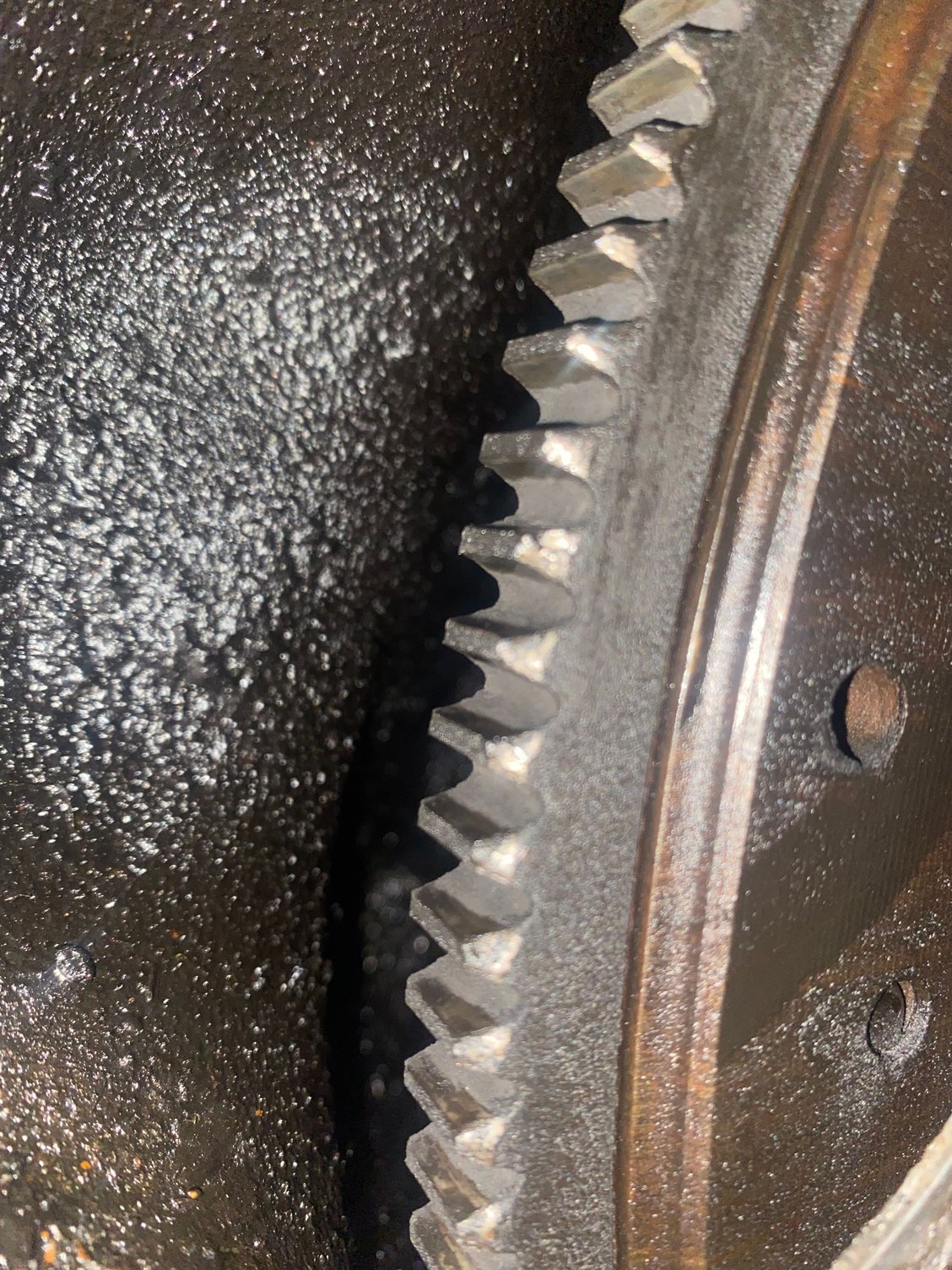

Am I able to inspect the the flywheel and clutch through the hole my starter would mount up to in my 1981 F250 with the 400 and a speed.

You can see the teeth of the flywheel if you turn the engine by hand. But not much of the clutch.

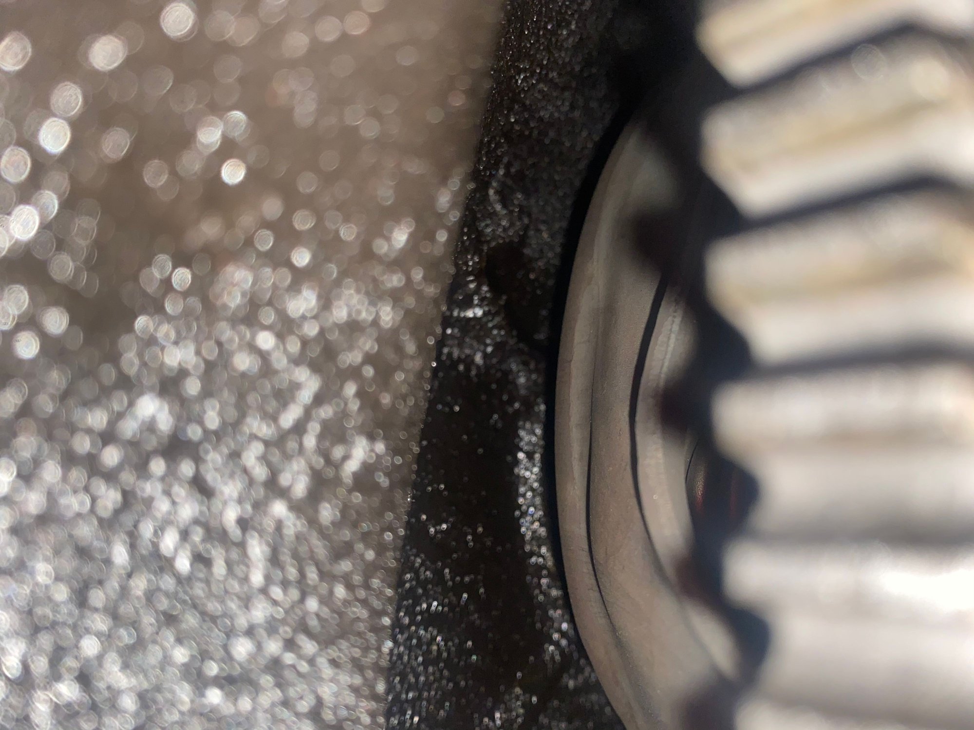

These are the pics I got but how would I be able to view more of the clutch I was mostly looking for metal chunks and savings but I’d still like to see the truck more.

Put a index mark on that spot and rotate the crankshaft by hand and check each area you can see through that hole.
Some vehicles have an inspection cover that can be removed behind the oil pan on the front of the bellhousing.

I looked your truck up, it looks like the 351m/400 bellhousings are all enclosed. Most of the others have a nice big sheetmetal pan on the bottom you can take off and look up in there. But apparently you have one of the ones that does not have the pan. Sometimes you just can't see certain things. If it performs ok, then go with it.

I have never seen shavings unless the clutch disc or PP came apart.
on the flywheel once apart look for bluing and heat cracks.

If the clutch has grooves in the facing and the grooves are no longer present on the edge of the clutch it's time to replace. And the grooves are still present on yours.
And really unless the clutch is slipping under normal use there is no need to replace it. If it slips replace it. Clutches typically do not just fail and give lots of warning they are on their way out.
