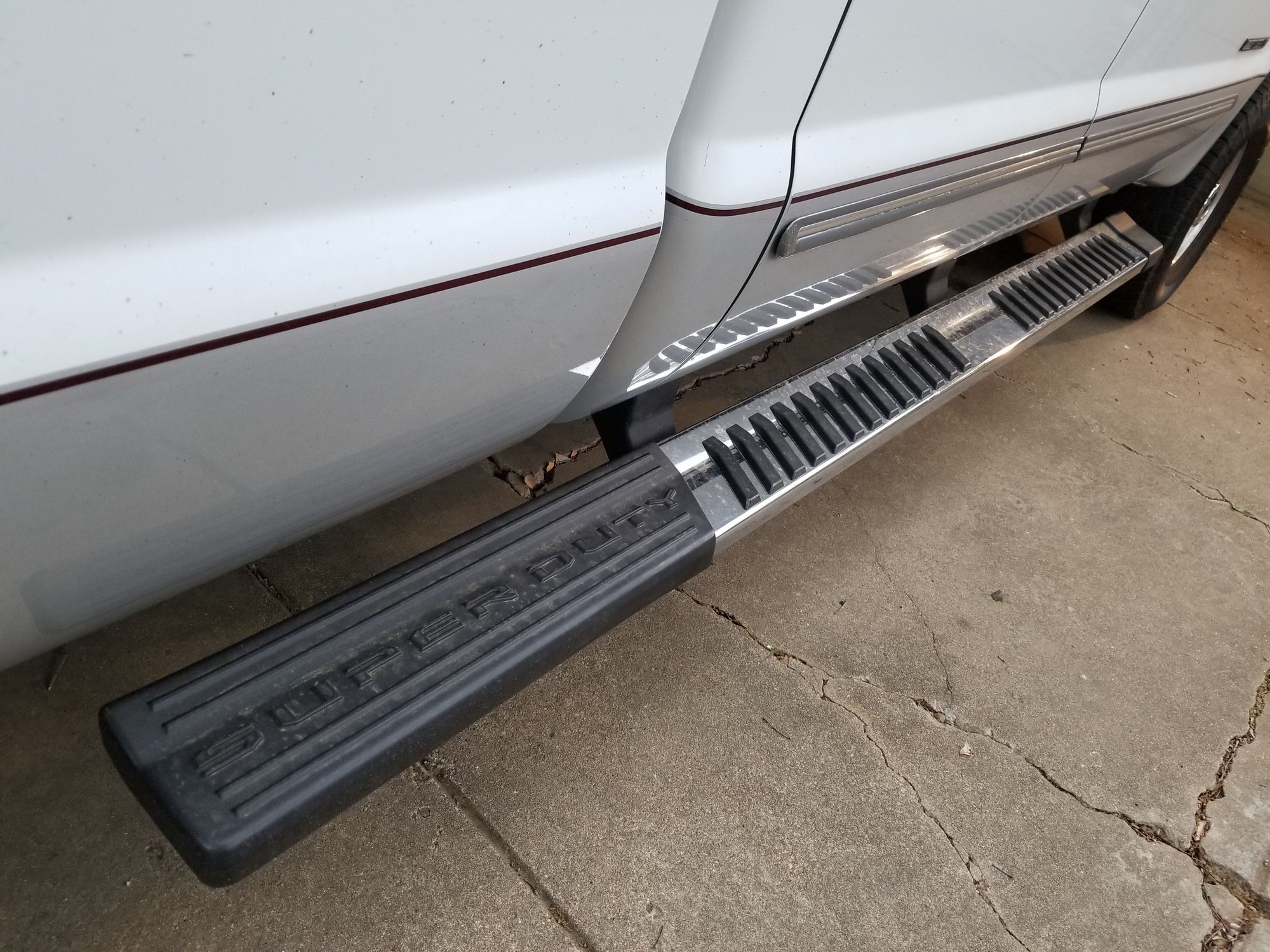

Well, I finished installing a factory set of extended side steps off a 2020 Superduty on my 2000 F350 today...purdy happy with them!

Looks good. Any pictures of how the brackets went on the body?

The brackets are factory 2016 and earlier, these are the later units that have the plastic front covers so you don't see the metal brackets and bottom bolt ends. The truck already has the holes and/or slots for the clip nuts to be inserted...though the front only has 3, the other 2 do have 4 to match to the metal mounting brackets. My old stainless nerf bars utilized M8x1.25 clip nuts and bolts, but I decided to buy new ones and went with a 5/16"x18tpi given they are more common. I found O'Riley Auto had a 25 pack of that size clip nuts for about $8, then I went to Home Depot and picked up the bolts, flat washers, and lock washers for about $12. I can snap a pic of it later today, but it's really straight forward.
I was thinking these steps would hang down lower than the nerf bars I've had on the truck for 20+ years, but they don't. In fact, the actual stepping surface is a little lower given the thickness of the step...plus it is a much wider stepping surface that my wife and kiddos much appreciate! I've had a couple of encounters with those nerf bars in the past...mainly at the boat ramp...where my foot slipped off the step surface and almost busted it. These are going to work out much better for that...not to mention I've always wanted that extension to get into my tool box. Not a bad investment for $225!

I dig this look and i am doing the same myself! How did you mount the brackets to the boards? It appears the holes don’t line up, I’m thinking of drilling and using nut insert rivets…. Do you think there is a need to reinforce the back portion sense the back support bracket won’t work?

That is correct for 99-16. However, these style steps are for 17-21 and the brackets are different. You still need to match up the truck configuration but You also have to use the older bracket with the new running board. They didn’t make the long wheel-wheel running board with the bed step until 17 unfortunately but it looks sharp when you retro fit it. I had ones off a 10 on my 02 prior but want the bed step on the new ones now
