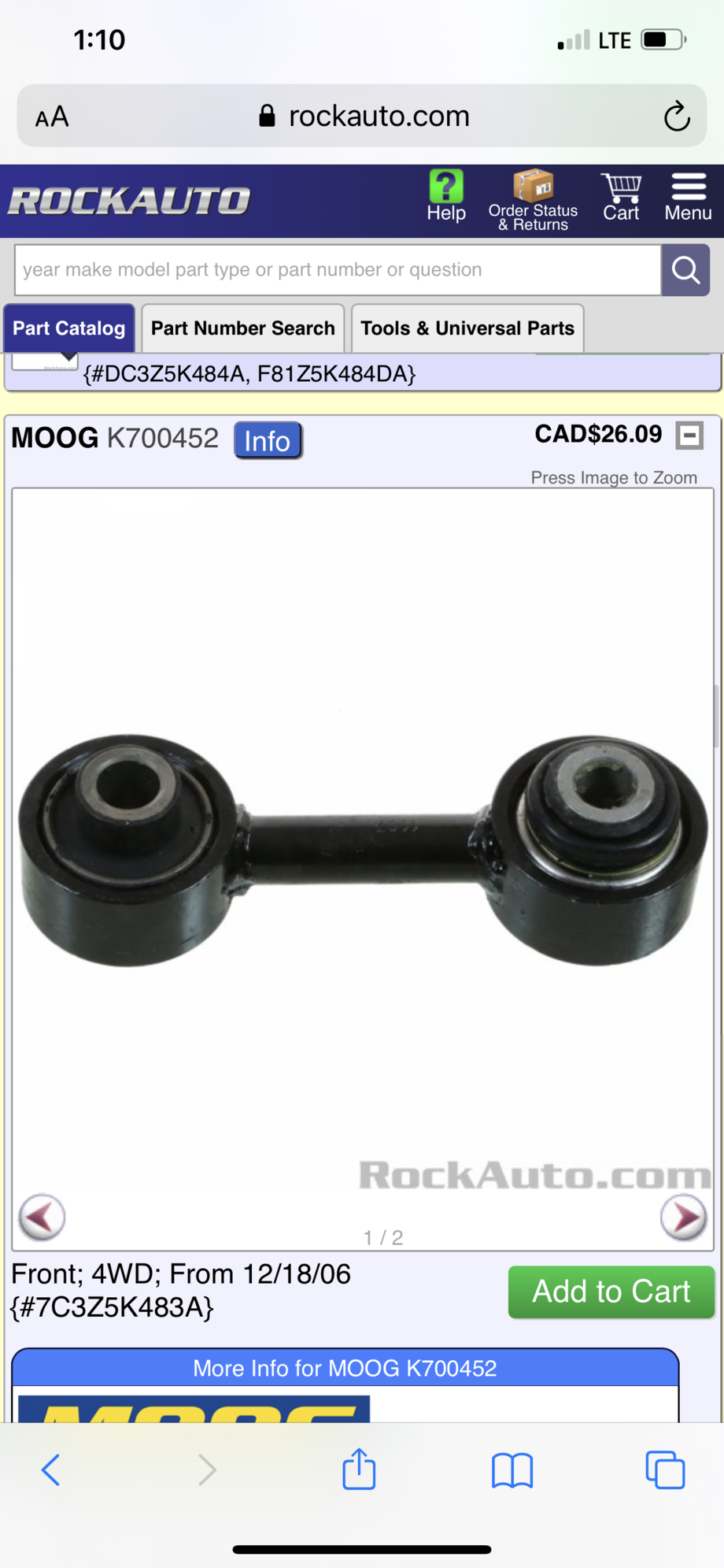

I think the year break is more a body style change than axle change, I know a few things that changed over the years.
First is the sway bar link, 05, 06 and maybe 07 had the eye and stud, then it changed to eye and eye.

It would make sense that it would be a change from the knuckle out since Dana has the same BOM for 07 and 08. I would think that a change from the knuckle out would mean that it was parts that Ford added to the axle assembly (or provided to Dana during assembly), but the axle housing built by Dana is the same.
You mention the hole in the bottom of the knuckle. Your photo from Rock Auto refers to a 2006. But it does refer to the wide frame, which I think may mean dually??

According to Rock Auto the two use the same caliper as well. The sway bar is definitely different, but the axle itself is the same. So far, the only difference I can find is the brake hoses.
