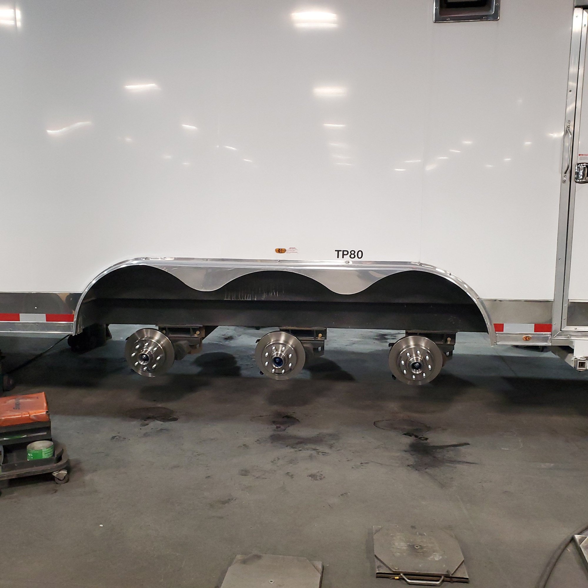

So I have 20,000 miles and time for wheel bearing repack
instead I dissided to replace with disk brakes . All new everything bearing are bigger, and can now look at inner seal
fron under trailer.

I went with a kit from Preformace Brake. Every thing you need including hold down clips for the lines, all you will need to buy is grease & a couple quarts brake fluid. I used about a 1.5 quarts with bleeding and carry the extra 1/2 in my truck tool box. Great to work with, I had a couple questions and gave them a call during the install. They were able to answer while I talked to them. My biggest question was do all the calipers have to face the same way, no. As you can see in the picture one each way, both side match. I went from 9.5-10 on the gain and hoped I could stop a couple times. I now run 6 and i know I can stop, nigh and day differance. Kits about 2K and installers get about 1k.
Questions PM me and I can try and answer all basic mechanics, worst part was were to mount the pump.

Kodiak disk brakes are what I used . My axle are dexter 6,000 lbs. So in order to install had to use bigger bearing that fit
the new hubs and also fit axle. Easy to do. One of the things
I like is being able to look at the inner seals,and all Timken
Wheel bearing
