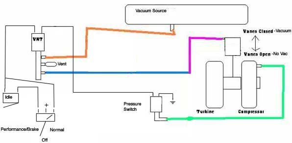

I think I made mention of using DRV101 in the past, I have used that method to control the E4OD in a manual mode as it can read a TPS and it can control a Variable Vacuum Valve such as those proportional valves that can control an EGR valve for the C6 Transmission to run the modulator. SO I think it could be used on some VGT turbos that use Vacuum control.
the simple method is this
HOWEVER the above does not consider Partial opening or closing, where monitoring TPS would and it doesn't watch a changing boost pressure either that might be handy. BUT down and dirty it will work. At least for turbos controlled by Vacuum.......
there are some that use a Stepper Motor to control where vanes are positioned this type could be better controlled using Arduino, you could have various sensors to monitor performance.
Some use Oil and I haven't really looked into that style as it seems to get a bit more complex.
Since I haven't played with one, I'm just not sure what Parameters you really want...but I totally understand the aspects of how one could control it.
