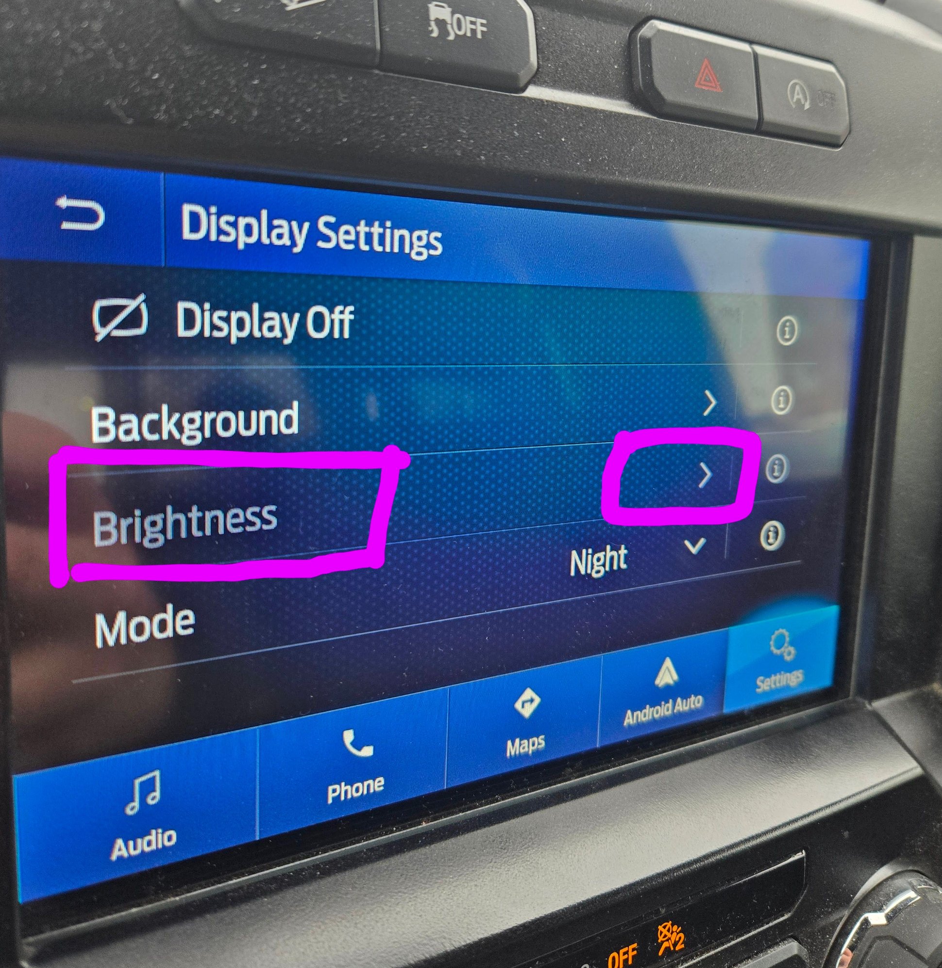

Back to the screen, I need to figure this out. I'm the OP in this thread and nothing has changed. Was out last night, and while I can dim the cluster with the pysical buttons on the left of the steering wheel, the screen, even in night mode, is far too bright and the birghtness adjustment in the settings is greyed out. I CAN turn the screen off in those settings, which works, but is pretty annoying. Anyone ever figure this out?

What software version of sync do you have? Sync 3 version x.x build xxxx

I have:
Sync 3, Software Version: 3.4
Build 23188_PRODUCT
Software is up-to-date
24-02-2025
The items in the pink boxes are greyed out and not functional.

Try pulling the fuse for the infotainment. It may just need a good old fashioned power down reset.

I can do that. I've replaced the vehicle battery in the time since I first noticed this issue and today, but that's worth a shot I guess.

My guess, you have buggered up settings and I would do a hard 'reset' of the apim. (I think it's press volume and >>> at the same time) It won't revert to older software, it will wipe all settings and put them to factory defaults. You need to reconnect to FordPass and redo your presets. I had to do a hard reset on my 2020 a few months back, fixed my issue (carplay) and was not difficult to reconnect to FordPass.

So, very interesting news. I did the "fuse pull" and that didn't do anything. However, I did the reset (Seek Right and Power buttong for 5 seconds, and that DID fix it, the brightnesss adjustment worked afterward in both day and night modes. I had to reset the clock, but the preset radio stations were still there.
BUT BUT BUT BUT!!!!, less than half an hour later, it was back to the old way, at full brightness and brightness adjustment inoperative. I cannot for the life of me think why this can be. I may do a full factor reset next, but figured I'm so slow with updates that I'd better type this out while I was thinking of it.

Good luck, and sadly, your apim might be going bad? If this is the worse case, just 'window tint' the screen
