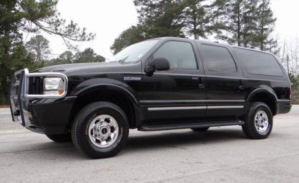

1st time Excursion Owner
2003 Ford Excursion
6.8L V10 4WD 3.73
272k miles
I’ve been looking for a couple months, and finally found this one 4 hours away. This is the setup I wanted, and it has been hard to find. It has some issues, but I’m used to that. I have a 2003 Expedition and 1983 CJ7. And rarely have enough money to pay someone else to fix things.
We bought a 2004 Jayco JayFlight 31BHS TT last year, & needed to upgrade to a heavy duty TV. After researching, much of which came from info on this site, I decided to get the king of the SUVs! I wanted the biggest SUV with the best towing capacity & weight ratings. We are a family of 6, plus a golden doodle (all girls, save me) [read “save” as except or as rescue ], and all the things.
Repairs/Maintenance/Upgrades
Planning to do now:
Oil & Oil Filter Change (Undecided Brand & Weight & Type)
Power Stop Rotors
Power Stop or Centric Performance Pads
K&N Performance Cold Air Intake
Hellwig Front & Rear Sway Bars
Backup Camera (Undecided Brand & Type)
Touchscreen Stereo with Apple Car Play (Undecided Brand & Model)
Brake Controller (Undecided unit)
Deal with some rust issues
Was planning to do now, but not sure:
Bilstein Shocks (the shocks on it now ride pretty well, but I don’t know what they are or if the Bilsteins would be that much better)
Bosch Iridium Spark Plugs
Ignition Coils (Undecided Brand & Model, engine running well now & coils look fairly new so I thought about waiting on doing those and the plugs)
I’m not sure what kind of shocks these are
Want to do, but may have to wait:
5 Star Tuner (Undecided which unit)
Service the Differentials
Tires are Michelin Defender LTS M/X E rated. In great condition. Front 2 look new and rear have lots of tread. Good there. Also, 4WD low and high work great.
Not sure if I should have the transmission serviced or not. I don’t have any detailed service records on the vehicle, so I’m not sure what or if anything has been done to service the transmission.
I drove my Expedition 4 hours from Alabama to South Carolina towing a car hauler to go look at the Excursion yesterday. Got it for $7,000 from a Ford dealership. Immediately put it to work. Took the car hauler off the Expedition, put the hauler on the Excursion and hauled the Expedition home.
Engine ran great. Gauges stayed in normal ranges, transmission shifted smoothly. I’m really enjoying it so far. I’m a big guy (6’5” 295), and it is nice to have a vehicle this size. I’m bracing myself for things to go wrong since it is at 272k miles. It seems to have been serviced really well though. Carfax showed it was a rental for a chunk of its life. Once I finalize the upgrades/repairs/maintenance that I’m going to do now, I may also have it aligned. Then I plan to readjust my WD hitch for this vehicle, and I should be good to go. Looking forward to the adventure of owning an Excursion, and the adventures it will take our family on. Thanks, everyone, for the resource of this site.
I’m open to suggestions for the items I’ve mentioned above for which I’m undecided on brand/type/model/etc., so feel free to let me know your recommendation and why. Thanks.
