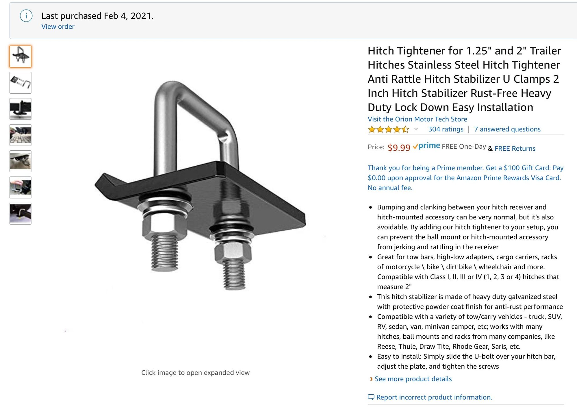

I added this to mine. Cut the noise out!

I just researched this and it seems everyone's favorite on the different forums is the Curt reducer with the little "ears" to act as a depth stop. Most said they liked it much better than Ford's OEM reducer. Ordered on from Amazon, less than $30.
And +1 on the rattle reducer plate posted above, those are gold.

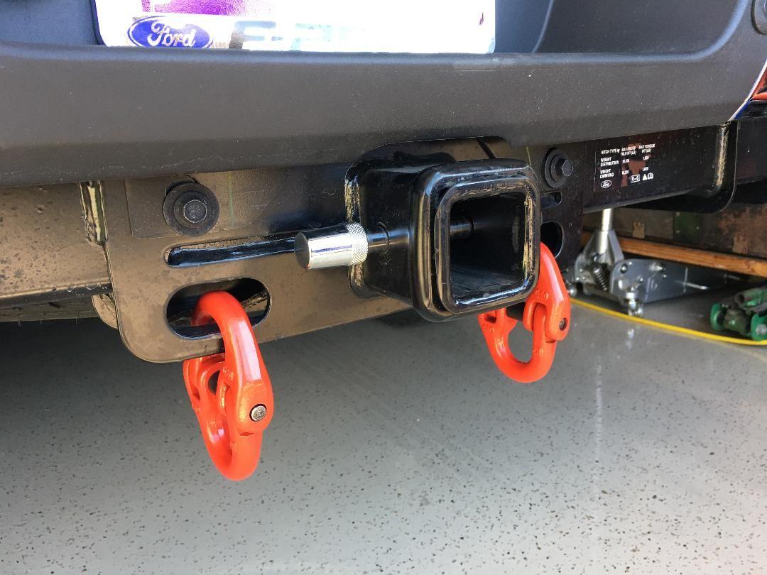

Whatever the adapter, if you still have more movement than you'd like, you might cut some shims out of scrap aluminum like I had laying around, lube a bit and tap the assembly into the receiver. Works great. Would have ordered the Ford unit but I needed a solution NOW and the Curt unit was in stock locally.
