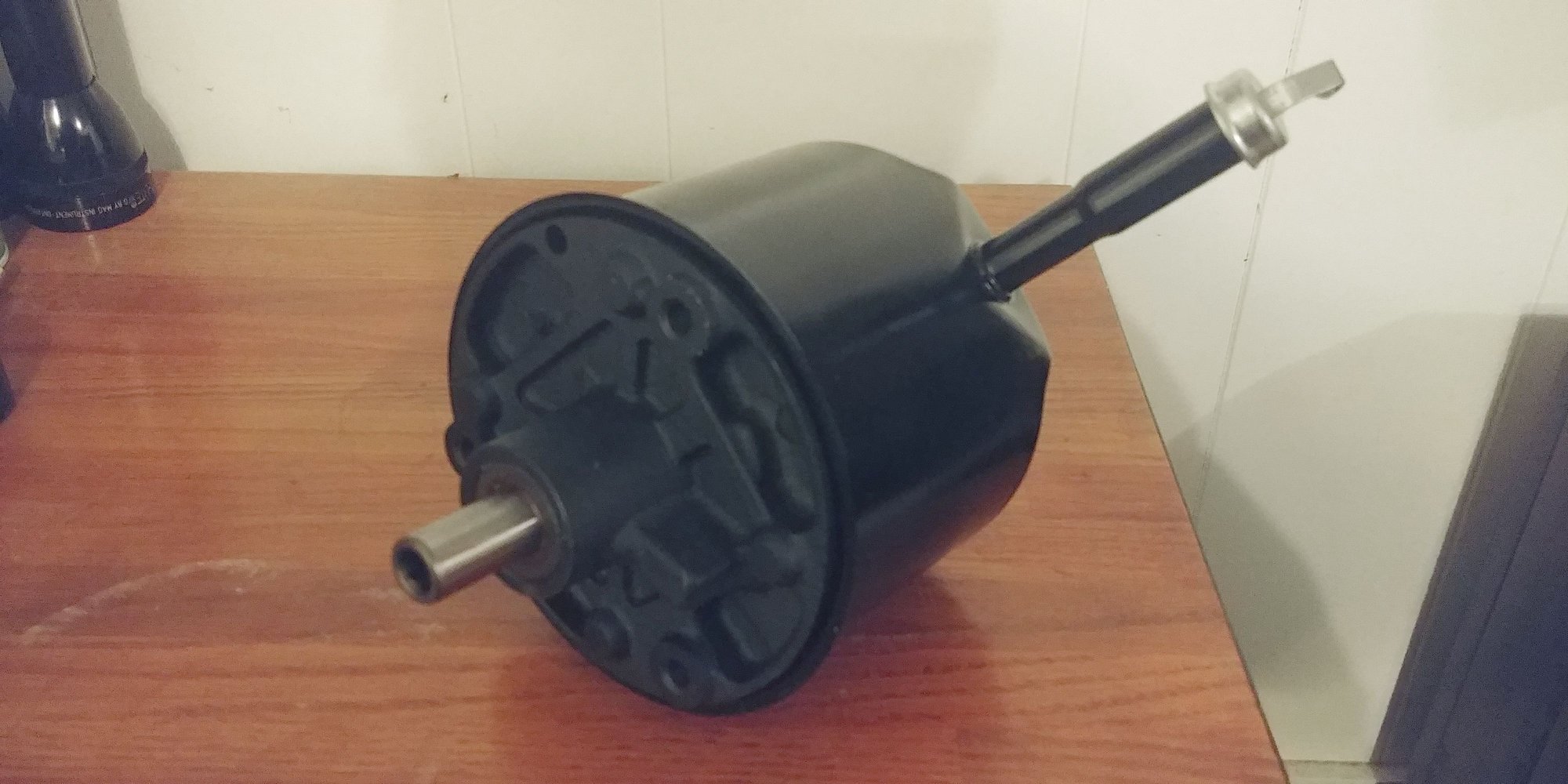

My new not rebuilt power steering pump has arrived. It's branded Cardone. We'll see what its capable of soon.

I installed the new Cardone branded, Thompson style pump. No noises, no leaks and works just as good as what I've been used to. One fingertip steering at a standstill engine idling.
Total time to remove assembly, remove pulley, clean and paint pulley and brackets.. Then reinstalled pulley, bracket and entire assembly. About 1.5 hours and driving down the road. 100% happy with the Cardone pump so far.
If anyone wonders if I flushed the system. Well I did that last week by it dumping more than two quarts of fluid in three days. Hoses are all new also.
