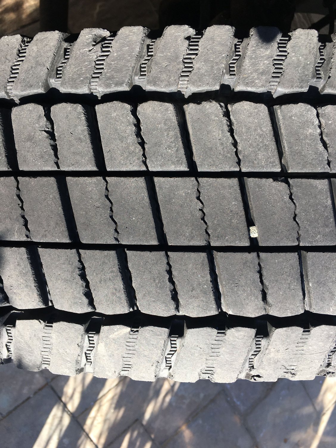

The key thing being missed is the fact that this is a F450. Which means wide track and tighter turning radius. The outer edges will wear faster because of these two factors. Will it hurt to have it checked...no. However, the wear being described is perfectly normal for the F450.

this is drivers side. More wear on outer than inner. Pax side the same....photo won’t up load. 7500 miles. Normal for a f-450?
