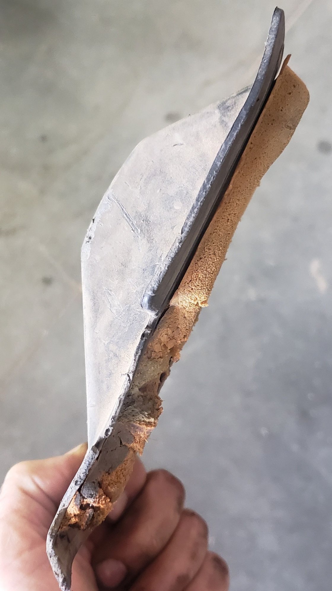

Hi again.
The video you shared is right where I need to get, but I ran into a plastic and hard foam piece where I need access. The piece is old and brittle and if I force it I think it will break.
What is is? And can I just yank it out without doing lasting damage. See the pic for what I mean. Thanks for any advice you have.

Originally Posted by Schlominator
Hi again.
I'm necro'ing this thread because I just did an '06 and ran into the same stupid insulation as shown. If you look further back it's actually 2 pieces and connected with Christmas tree clips, pretty much right at the CHT in the RH (passenger) head. Some creative pry bar work will get it to pop apart. I did not reinstall, our '08 F150 with the same engine has never had this as long as we've owned it from 89k miles to 140k miles.
Also, just a tip for others: to get the electrical connector off I used two pry bars strategically placed: one to gently lift, and one to disengage the tab. The tip is this: the connector is disengaged near it's base, furthest from the wires. With many connectors you disengage by squeezing at the "top," near the wires, but this one is a little different.
Finally, I had a Williams reversible flex ratcheting wrench and the reversing mechanism makes the head too big and too long. You do indeed need a basic, non-reversible (this means you flip it over to go the other direction) ratcheting wrench.
