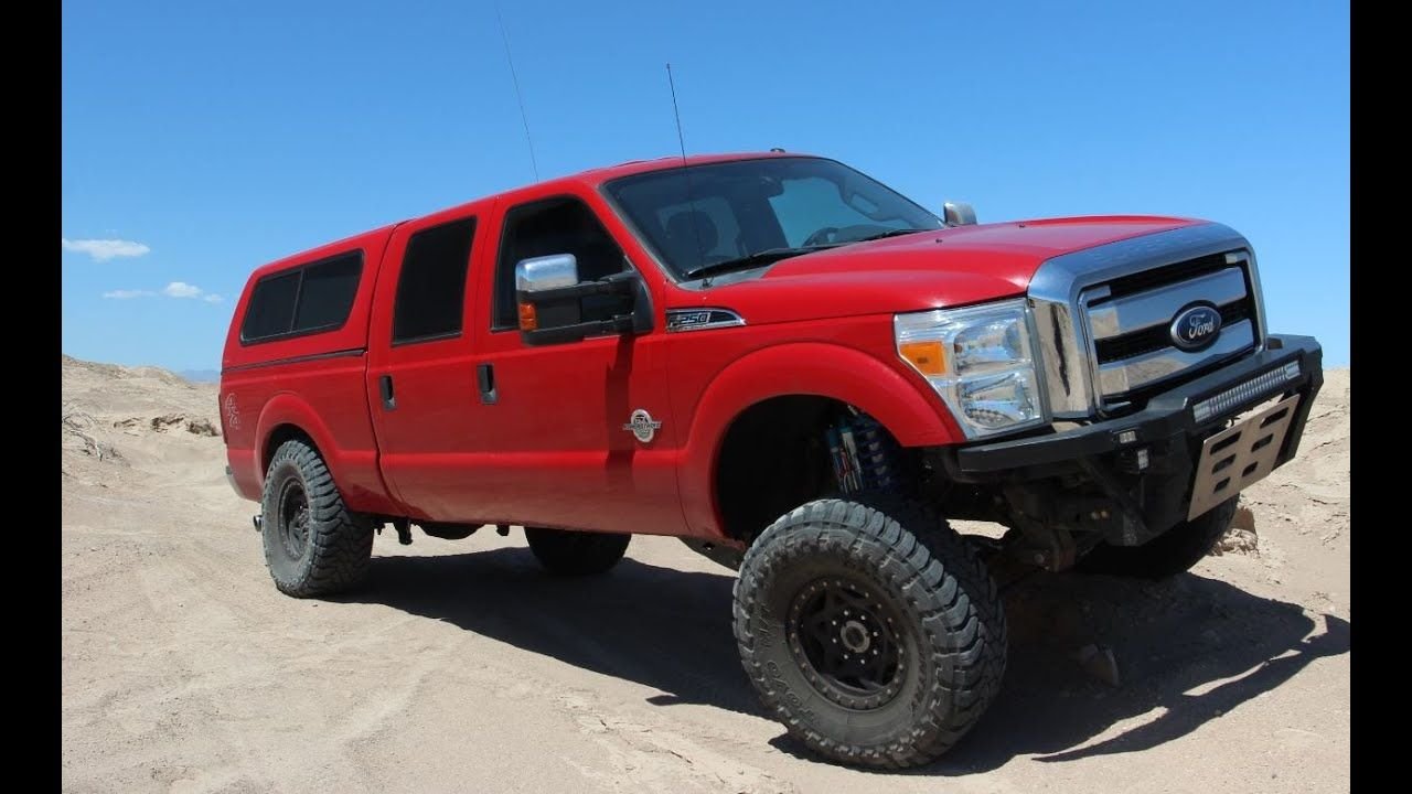

I kinda went a different route. 2019 Ford F350 XL CCSW and when it was stock I dropped my AF990 on it and of course it sagged and swayed. Swapped out the original springs and had a custom 8 pack made by a spring company out here in SD and then loaded up the camper and all was good. I also added sway bars front and back as well as air bags and now it handles fine as far as sway and sag. Springs are huge I think upgrading springs as opposed to just adding bags. That way truck handles more like it was designed to. Good luck.

Based on your camper how close are you to max payload? With the right air-bag setup with daystar cradles you would only need 20-40psi in the bags and retain axle travel. That also assumes you daily drive the truck. Unloaded with no weight I'd assume the additional leafs would make it a very harsh ride. However like greeno stated a custom built leaf pack by SD or Deaver will be a huge improvement over factory springs.

With the rear leaf set I had made truck rides better unloaded than with the original set. When loaded is better. I think they use different load rates of steel building the packs. Good luck.
