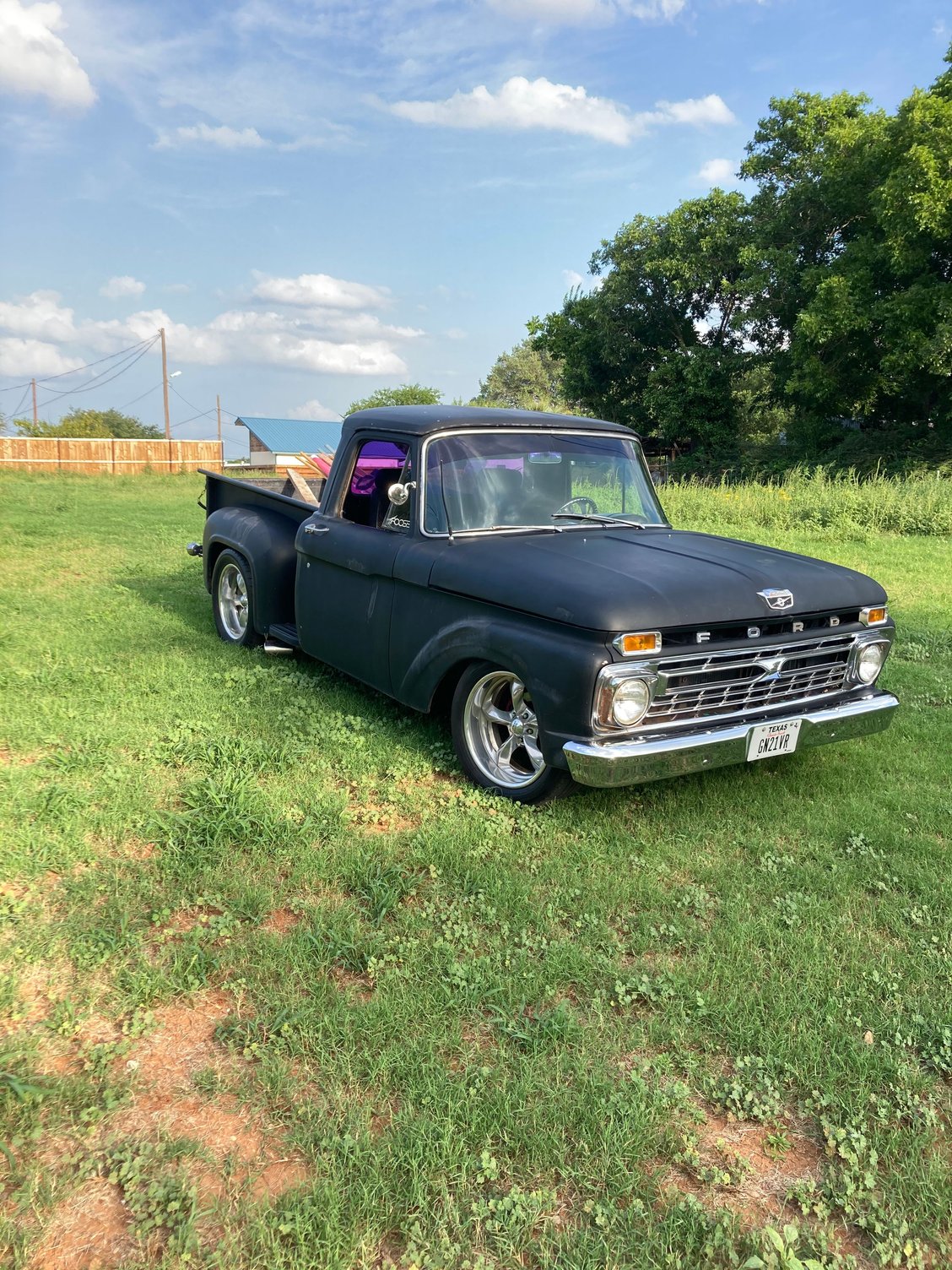

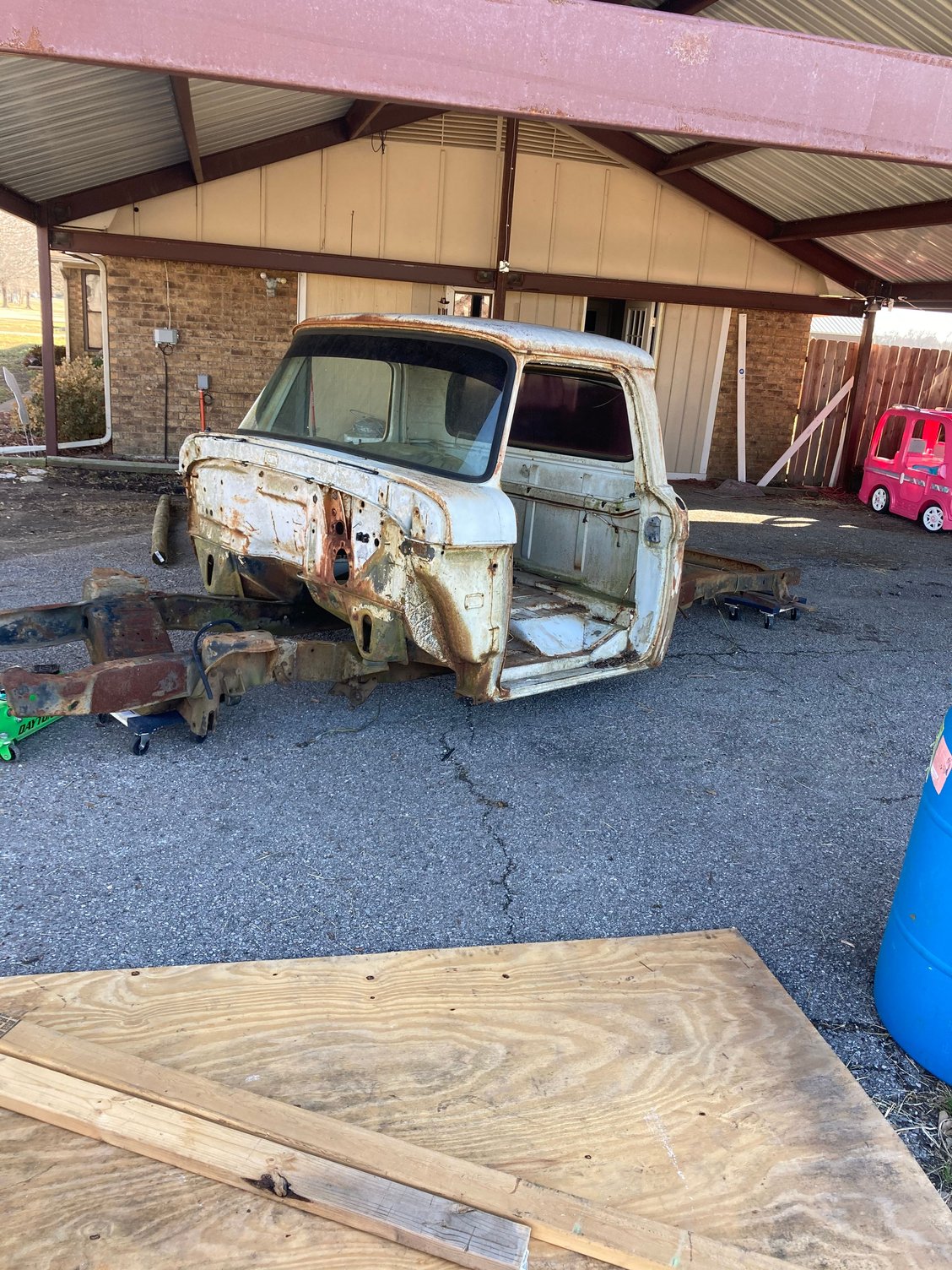

So my dad recently passed down my grandfather’s 66 f100 swb flareside to me. It’s been a long time coming and I’m super excited to begin the restoration. For years I’ve dreamt of the day I can finally start and I’ve caught myself in a bit of a toss up.
The truck has ran off and on for the last 20 some odd yrs. but like with any old truck wear and tear is bound to set in. We got work done few yrs back but the guy overheated the frame so I’ve started collecting parts and I’m down to bare bones frame and cab. I’ll be slowly transferring everything to the new frame. Now where I battle myself is deciding what engine I want to go with. My over all plan is for show not a daily driver and I want other peoples opinion.
Should I go with a fully rebuild 351 or with a 5.0 coyote swap. I know it’s all preference and both have there benefits. I just don’t know what I want. The aggressiveness and sound of a great 351 takes me back to being a kid and hearing my dad and grandfather a few blocks away. But I look at the longevity and ability and reliability to go and drive to a show in another state with a 5.0 also is nice.
I don’t care to much for speed so hp is not a deciding factor for me. I’m more into the cruise just enjoying the time and having back to its glory days where my dad can take it out when he comes to visit.
Any suggestions pros cons whatever to help me decide would be greatly appreciated.
