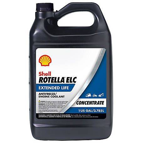

Hey Guys, I'm doing a coolant drain, 2 flushes, Mishi 200 stat. refill with ELC concentrate and distilled water. What is your preference of ELC brand and premix vs concentrate? Thanks in advance!

I do not have a preferred. I bought what I could find locally at Tractor Supply-Shell Rotella ELC. Coolant capacity is 27.5 quarts. I pulled both block drains to get out as much water and debris, old coolant as possible. Then to get to a 50/50 mix you have to add 3.5 gallons of "concentrate" then top off with distilled to the minimum line on the Degas.

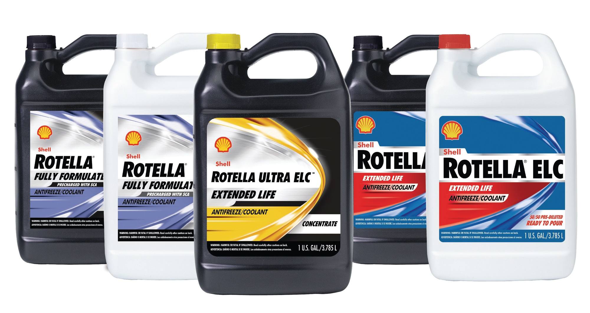

The Rotella (Tractor Supply version) I had in for 8 years/70k miles, and it always tested fine. I was planning on a 10 year/ 100k dump, but I actually did it at 70k, 5k before I yanked the motor. I've thought about the newer version, Ultra ELC.
About 5 years ago, I started to use the same (TS) in the farm tractors, and good so far. The dozer I have not done but was planning for this summer. The dozer is complicated, 1952 Allis with a Jimmy 2-stroke and oil cooler. Wow, an oil cooler before the 6.0! Yeah, they can be problematic too.
Tractor Supply:
You used to say "Black Bottle" version for the Extended Life, but we've gotten complicated, just don't switch the caps around.
