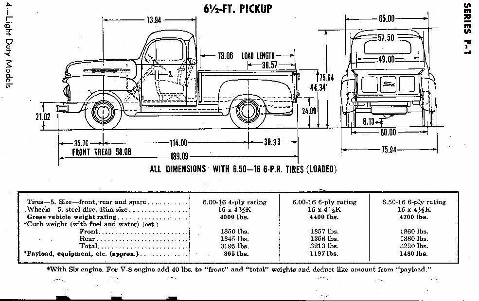

I am making a custom frame for my F1 and don’t have the original frame to measure. I have searched this forum and the internet with no luck. I am trying to find where the cab mounts should be located. Would anyone have the dimensions of the three mounts for each side? Measured from the front of the frame to the first mount and distances in between? Any and all help would be appreciated.

Here's some diagrams;

Old Dimensions diagram
52 Ford F1 Exterior Dimensions diagram/pictorial/drawing
If I found this online you may be able to find something closer to what you're looking for. Sometimes it's just a case of asking the right question so the Search Engine can locate it it for you.

Thanks Tocguy and bobbytnm. I was able to find both of these after looking. I appreciate the help. Hoping someone can measure if they are near one. My dad and I were working on this project before he passed. I have a shop working on it now and apparently one of the mounts are off 1/2” but without knowing the dimensions of the body mount locations the shop and I are not sure which is off. We made the chassis using the pics in this thread but nothing with the cab mounts. I know dad measured a chassis before but not sure where he was off.
