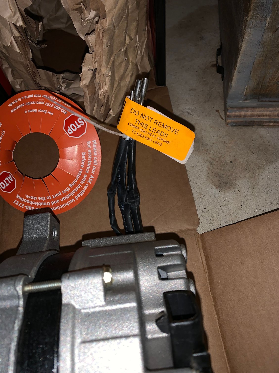

So the alternator on my 1990 f150 xlt lariat is 31 years old now, and definitely due for a replacement. It still works but its time is near. I bought a new one and figured i could use the same plugs for the wires as the old one. When I took the new one out of the box I see that it already has the plug inside and tells me to crimp and heat shrink it to the old wires. Can I just take this plug out and still use the old one or is this step a necessity?

Replacing that connector/pins is absolutely necessary. Fire hazard. Should have upgraded to a 3G.

Well, i still am able to return it for a 3G. Regardless, how should i go about replacing the plug, do i cut the wires that are already in the truck and then attach them to these wires on the new alternator?

I’d return that one and get a 3g. the 3g doesn’t use that connector

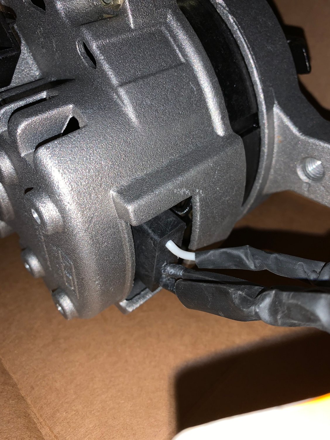

okay, I think im still not sure which is ASI plug on the alternator, I think I understand how the theoretical circuit works but I cant quite bring it to reality. In my original post, are those the ASI wires or the fire ones?

those are the charging wires, aka the flaming connector. the other plug, with 3 small wires is the asi plug
