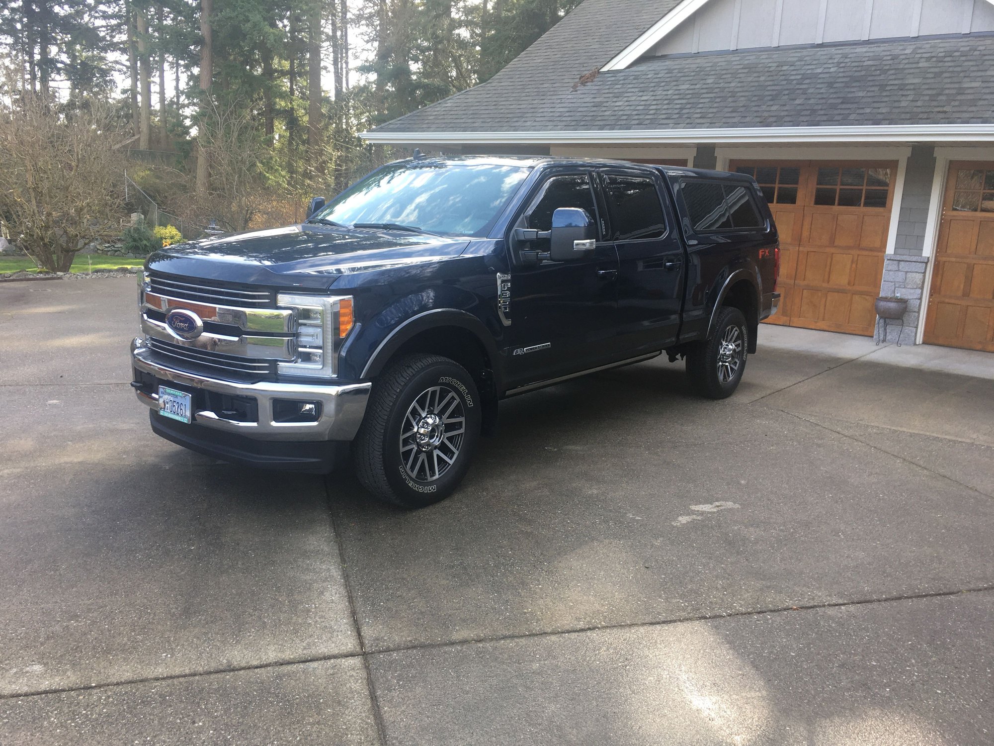

I applied Adams Graphene coating over the Christmas holidays. Day one, strip washed, clayed, strip washed again and dried. Day two, machine compound and polished. Day three, applied the coating, about 3 hours. I closed up the garage and let it cure for 48 hours. The kit was about $100 from Adams and three days of doing something that I enjoy vs paying $2000 someone else, I think I'll do it myself.
Looks great! You described the process exactly. It’s a labor of love but with the right product(s), time and technique the results are well worth it. It cost me about $150 in Avalon King ceramic kits plus the cost of chemicals to strip, clay and polish. Maybe another $100, tops. 2 year manufactures guarantee and I see it going measurably further.
