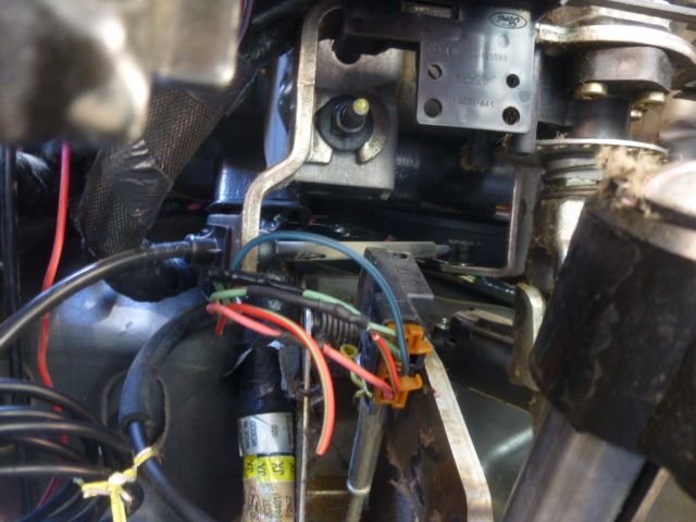

So after having my truck stolen and recovered a month later I've decided to add a hidden switch to lock out the shifter when the brake pedal is depressed, I am sure that one of the five wires attached to the brake pedal will accomplish this, So far I have eliminated the pink wire, so that leaves four more wires to try, when Ive figured this wiring out I will share which color wire needs to be spliced to add this .99 cent anti theft deterrent

I have attached the wiring diagram for the shift lock. It should help you out. It appears it is the RD/LG wire you want to work with.

A simple5 Pin DPST relay using the Brake Lamp Power Wire and another at the IDM Power, a SPST hidden Switch will accomplish this.

I should've waited for youre alls help and could've avoided my butchery, Anyway RED wire w/ GREEN TRACER is the shifter lock out. So that's where Ill be adding my hidden switch, I believe its a cheap and simple theft deterrent,

When I cut the red with green Tracer it leaves my interlock unlocked all the time
