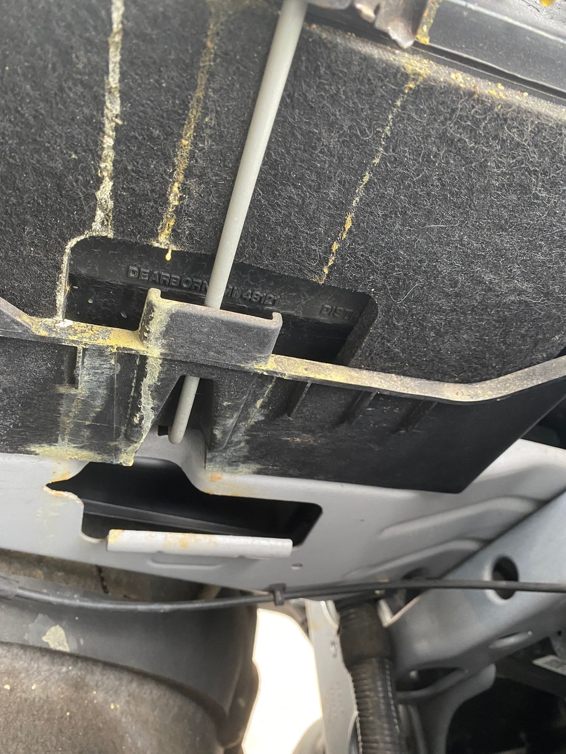

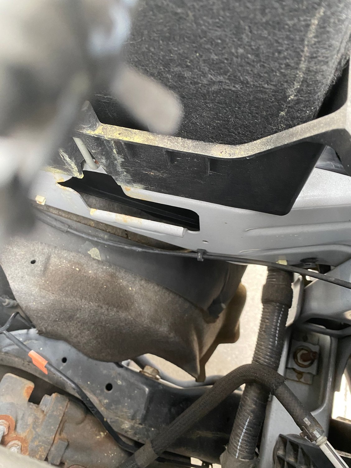

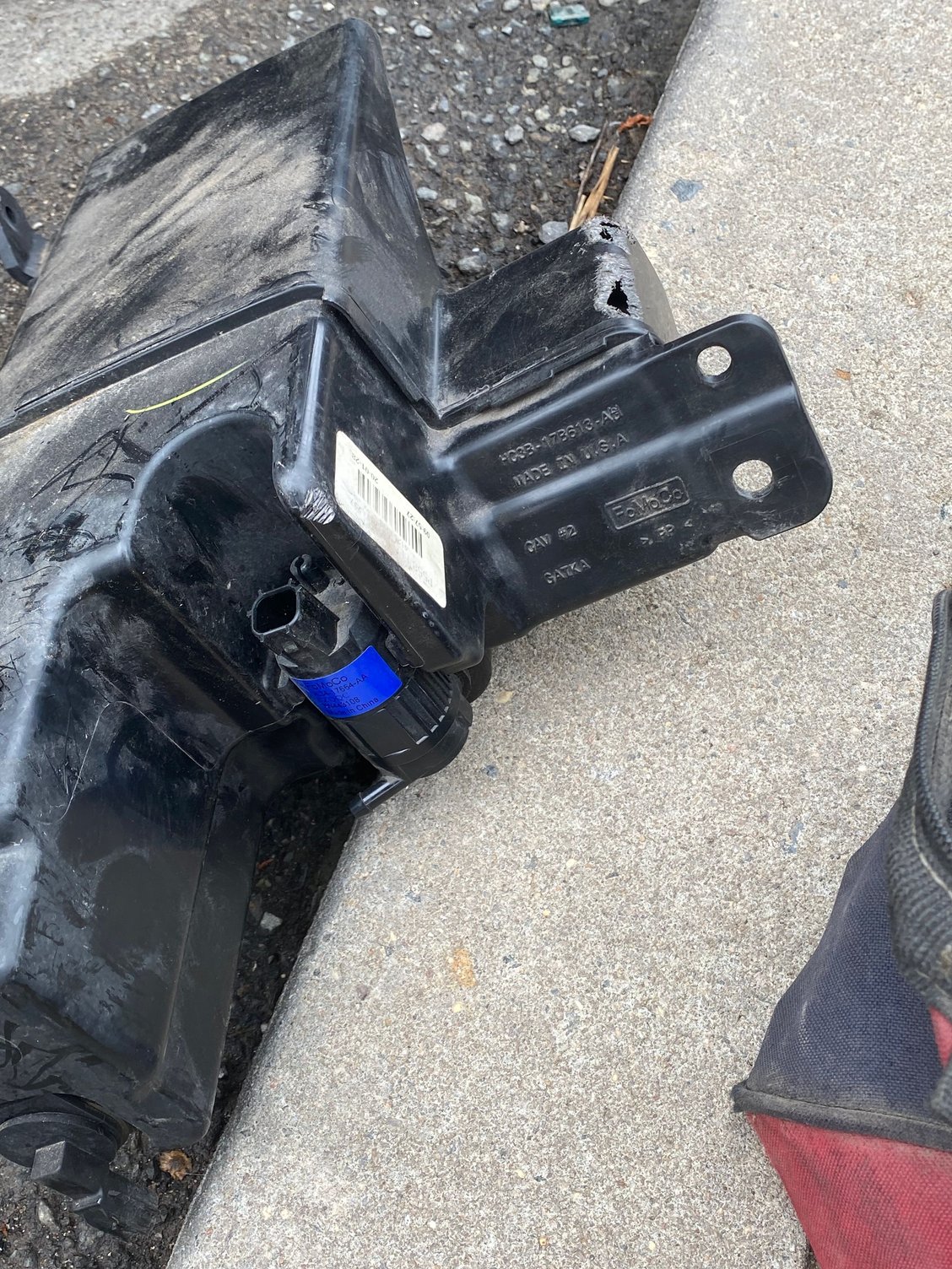

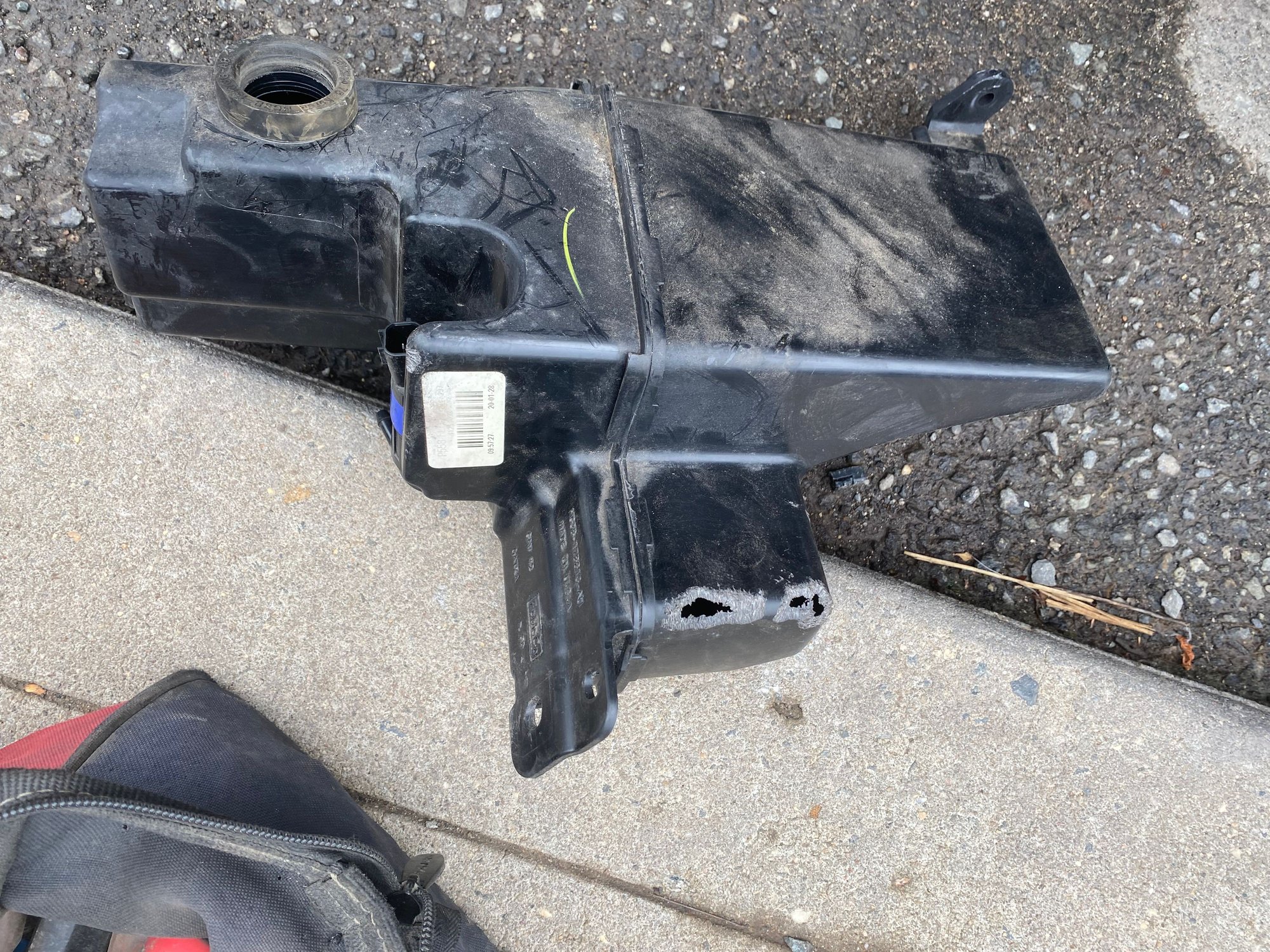

I know this is a relatively minor problem compared to some who’ve had to replace engines and transmissions. Just curious if anyone else with a similar setup experienced this. My truck has dual batteries and dual alternators. The windshield washer fluid reservoir sits under the battery on the driver’s side. Before the bumper to bumper warranty expired, the reservoir began leaking after filling it to about 1/3. The local dealer refused to replace it under warranty, claiming “critters chewed through the plastic, not covered under warranty”. They wanted a ridiculous price to replace it, $688. I ordered one from the OEM manufacturer for < $69, while continuing to fill it to just below the leak. Yesterday, finally had it replaced. Does this look like a rodent, squirrel or other “critter” with an alcohol addiction chewed through the hard plastic? Maybe a critter with a file. Looks more like an engineering fitment issue, or the tight placement under then battery tray caused friction between the metal surface and plastic edge of the reservoir to rub completely through. I’m guessing the service department at the dealership never even looked at it, unless they used a remote camera, because there was no evidence the optional inner fender liners bolts and clips had ever been removed before.
You will probably get a better response in the 2017+ Super Duty forum.

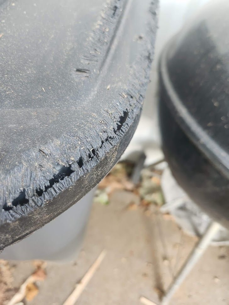

here is squirrel damage on a trashcan lid...
