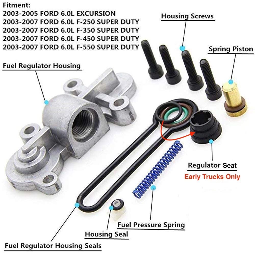

Bismic (Mark?)- yeah, I’d prefer to see it stay over 50 as well. Is there a gauge you’d recommend? I have no idea and would sort of be in the same situation if I just bought whatever.
TMT Jack- the plunger that is part of the blue spring kit? So, even if the spring is doing it’s part the rubber seal around the plunger may be giving up pressure?

A very aggressive tune and injectors that use more fuel than the original design parameters can impact WOT pressure. The original design does not have a lot of volume margin, and if it did, we wouldn't see any pressure drop. The design is a loop of constant volume, regulated pressure. What fuel is used by the injectors is bypassed off the loop. If you bleed enough volume off, pressure drops. But if there are any issues of delivery or loss, the pressure drop is higher.
I covered this in my video about the HFCM.
Yes, the spring can be fine, the seal can be the issue, and we've seen a lot of that with any of the replacement kits, including Motorcraft, although the Motorcraft is the most reliable for spring and plunger. And for the early trucks, you can't forget about the o-ring behind the replaceable seats.

Got it...sooooo, new blue spring kit. Suh-WEET!
Will let y’all know the results once I get time to install it!

Also, with regards to the little white plastic “orifice” in the blue spring kit...what purpose does that serve? Bleed any air at the top of the fuel bowl?

That is the continuous air bleed for the initial fill and any entrained air released by the HFCM. The o-ring behind it can be a factor.
