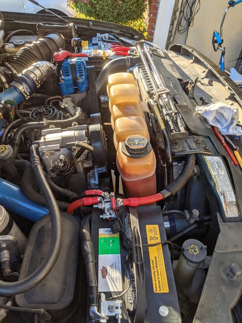

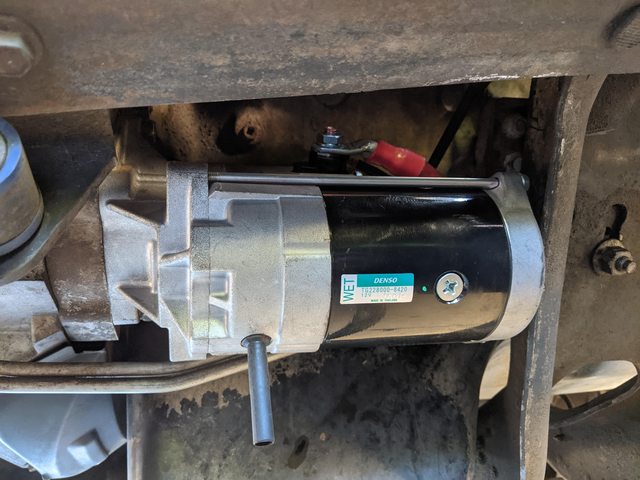

New Denso starter, alternator and 2/0 battery cables. Whenever the dang rain stops...

Very nice! I love the large cable upgrade. I have done some half step upgrades to my cables but am keeping an eye on a complete overhaul. Is that a 6.0 alternator?

Thanks. I bought the alternator from Mechman for a '99 7.3 L. Whether it works on a 6.0 or not I don't know. It does use a cable adapter so maybe.

I have had issues with the cables loosening regularly on the military terminals when the cable ends are tightened directly to the terminal. I resolved this by using longer 9/16" bolts and installing a nut/lock wash against the terminal and then the cable ends and finally another nut/washer. To clarify: Terminal face>Lock Washer/Nut>Cable ends>Lockwasher/nut.
Something to consider.

Finally got it done yesterday, holy smokes what a difference! Strongest fastest crank ever.
Attachment 280354
Attachment 280355
Attachment 280356

Well done sir! I accomplished similar upgrades 3 years ago this past October and you are right, "strongest and fastest crank ever" sums it up nicely.
I installed NorthStar AGM batteries, Denso starter, 160A alternator, positive and negative cable upgrades. I will do the battery terminals following your guidance once of these days.
Thanks for sharing pictures with us, we like pictures. Here is how my engine bay turned out with the electrical upgrades.
