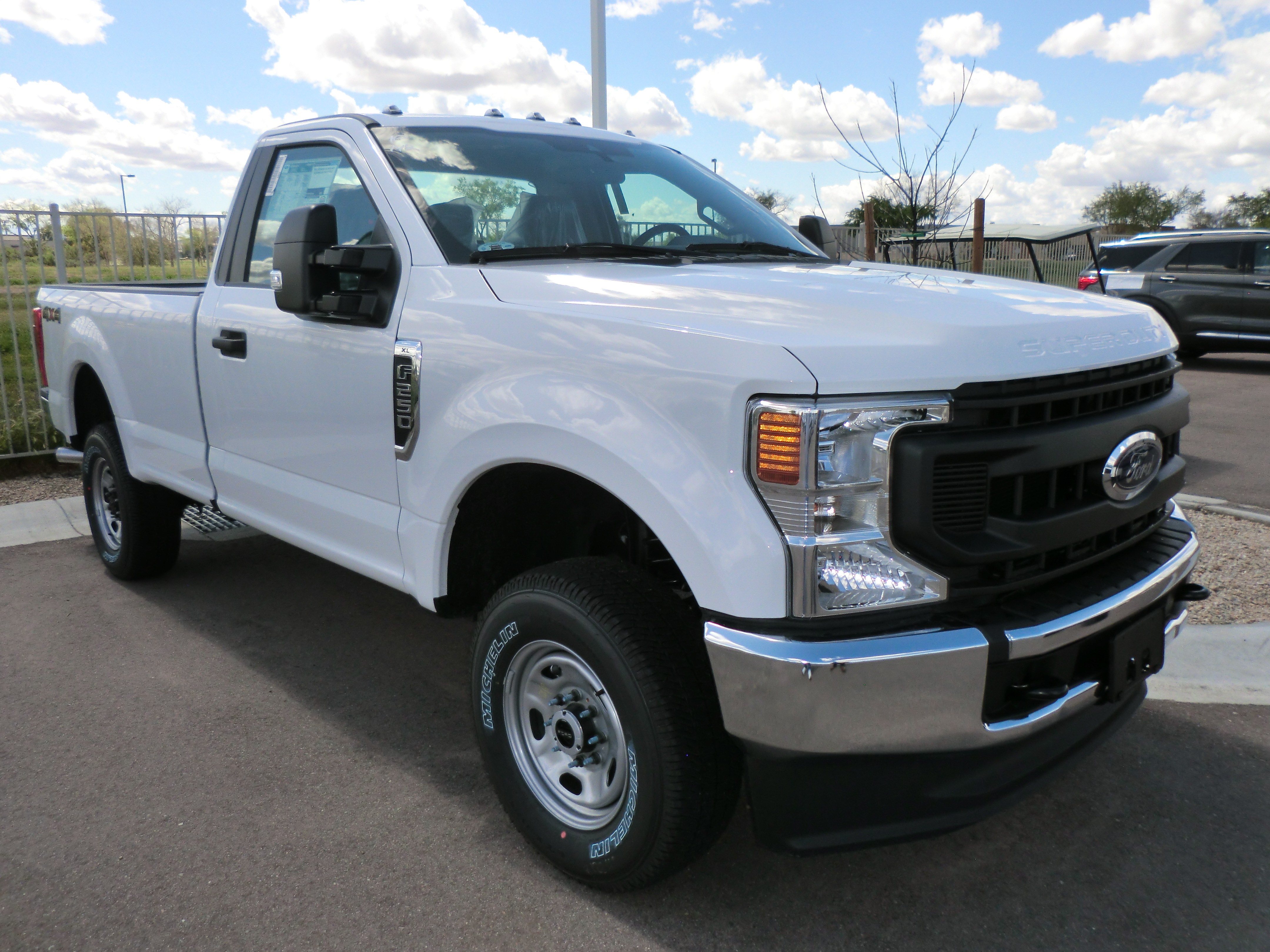

I knew when I ordered my F-250 that the OEM tires would not fit the bill, I up graded one size to the Michelin so I would not have a spedo issue
And from past experience I also up graded the wheels as they are a 1/2" wider then OEM making the F-250 corner rather nicely, staying with the
same size I gained about an inch
Right off the transport
Attachment 280372
One Day later
Attachment 280373

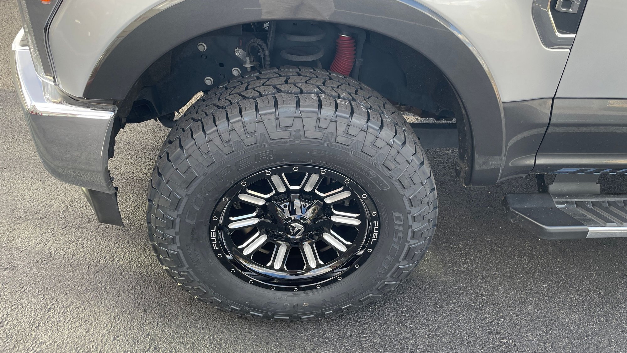

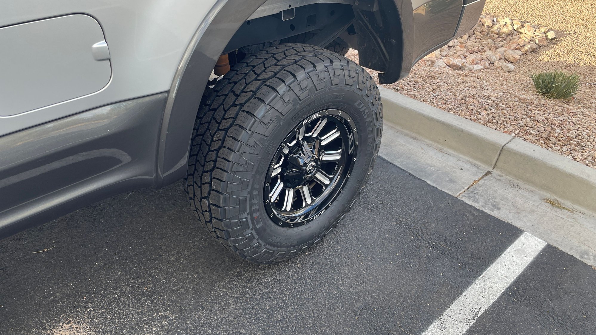

I have always liked Yokohoma tires so that is what I put on my 2020 F250 Lariat 7.3. Yokohoma XAT3 LT305-70R18 Load Range E. They ride good and have a slight whine at about 50 and above. I was going to put Nitto Ridge Grapplers on because they are totally quiet and took less weight to balance. My next tires will be the Nitto. The Nittos you see in the picture have 20,000 miles and have only worn 3/32". The Jeep weighs 500lb less than the F250. The Yokohomas don't rub at all. The front is lifted with Tremor springs, Shocks, 1" spacer, and Tremor Spoiler. The wheels are ICON 8.5" width with stock backspace. I hope that this info helps.
NITTO Ridge Grappler 38X13.50R20LT128Q E2

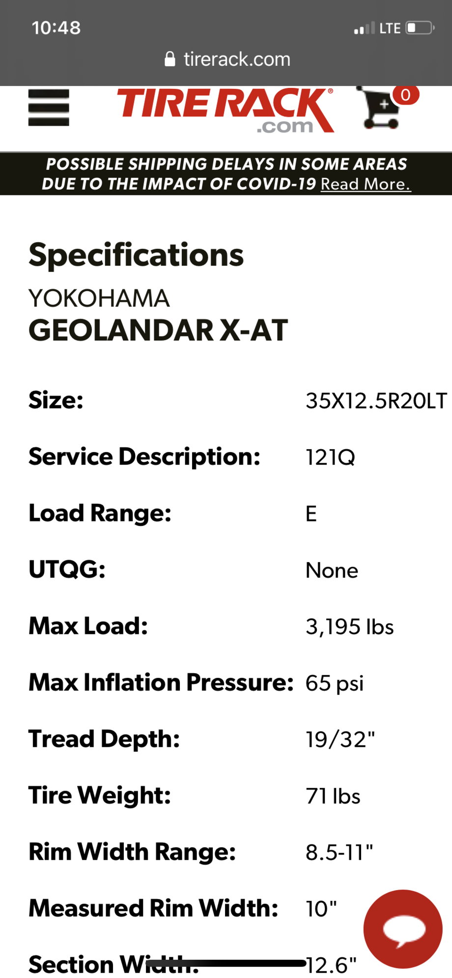

UPDATE: Thanks for all the info and advice. I decided to go with the Yokohama XAT's size 35x12.5x20. I ordered them from Tire Rack. They just emailed me to make sure I knew these tires have a max inflation of 65psi while the stock tires go up to 80 psi. They both have a load range of E. Does anyone see this as a problem?

UPDATE #2: I kept the same model tire Yokohama Geolander XAT, just changed size to 295/65/20. That brought the max tire pressure up to 80 psi and their max load is 4080 lbs, which is higher than the stock tires.
