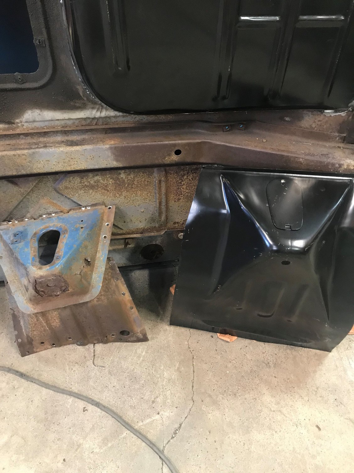

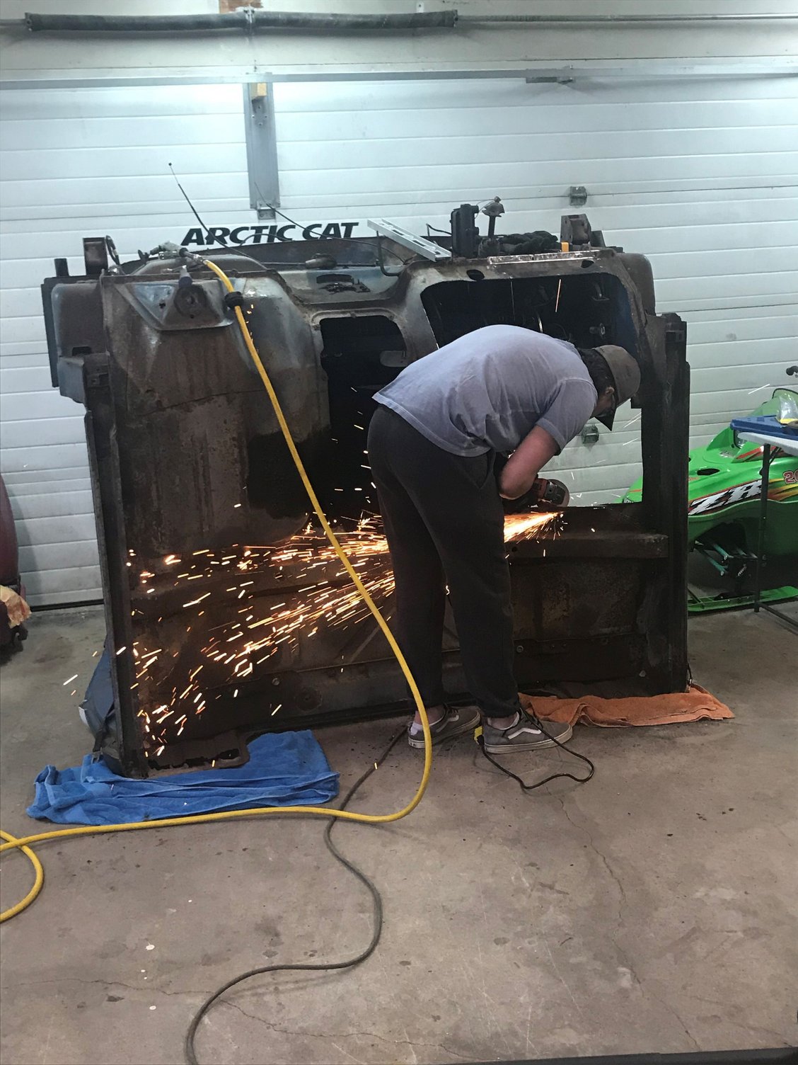

Hello all. My son and i are going to be building this project for him and we are trying to get it done in time for his graduation. Its a tall order as i am gone away for a month at a time, so a lot of the work will be on his shoulders. Which is the way i think it should be!! So far we have driven it to a shop for a pre-safety, and it needs quite a bit of stuff. It turned out to be a little rougher than we had initially thought, but now that we are in it, we have to keep moving forward. here are a couple pics of what we have so far. it also needs cab corners and inner cab corners, but i cant find anyone who makes them. and while we have the cab off, we are thinking of replacing the rear cab mount support.
The truck has always belonged to a local farmer, and was used as a spray truck. its a 352 4 speed. every hole that is open was occupied by a city of mice!!! I also have to cut a little from each side where the air ducts are to be able to replace some rotten metal from mouse pee and poop!!

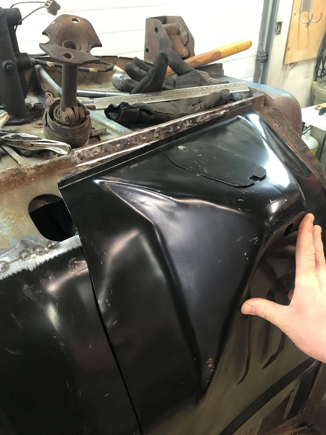

I know this has been covered a thousand times, but I just cant help think that there has to be something better!!! I am looking into getting the Dennis Carpenter ones, and wish i would have when I ordered all this metal. But these don't even come close! The original sits nice, but the aftermarket one, i cant even make work. What, if anything, have others done, or should i just bite the bullet and get the DC ones? I'm in Canada, so they will cost me a fortune to get them here.

The last picture didn't
show up.
I realize I have to trim it, but the angles and everything are not even remotely close.

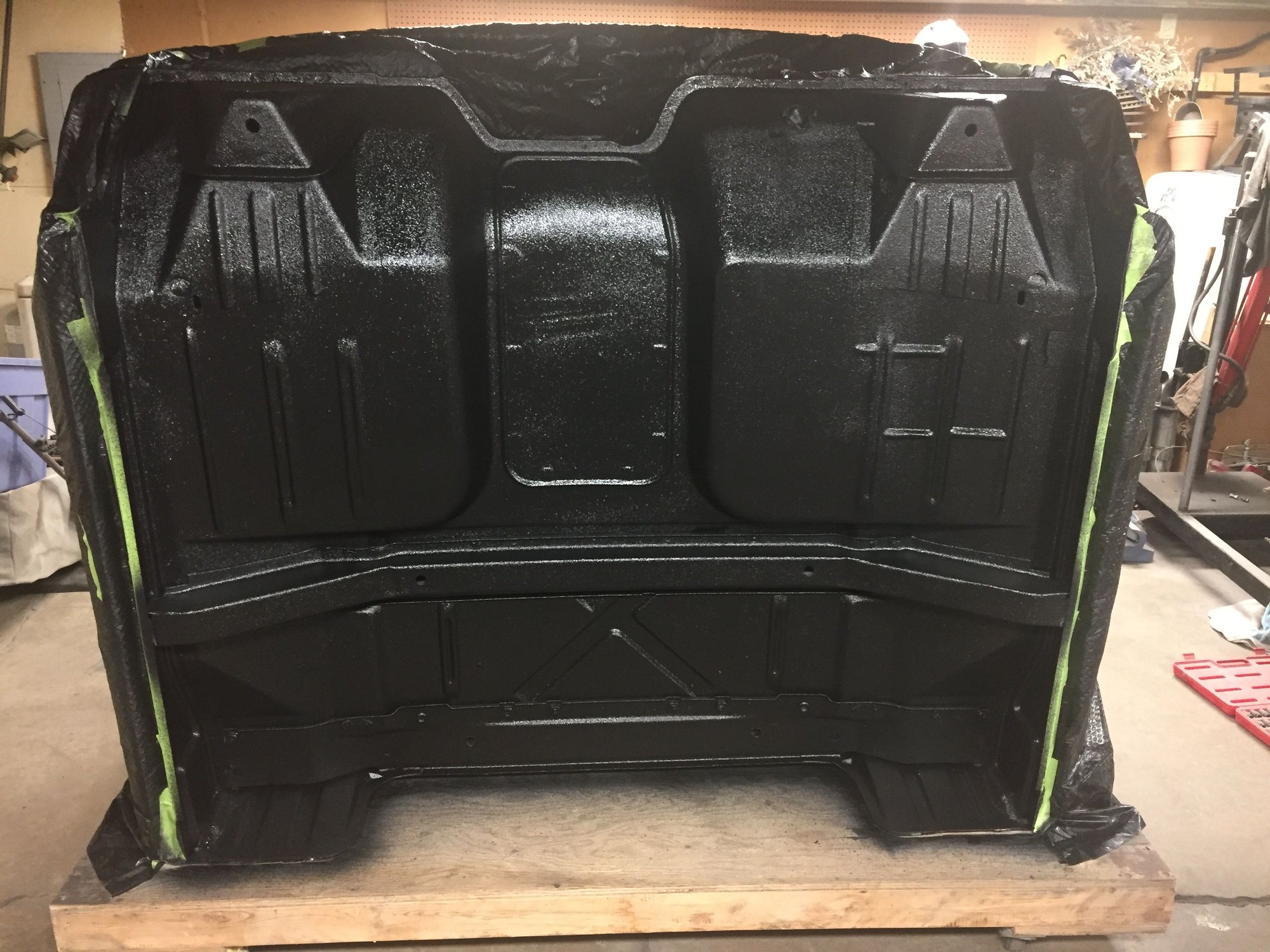

Your front cab mounts look good to reuse just fix the the rust and weld them back to the original spot welds. Then you know it is right back in the same spot. I did this to mine, in the picture. Also, Flashback 100’s makes the inner cab corners and they are a nice fit. I sliced mine in a spot to get the angle right but it was easy. Were at in Canada?

I have never changed the cab mounts. But I am assuming there is a left side and right side mount. Try reversing them.
