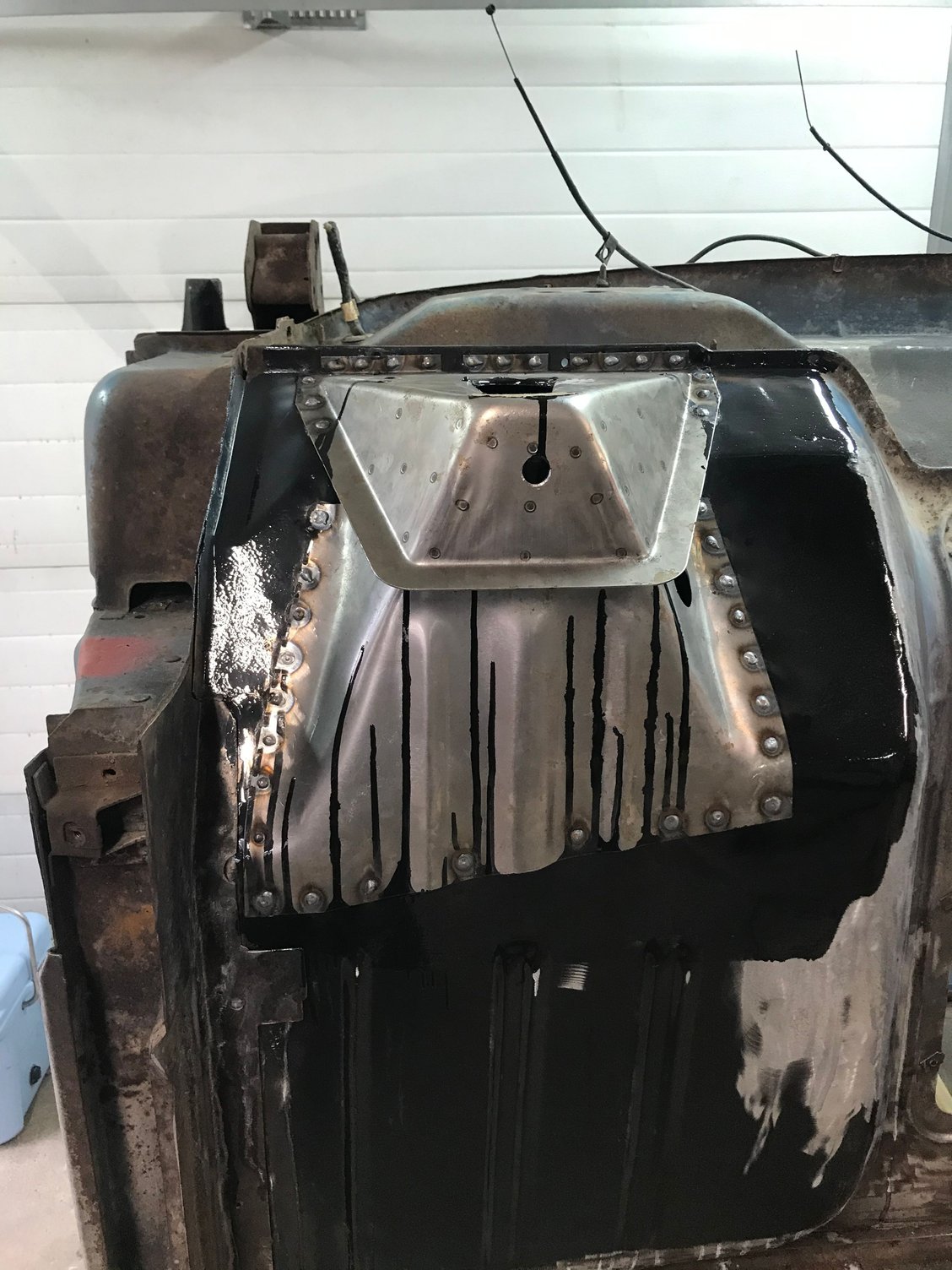

Well, I was back home for a week and got some more done on the truck. We finished welding in the pans, and then mounted the cab with the mounts held in place with vice grips. Marked all our spots and made a few adjustments here and there. Then painted the mounts and area with POR15 and welded it all together. We then degreased, pressure washed, and etched it and my wife and son will paint the bottom while I’m gone. It was a good week of getting stuff done, and now he can start to get it back together. We just need to find a complete bolt set for the front.

Welded all over
Son painting the mounts

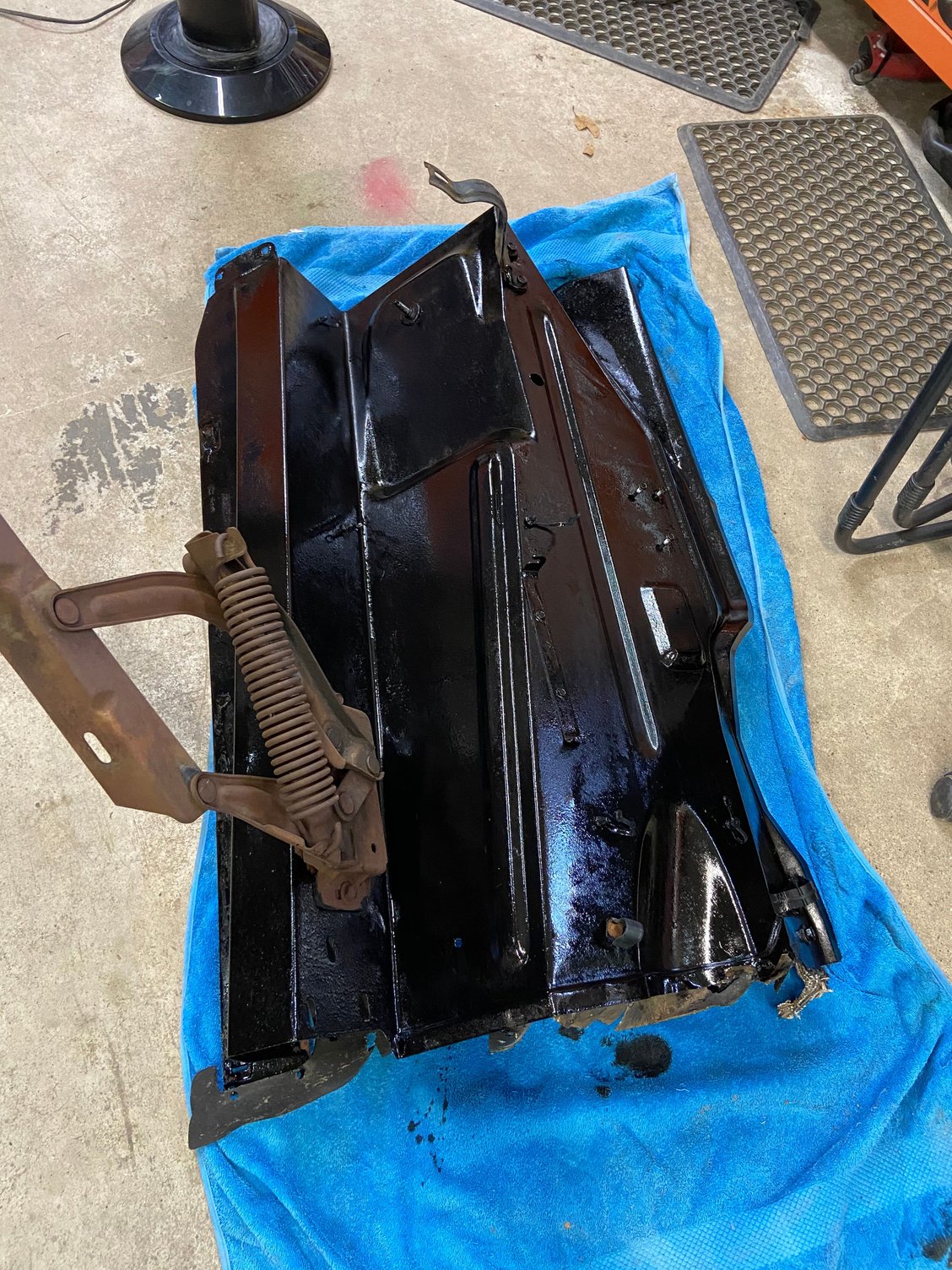

Making progress! My wife got involved and painted the whole underside of the cab, inner fender aprons, and frame! I’m away at work so she stepped in while the son went out celebrating!! Thank god for moms. After the cab goes back on, it will be on to the rear axle as it needs seals. And we will totally rebuild the rear brakes at the same time.
coming together!

Great progress, that floor and those cab mounts look great!

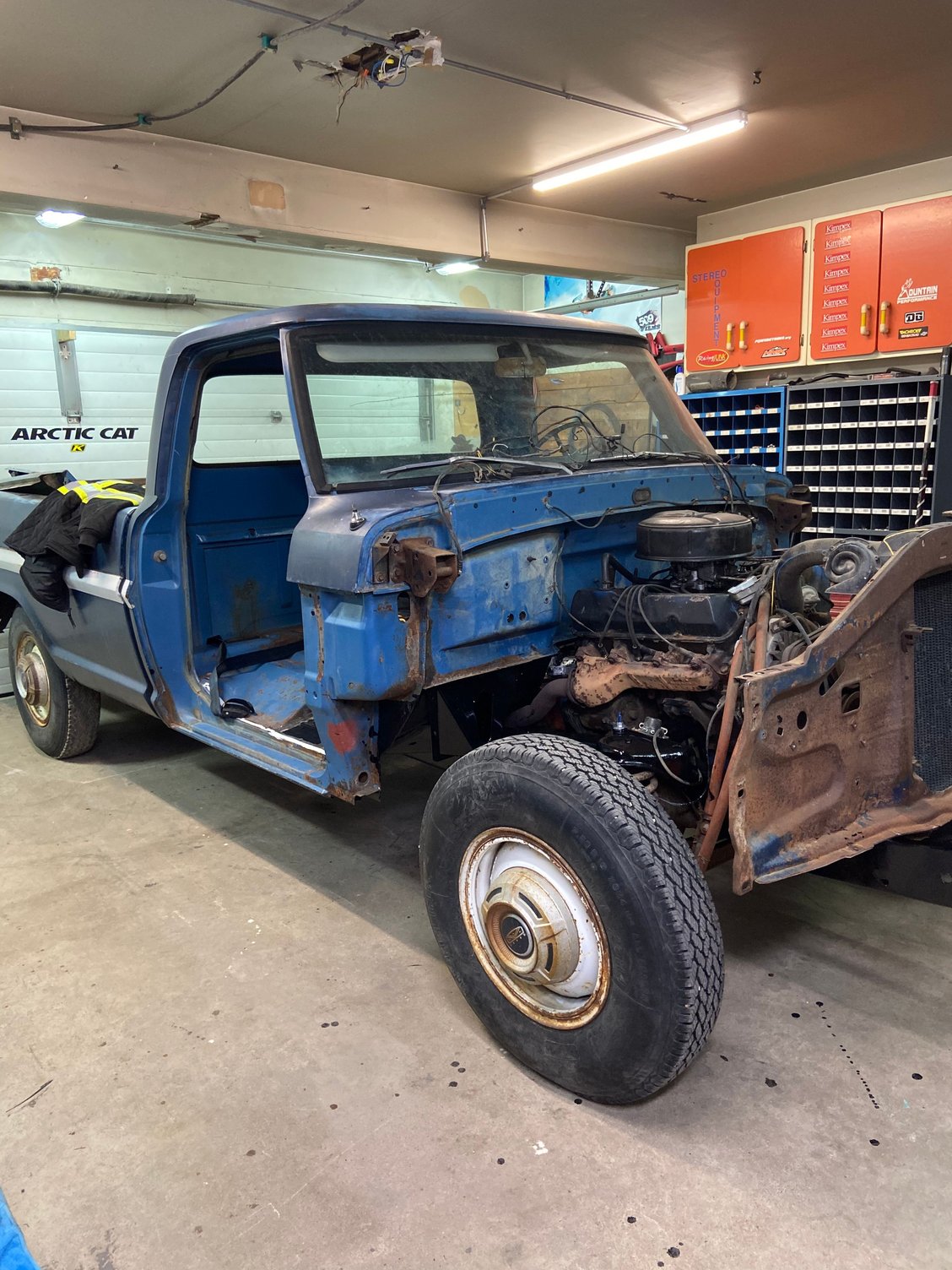

Well, making more progress. Son put the cab back on tonight. Lookin better!! He wasn’t there when I took all the linkages and wiring off so he’s having a bit of a struggle but we have been FaceTiming to try work through it.

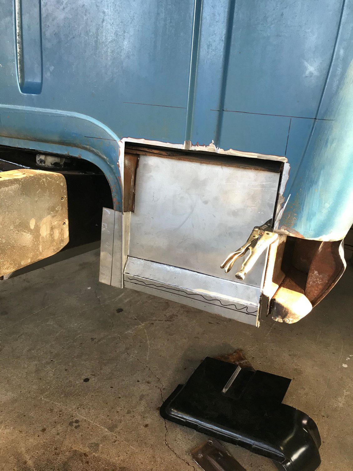

Well, truck is coming along. Got the cab on, wiring done and all the lights working. Had to put new sockets in the front as they were corroded beyond repair. Got a new fuel pump on, and runs good. Rebuilt the carb, and have new tires, just waiting on wheels. Pulled the box off to get at cab corners, and rebuild the rear axle brakes, and to paint the frame.

Think a guy could put closed cell spray foam in the cab corners to keep moisture out? It’s water proof in house use. Use a low expansion kind for windows and doors.

Made a little progress today. It’s not as nice as I pictured it to be in my head! But it will close it off like it’s supposed to.
Will have to trim off the excess after it’s welded in.
