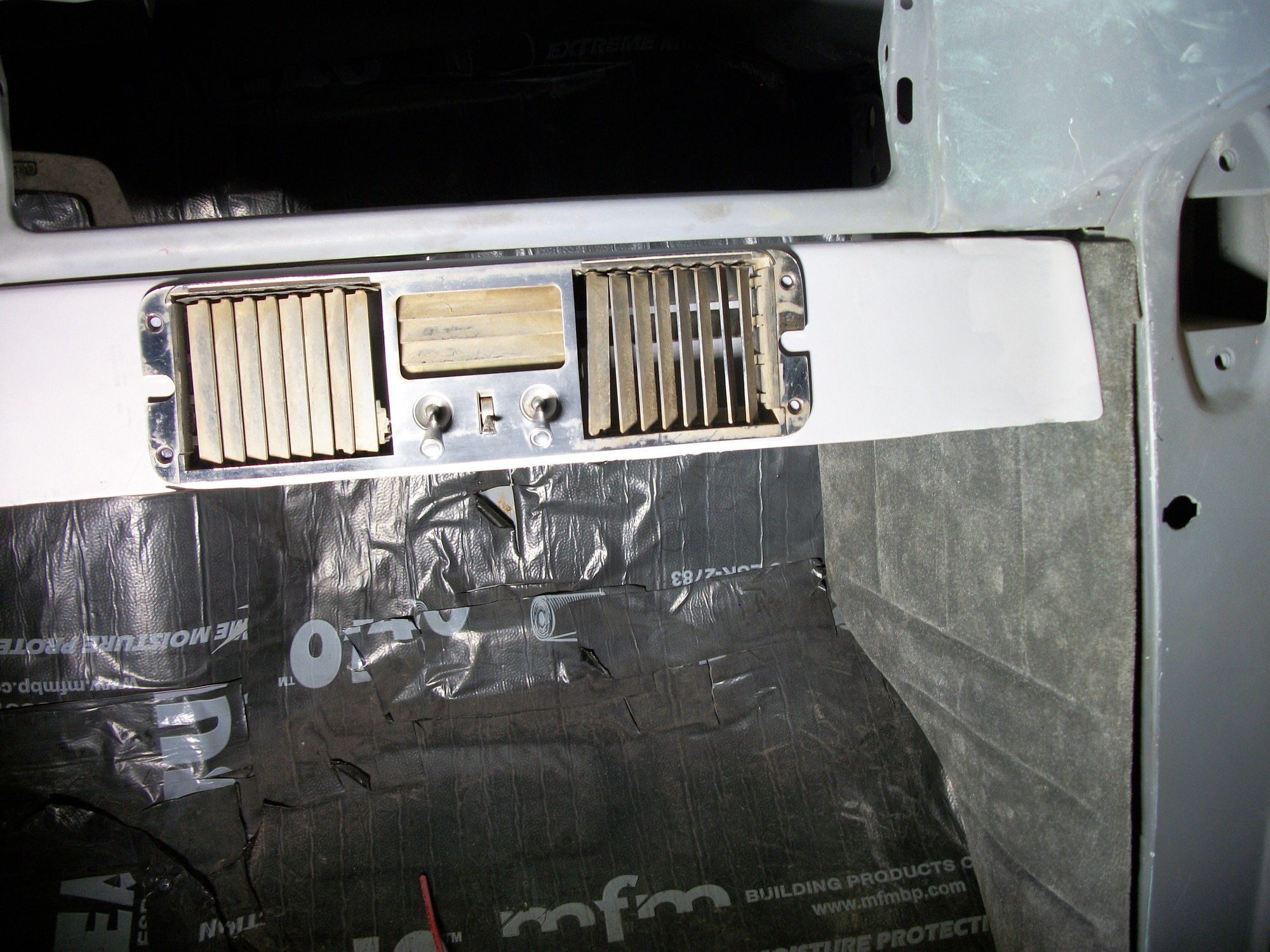

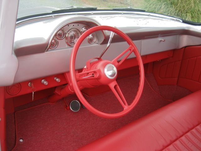

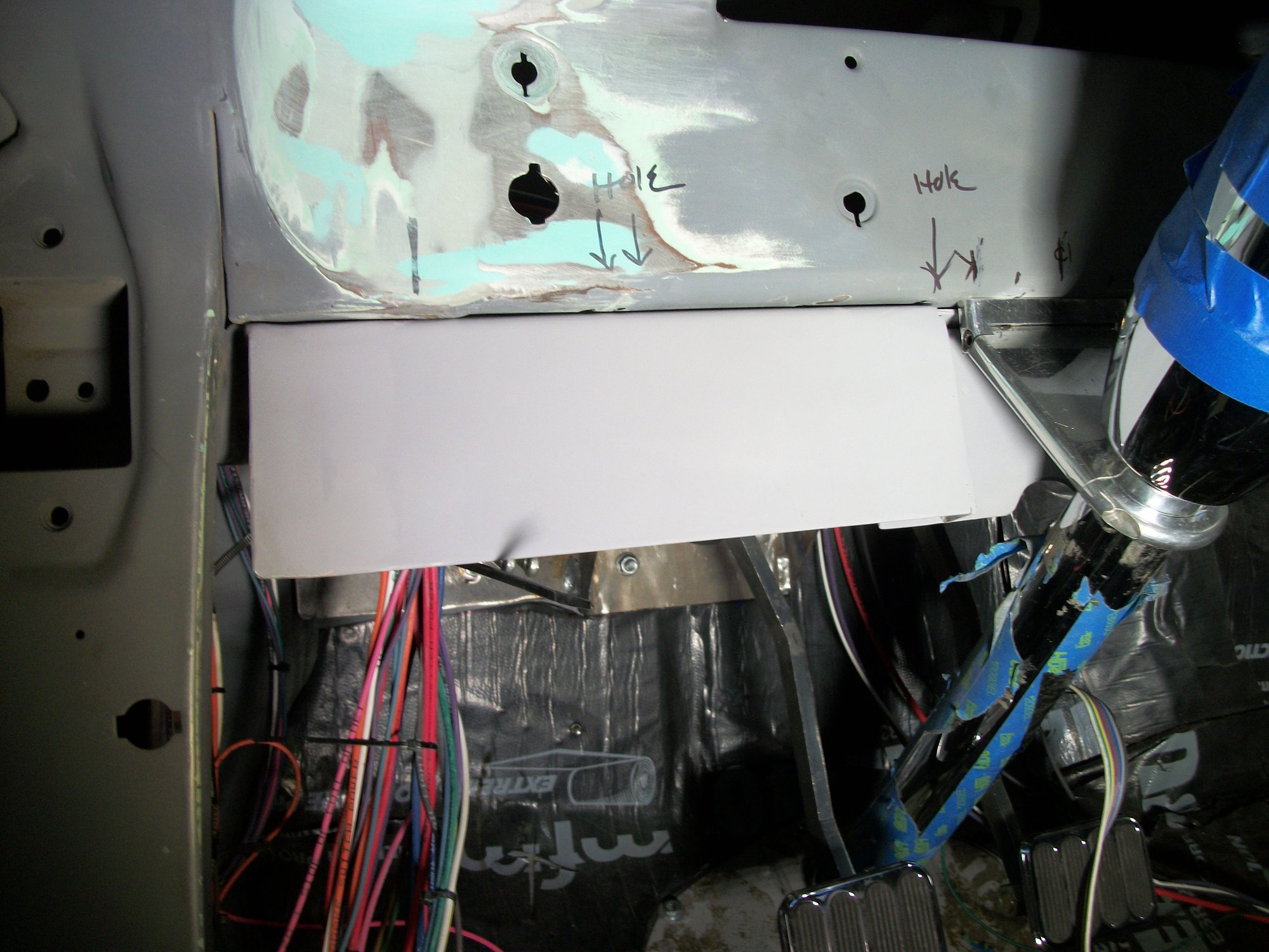

All of this is not even bolted. Just have random c grips holding it. Right side is not clamped. Yes you will have to have a gap at the ends so the kick panel will fit. I also had the Mid Fifty extension and was not really liking it. The glove box door was not lined up. At first I thought it was ok. But after really putting time into it, was not going to work. Marten gave me the inspiration to build another one.

I have a half to five eights inch gap on mine. It depends on your thickness of material and padding that your kick panels are
