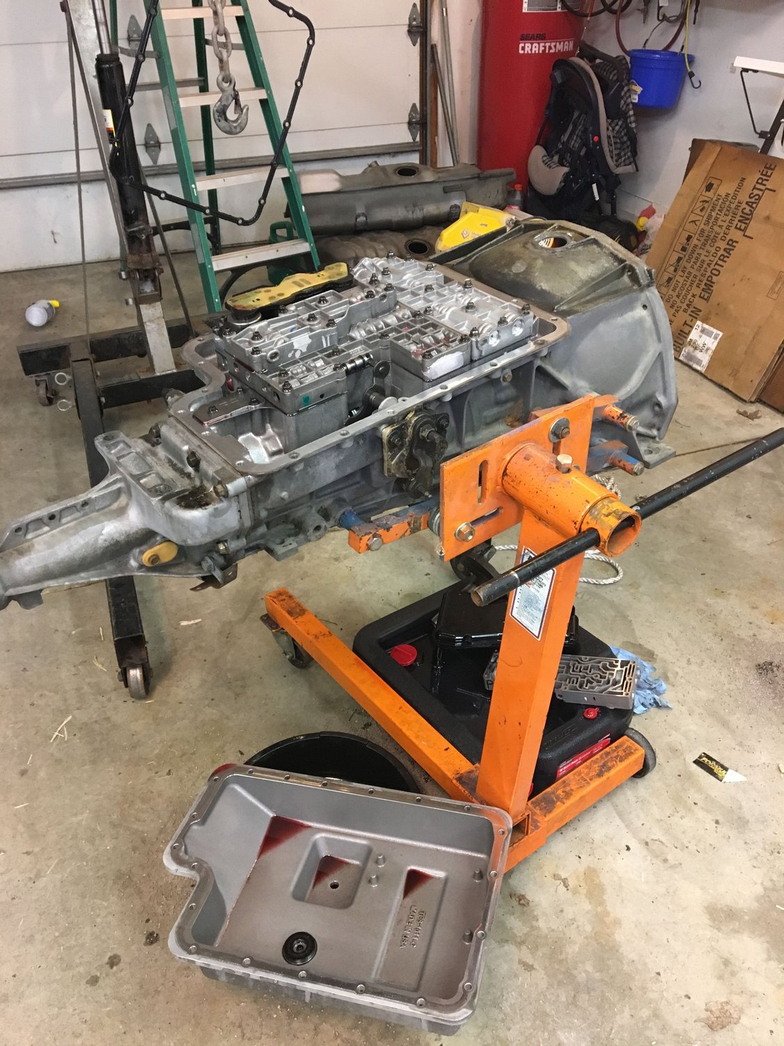

Another alternative, especially if you plan on pulling the pump, clutches, and other internals. This pic is of my brothers transmission he pulled to do a little work on it.

Have to keep that one in mind. And on a HF 3-leg at that.
What's the depth on the bolts, if you know?
