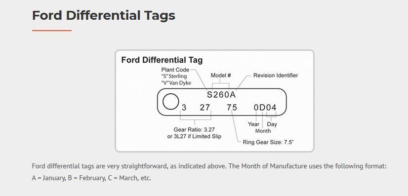

Here are the numbers from my differential tag:
S838J
3 55 88 5F23

I don’t know which way the passenger axle turns on your truck. It should turn the opposite direction based on the tag.
Originally Posted by SFaulken
Offhand, and I haven't checked your axle code, it sounds to me like you've got a factory limited slip (Trac-Loc)....
Only if the “L” was omitted in the post. Factory limited slip would read 3 L 55.

No, the "L" was not omitted from my post. So rotates opposite. It is an open differential.Yes, the noise is only when turning left. What do you think?
It seems to be a Sterling model 838 rev. J, 3.55 ratio open differential with an 8.8" ring gear made in 1995 June 23.
https://www.differentials.com/technical-help-2/differential-identification
