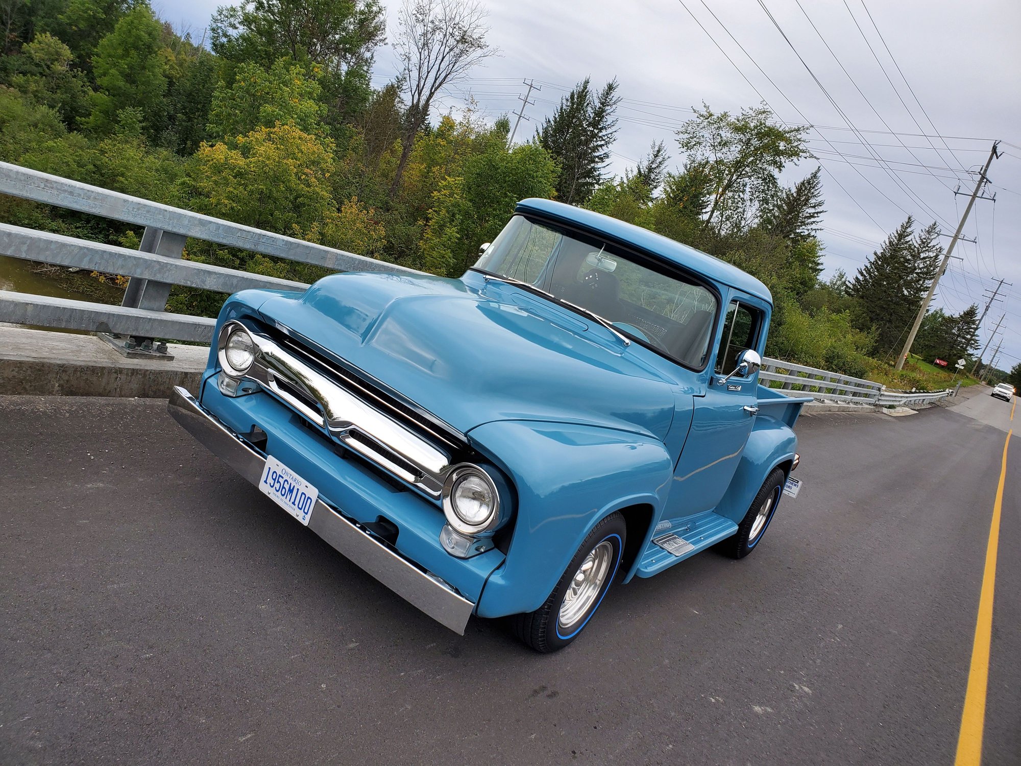

Holy smokes Fast - that truck looks awesome.

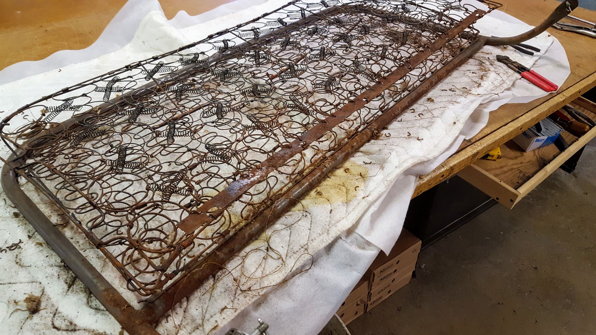

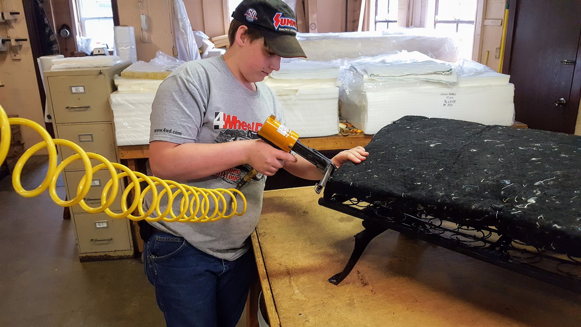

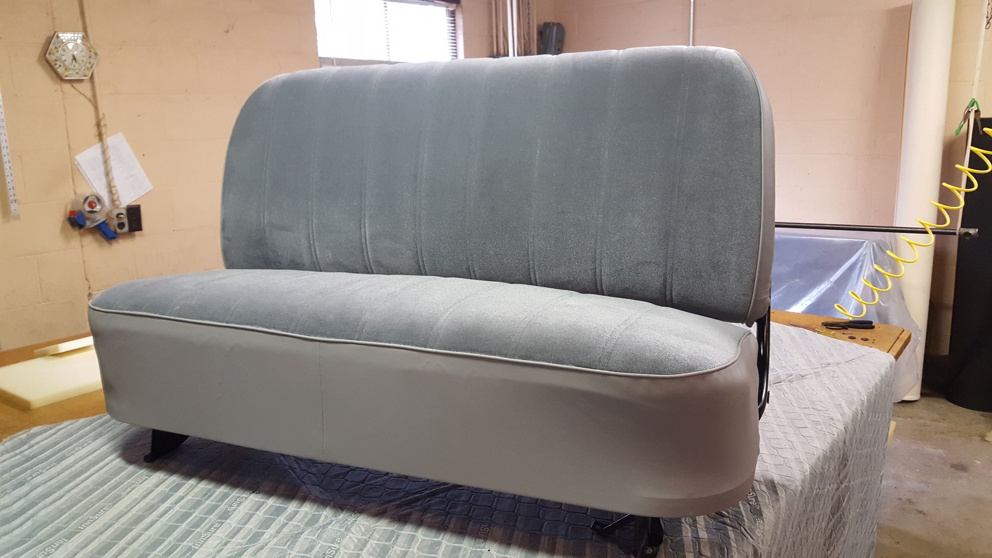

Here's mine for a 49 F1. I did it myself, with help from my sons so I could teach them. I am not an upholsterer but work in a field that I have access to all the supplies and tools needed. My springs were rusty, broken, bent and full of mouse nests. I bought the pre-sewn cover from LMC.

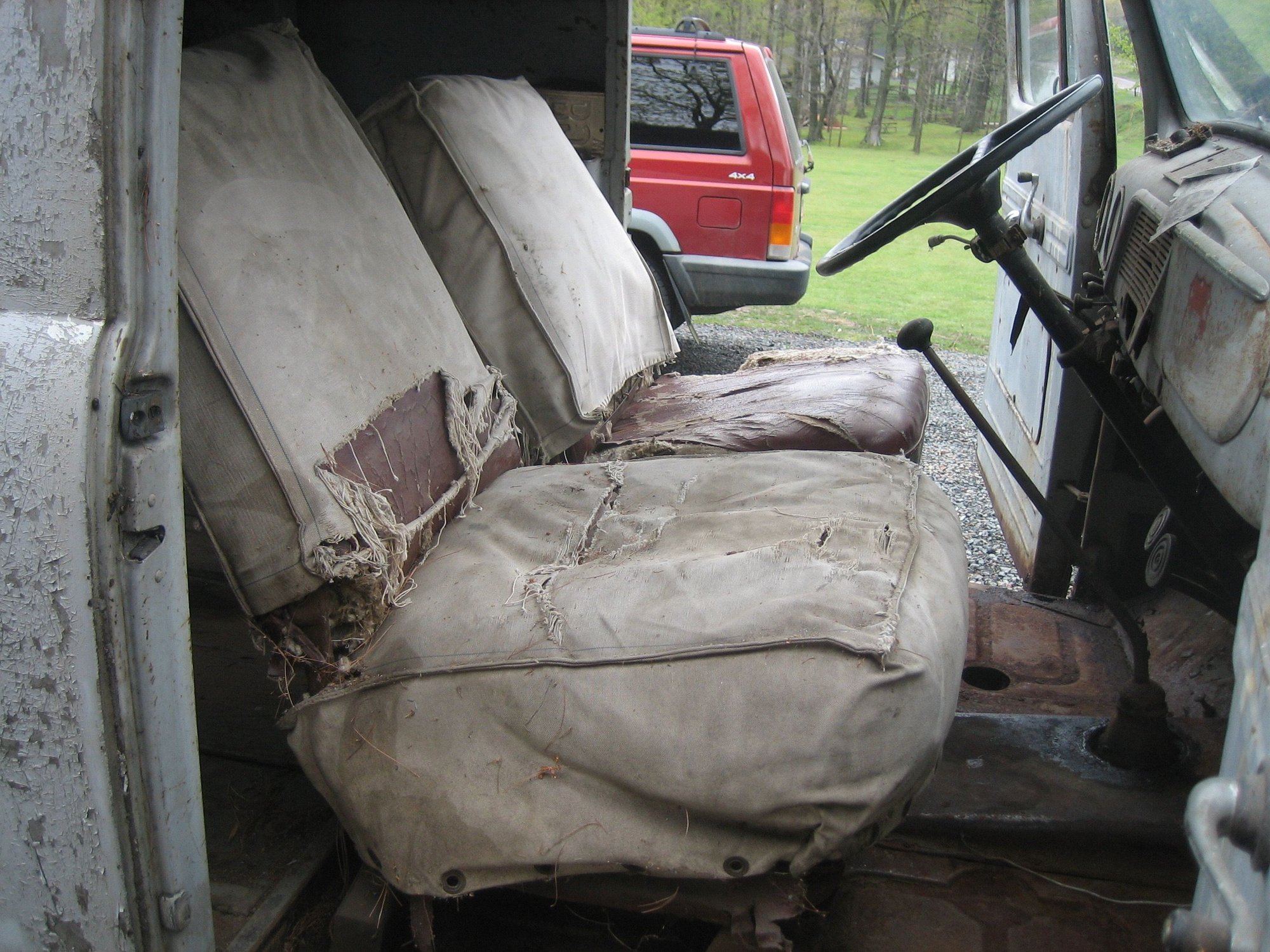

My seats were rough with broken frames and coil springs. I wanted an original correct restoration with materials as close as possible to what was used originally. The only compromise we made was using some foam in place of cotton in the seat bottoms. Originally, only springs, burlap, and cotton batting were used. The seat backs are correct and don't have any foam. I was given a quote and a time for pick-up, and the shop stuck to our agreement even though the springs turned out to be worse than we thought.

This was the starting point:

Looks good! I had many nets as well haha, original burlap sac underneath and had been sitting in a barn. I cleaned and painted the frame and repaired all the springs etc. Best clips I found for the springs and all the zip zags was clothesline clips, worked perfect!
