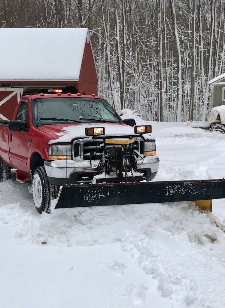

Built a new ballast box that makes it easy to load/unload with the fork attachment on my tractor.,,

I'd strap that puppy in, if you ever have to hit the brakes hard, that'll come siding up slamming into the front of the box.
I hear ya...
I retrofitted braces made of 8' long 2x4, lag bolted into the 2x12 ends of the box. They run right up tight up against the front wall of the bed. This matches the recommended setup in the Fisher plow owner's manual.
Then I put a 1/2 lag eye bolt into the back wall and ran some stout 5/8" poly rope through it up to the tide down brackets in the front corners of the bed and tied it off taunt. This way I'm not 100% dependent on the tail gate latches to keep it from flying out the rear end.
I'm looking for a way to lash it down with ratchet straps, but the back corner tie down points are not well placed to do so....
