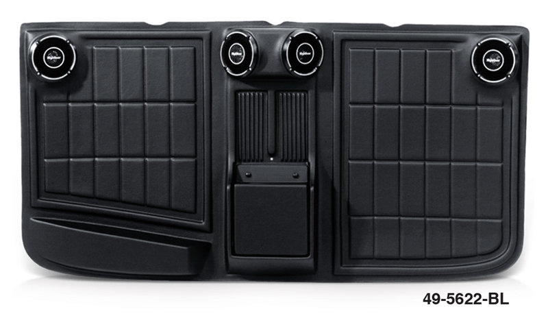

Get some QUALITY speakers and a quality radio with some internal power and then put them in the OEM door speaker positions. Yes maybe a thin sub under the seat, might have to put small riser blocks on the seat rails to get the space? Also check out the headliner that has speaker built in. You can also get some angled deck mount boxed speakers and mount them under the front edge of the seat. Or check out a UTV sound bar or (see Boom tube) for under there.
https://www.lmctruck.com/1973-79-for...lt-in-speakers
https://www.lmctruck.com/2000-05-for...ered-subwoofer

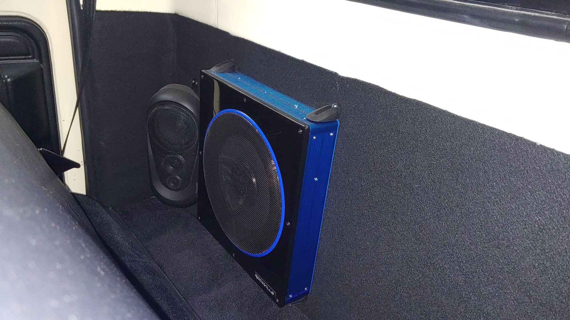

No easy way for sub under seat
Some of this post wont apply due your gas tank situation. There is less than 3 inches below the seat for a sub. I couldnt find one that would fit. Not to say there isnt one available. You could put spacers from the harware store under the seat brackets to lift the seat and give you more room but then the bottom of the steering wheel might be too close for your legs. I bought a powered sub that I ended up mounting behind my seat as well as a pair of Pioneers in the corners where it is double wall so the mount screws wont go through the cab. I also put Pioneers in the doors with foam surrounds from Amazon that keep the door panels from rattling and also noticeably increases bass. I have an Alpine deck with Bluetooth and have the mic poking out on the bottom of the steering column. Call clarity on it with this mic is amazing. The powered sub saves a lot room as there isn't separate amp and sub. I also didn't buy crazy high end equipment as a 3rd grader can break into these trucks with little effort.
Pioneer door speakers
Door speaker foam for bass and stop rattles
Pioneer TS-X150's
Powered sub and Pioneer
Rockville powered sub .

Nice sub setup! I'll look into that for sure.
I'd vote for the Pioneer coax speakers as well, they are just good value for money and work quite well. As far as head units I'm partial to Pioneer as well, but Alpine vertainly don't do a bad unit either. Both are reasonably priced nowdays, its not like back in the 90's when you had to spend hundreds (or thousands!) of dollars to get a good setup into a vehicle.
- boingk
EDIT: I just realised that the Rockville unit is only 2.7" thick and is a 10" non-ported sub. Far out. That will have issues unless you dial it in really finely and don't overdrive it. I'd be much more comfortable recommending a low profile 10" box with even a cheap Fusion subwoofer and seperate amp. The box tapers from about 8" depth at the base (on the floor) to about 5" depth up top, mirroring the profile behind your seat. Might cost more but it'll get a great result.

I bought the Rockville in hopes of putting it under the passenger seat but it was too thick, even with the spacers under the rails so I gave up and put it on the back of the cab. It has amazing bass for a cheaper powered sub. I have recently painted the cab floor with KBS coating and then put sound proofing down and then heat insulation on top of that so I lost a little space between the seat bottom and the floor.
