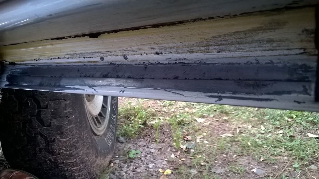

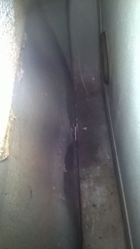

Here are some pics of my door. In this first one you can see stains where the water ran down between the door panel and inner door.
In this next pic you can see one of the 2 weep holes. This one is the bright line in the middle of the pic. Notice the inner door is sprayed with a coating from the factory. Also there is no rust inside the door. The dark areas are just damp spots
More concerning though was the rust under the weatherstrip at the bottom of the door. While making sure the weep holes were clear, I noticed some reddish discoloration in some age cracks in the seam filler from the factory that is applied before paint. I used my fingernail and a little piece flaked off.
I pealed the weatherstrip back and scraped a bit more.
You have seen those trucks and vans with the bottom of the doors rusted out, this is one way it starts!
The bottom of the exterior door skin laps over and up around the inner door metal. I scraped and wire brushed the area till I removed all of the loose areas that had any signs of rust. Then I decided to use some Oshpo rust converter because it is very thin and could flow down into the lip where the metal folds over. I didn't want to get the Oshpo on the good paint so I used gloves and a rag to apply it pressing it into the seem so force some Ospho in the seam. Many web sites say to let the Oshpo dry 24hrs and then rinse it off. Many people have trouble getting paint to stick after Oshpo. I read on a body repair site to wipe it off just before it drys. I waited a couple of hours after applying it and wiped it off. I then sanded the area, repeated the Oshpo, and finally sanded again. You can see the dark spots where the Oshpo converted the rust.

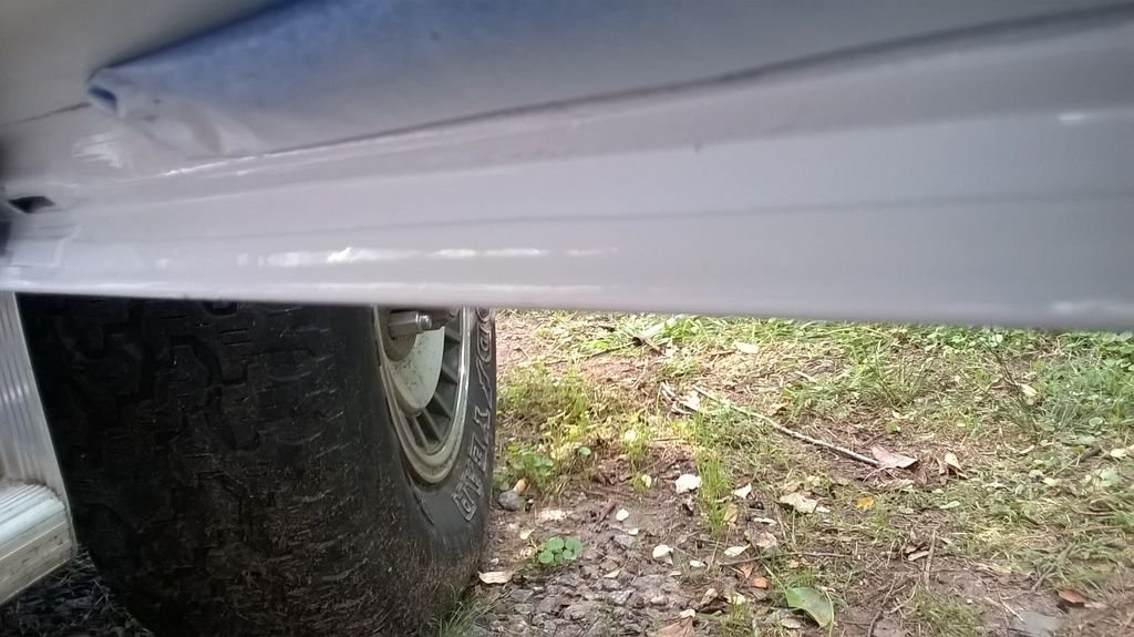

Next I mask the area off and primed it with self etching Rust-oleum. The proper way would have been to use a seam sealer first but I just used several coats of primer and paint.
And the final product matched so close that by the time you look under the door and back at the whole van, the paint looked factory!
The moral of the saga is to check under all of the door seals at the bottom of the doors and look for rust so that you don't end up driving around in one of the vans with the rusty doors!
