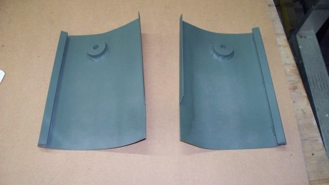

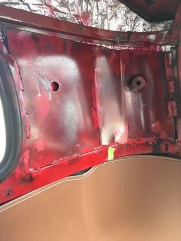

Here is what the small window brackets look like. This is a weld job to install. You will need to cut out liner for mounting boss (where top belt mounting screws in)
Here they are installed. They did not all fit. A few new words not suitable for women and children had to be invented. Similar to removing original hinge pin in time and difficulty. Surprised Mid-Fifty would sell something that the fitment is so bad. Just awful. Notice the slice and dice, the finger hole, the beautiful paint job.
Mine wasn’t perfect but all it needed was a bit of bending and grinding.
