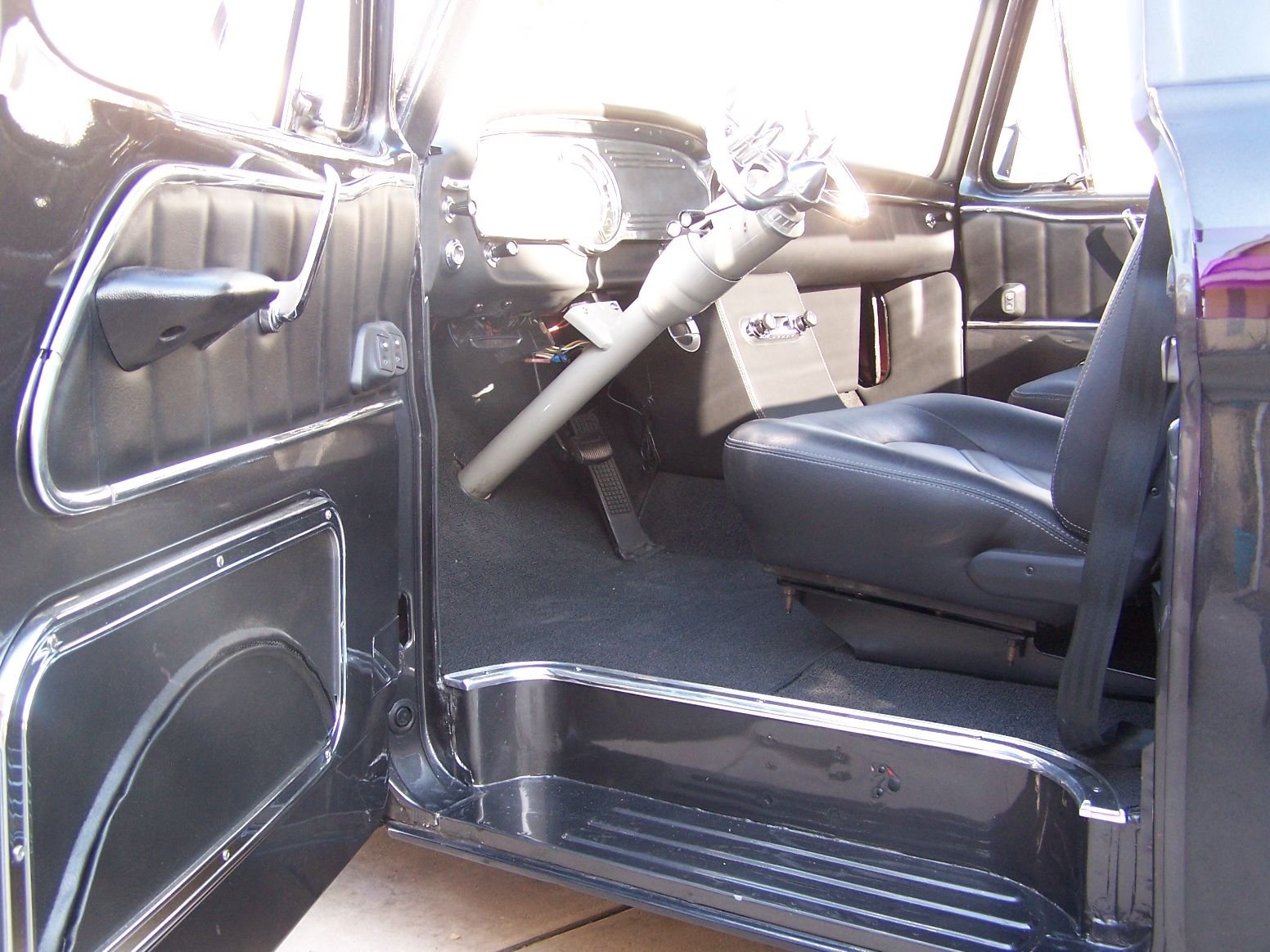

Here's what mine looks like.

Posts: 554
Likes: 13
once again your truck looks absolutely awesome! Did you do the carpet yourself?
