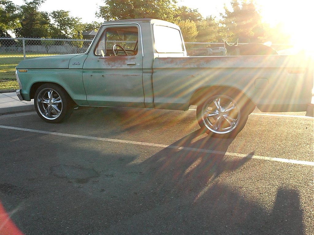

beams, shackles, and hangers 16x8 wheel vintiques all around.
Thanks for the picture, nice car
