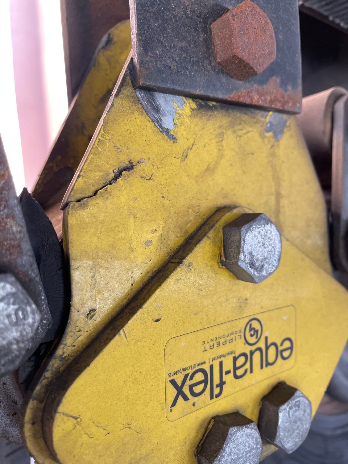

Originally Posted by Brother_Bluto
"Approved by Lippert" is relative. It is "approved" because they have a marketing agreement with Reese. In other words, LCI makes money off every one sold which is why they "approve" it. Having said that... not knocking the product. Most owners love the hitch (as with owners of other hitches as well).
I get it. You're not wrong being cynical about LCI. But they did overnight air me a set of their failed equa-flex equalizers when their originals were starting to fail. I did the swap. They covered the parts. 2 years out of warranty.
I'm really surprised they did that, it is nice to hear of customer service. That being said, so what they have an agreement, they cover the GB and at least won't automatically deny frame issues as some do with gooseneck hitches.

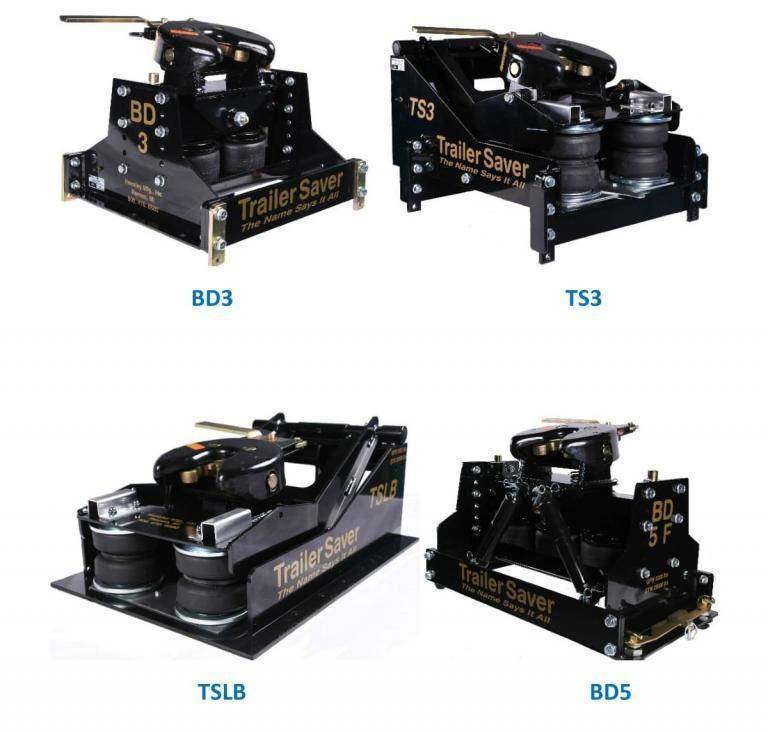

@porthole
Thanks for reporting your real world experience with the TS3.
Some have said that the original design of the TrailerSaver (the TSLB2H) remains the best (rated at 32K LB, 7,500 pin with 3rd bag option), and the TS3 comes closest to that original design, with the forward reaching pivot arms.

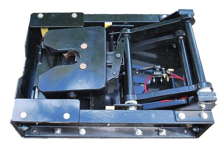

However, even the vaunted TSLB2H was thought to need improving upon by a maverick named Henry Szmyt, who created a line of more robust (and even more expensive) air ride 5th wheel hitches named the ET hitch, which comes in 3 models.
ET Junior TSR (where TSR stands for Trailer Saver Replacement), as the ET Junior bolts in place of the TSLB2H, where full time RVrs face the choice of repairing the TSLB2H or replacing it altogether:
Pin Weight Rating: 8,500 lbs
Hitch Weight: 470 lbs
Stepping up in capacity for the ET Junior is the ET Senior... 33K lbs trailer weight, four air bags, 5" vertical travel, self leveling,
Hitch Weight: 735 lbs
ET Super Senior
Pin Weight Rating: 8,000 lbs
Hitch Weight: 750 lbs
Again, not the best hitch to "pick up" at 750 lbs! But arguably stout, considered by some full time Escapees running HDTs (ie Class 8 Volvo tractors pulling Spacecraft type RVs) to be the "best", and interesting to look at and be aware of, even if not the most appropriate choice for a pickup. Why I mention the ET Hitch is due to it being designed to directly address the issues people found with the Trailer Saver, which they otherwise loved.

I am aware of the ET's as well as the several other variants out there. They are geared towards the HDT and MDT crowd's. And it was the HDT crowd that found out how susceptible the Holland-Binkley hitch saddle really was to wear.
