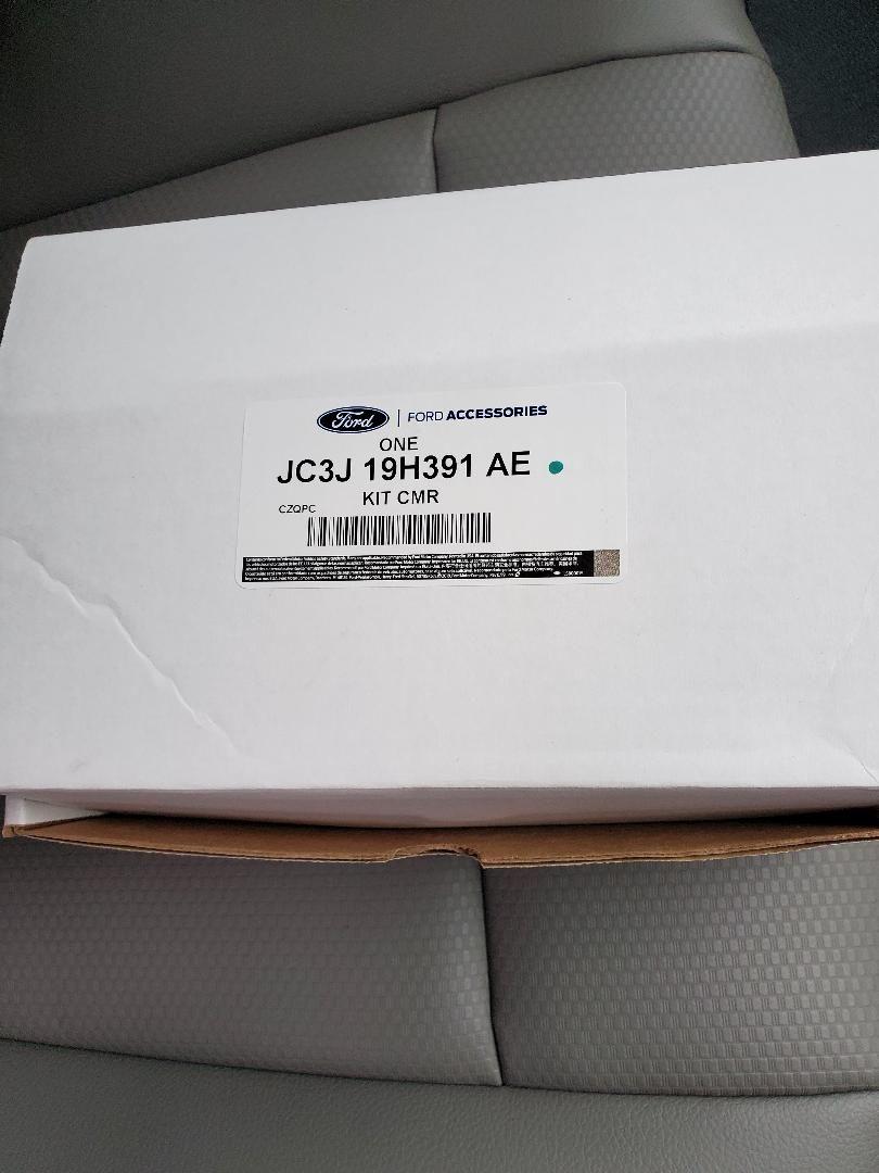

where does this camera harness connect to?
Old Jan 21, 2021 | 11:18 AM
94yj's Avatar
94yj
Joined: Mar 2006
Posts: 420
Likes: 19
i am trying to add this camera that came with my truck and need to ask where the truck connector is that the camera harness connects to

Is that the 'Customer Added Trailer Camera'? If so, it should plug into the smaller jacks below the Trailer plugs on the bumper or in the bed.

On my 2018 I had to change out the trailer connector at the rear bumper to plug in the included harness.
The new connector was also in the kit.
From what I can teel the connector and the harness are the same for eith or both the trailer TPMS and the backup camera, but you don't nessarly get all the components for both. It depends on what was ordered.

That is the chassis cab camera kit. The plug is on the rear drivers side frame rail if the prep option was ordered. These cameras can also be used on all the pickup trucks as trailer cameras if you are inclined to go under the truck and unplug the tailgate camera and plug this in. It's a low budget work around and these cameras are the same as what is provided in the trailer camera kits.

2020 f350 bed delete cab and chassis
