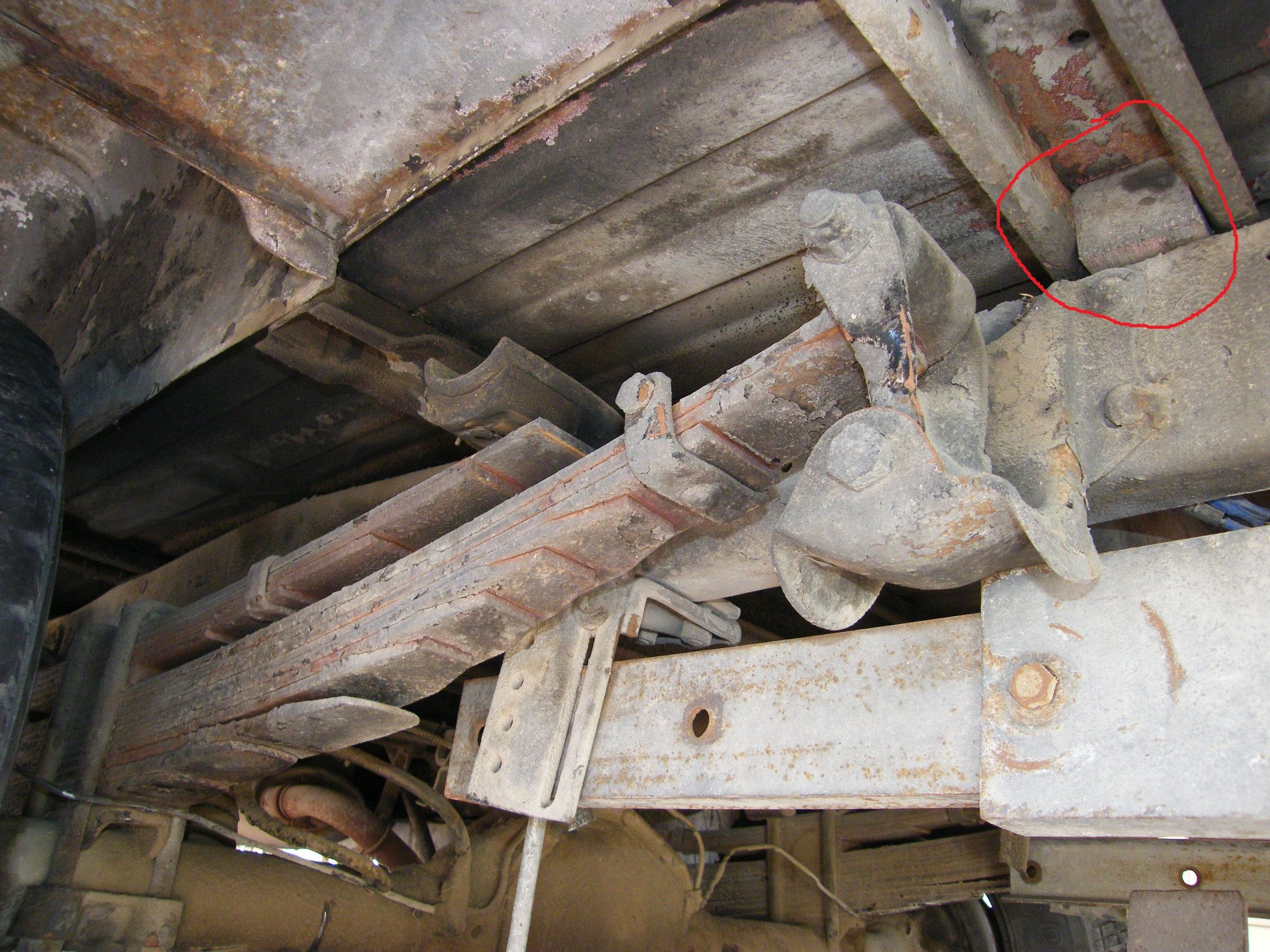

Wood blocks as shown below.

I was wondering why those were there. Odd.

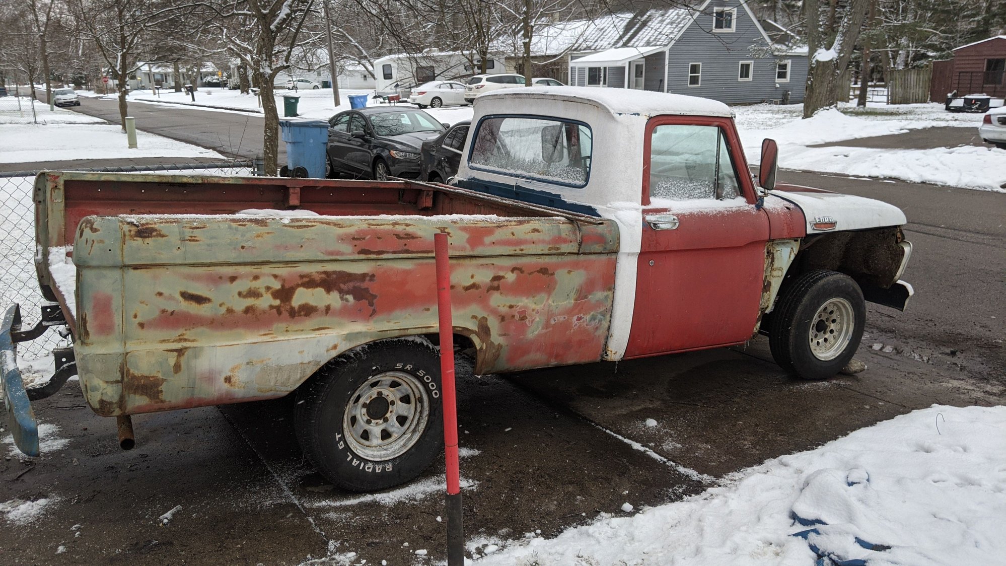

Here's a pic, I also have a thread I'm adding pics and updates as I go

My 63 had blocks made of oak. That rear bumper you have is bowed pretty bad, it should be straight across.
I think that might be the picture. Its not curved if I remember correctly
