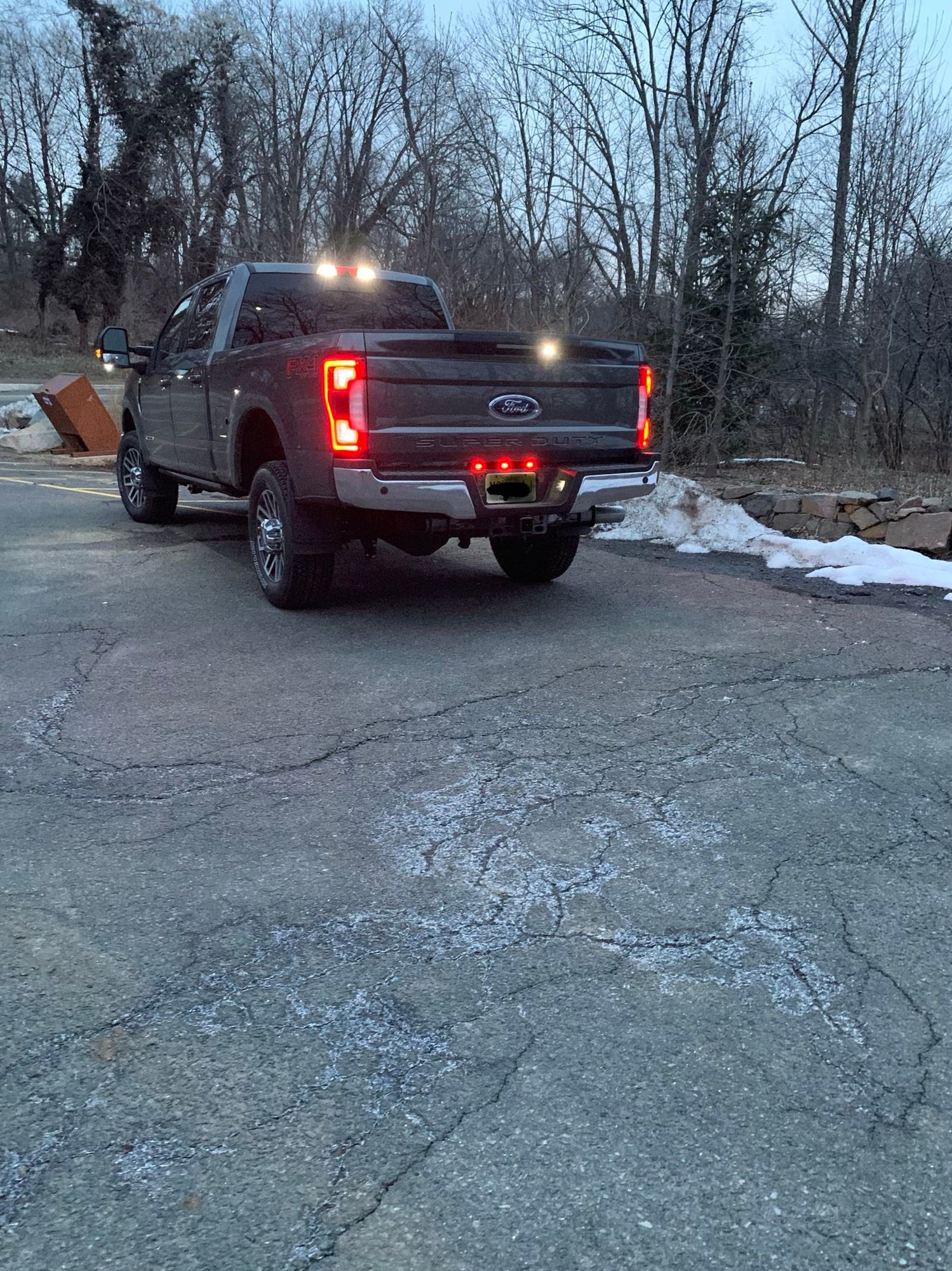

Received my Ford dually center marker lamp and I’m ready to install it.
Is it ok to tap into the brown trailer plug wire, or should I use something else? I see a lot of guys using the license plate bulb wiring but man those things are THIN. I know it would probably be ok but I’m a little OCD and would prefer a bit thicker wire for tapping.

I did tap into the license plate light for the power. I had to disconnect the bulb out of the socket and then use a t-tap and spade for the connection. It was a little tight getting in there with my hands but it was do-able. I didnt want to mess with the trailer plug harness/assembly.

I tapped a light for the license plate and then ran the ground underneath and bolted that to a spot for the ground.

Part numbers I used. Harness plugs into the light and wiring is simple.
Rear Light HC3Z-13A613-C
Harness 8U2Z-14S411-AAC

I tapped a wire on my 2017 and had no issues. But for the 2021 I used this video
I like this method much better and will never worry about it ever failing. And I took every harness apart while I was back there and greased them all and put them back together so I never had to worry about water being an issue.

Wow! That’s what I was looking for. I do hate to cut the blue wire, but with the way it was put back together and taped into the existing harness it should be fine.

I tapped the license plate wire, solder, heat shrink, tape then wire loom and more tape. They're secured and water-tight.

My goal was to not fuss with the large body harness, or use posi-taps. I'm working with someone to make a harness that goes between the factory license plate light plug and the harness.

I'm just going to snip the wire at the big white connector and use a butt connector. Easy-peasy. I have my lights here...just waiting on warmer weather

I ordered the pins from A Rod. But I’m curious about this harness... where exactly does it plug in? Do you transfer the factory pins into a new housing he’s providing?

I have the stuff from ARod too, but i wanted to avoid opening that body connector. With this one, it just plugs directly between the license plate LED plug and its harness plug, the center marker light is then powered off the pigtails coming off the harness.
