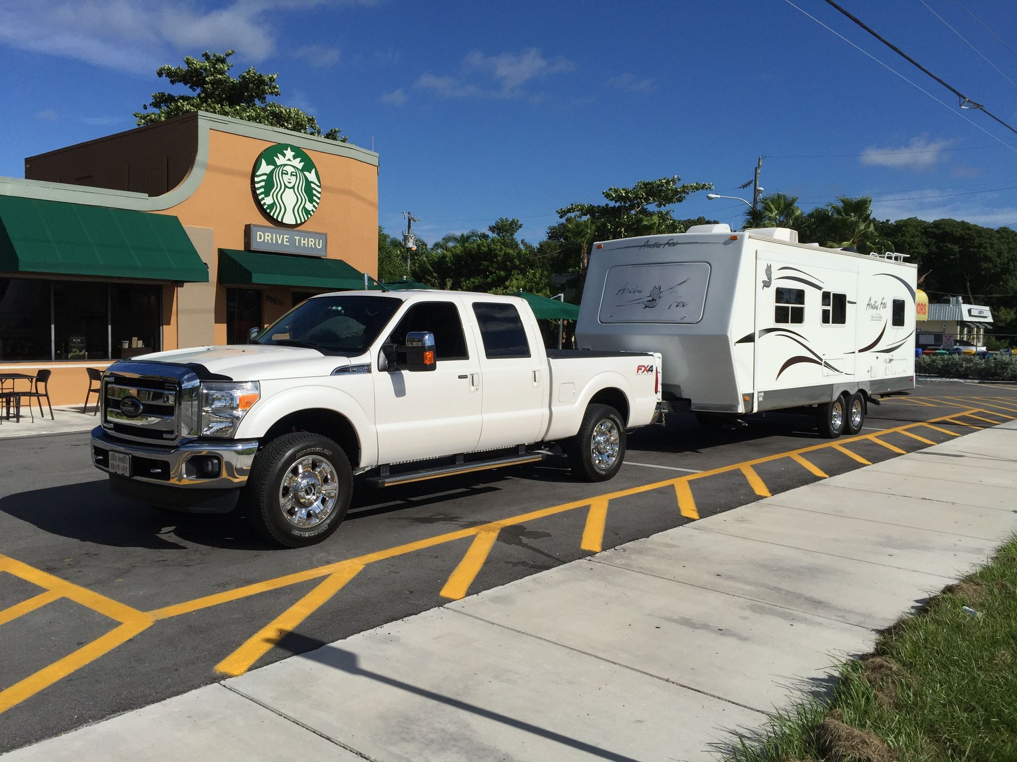

I think you'll be pleasantly surprised. I had a 15' and 17' F250 4wd, 6.2, 4.30's. They each handled 10,000 lb my Arctic Fox Trailer just fine. Air-Bags helped with the 1,200 lb tongue weight. The picture below is my 15' 250.
