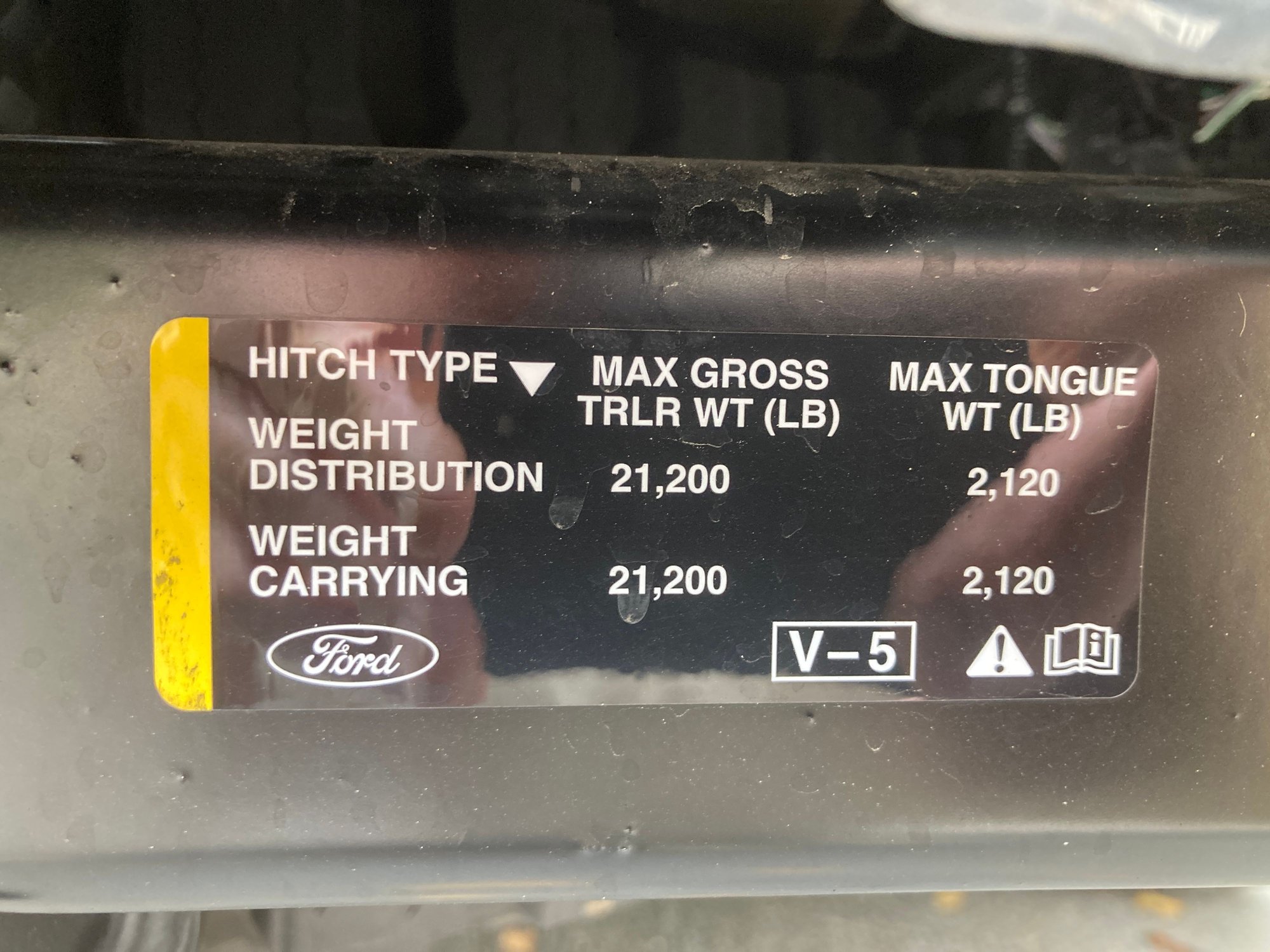

You should be fine, particularly with the high-capacity towing package. This is on my diesel 250 Tremor receiver:
Payload:

My 350 has the same sticker on the hitch. My load sticker in the door jamb is just over 3000. So basically the Tremor is just a factory 2” lift with no reduction in capacity?
Compared to your current truck, yes. You get a limited slip up front, leftover chrome PVD wheels painted black, an extra traction control profile, and a couple of crooked stickers on the bedsides. .

The sticker on the hitch is the capacity for the hitch. It is not the towing capacity of the truck.
Right. The same hitch he pulls his triple-axle boat trailer from.
