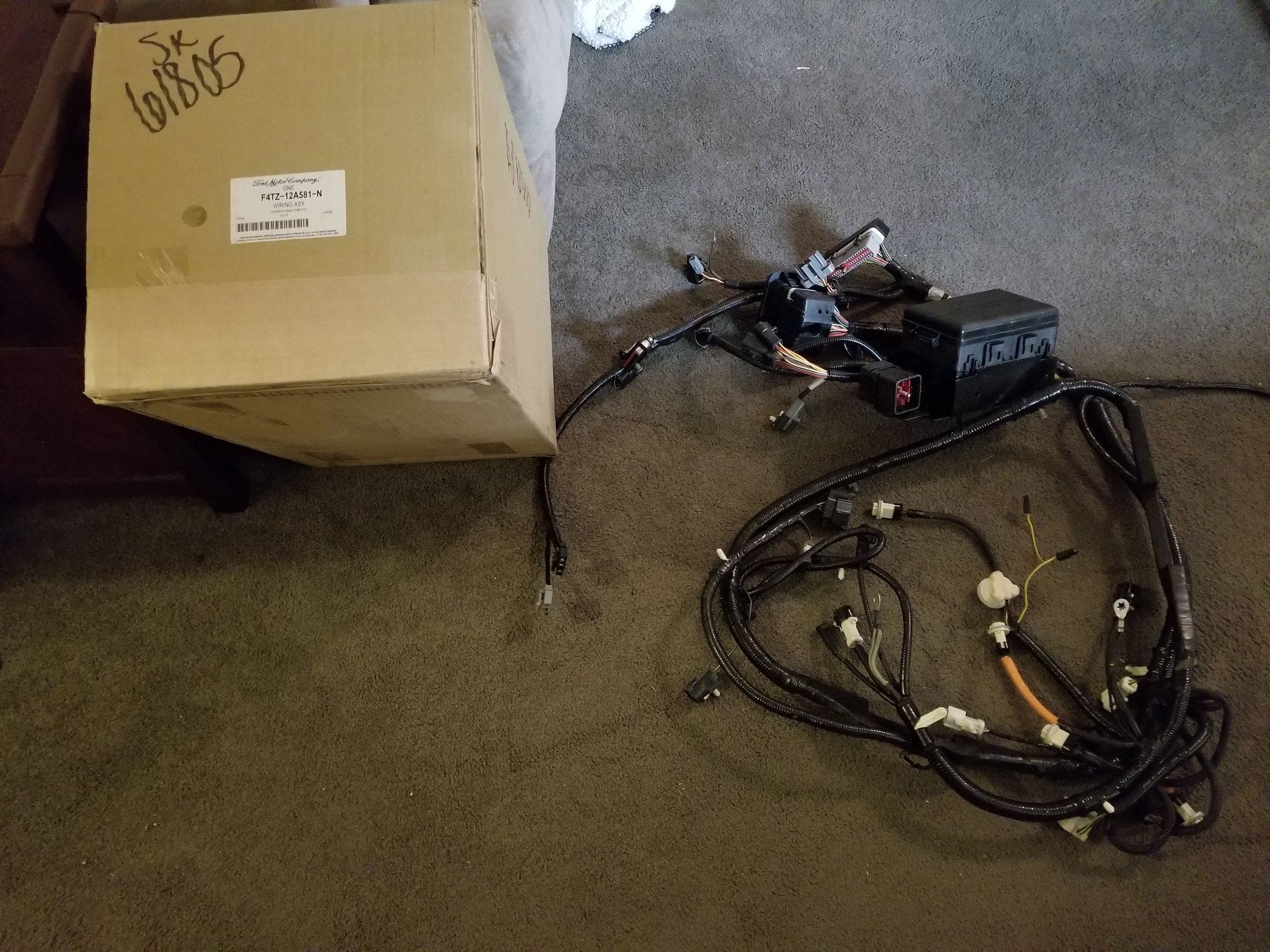

Old Jan 20, 2021 | 08:23 PM
R&RFord's Avatar
R&RFord
Joined: Aug 2015
Posts: 1,838
Likes: 367
From: Candy Mountain
Old Jan 21, 2021 | 11:22 AM
R&RFord's Avatar
R&RFord
Joined: Aug 2015
Posts: 1,838
Likes: 367
Alright, so the old harness is out.
Comparing the fuse boxes, I realized the original is missing a a relay and a fuse. Pulled out the owners manual, and it looks like a PO disabled the ABS and I never noticed since there was never any problems... so we will see how that works out when everything is back together. I am surprised the ABS light hasn't been on...
