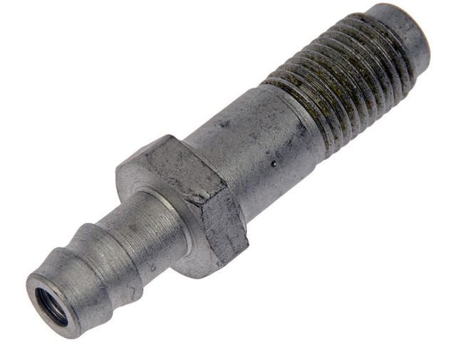

This hole?
You cannot plug that hole. It is the axle vent. There is supposed to be a hose attached to it.

No this one
