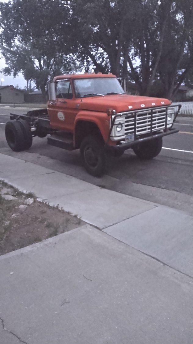

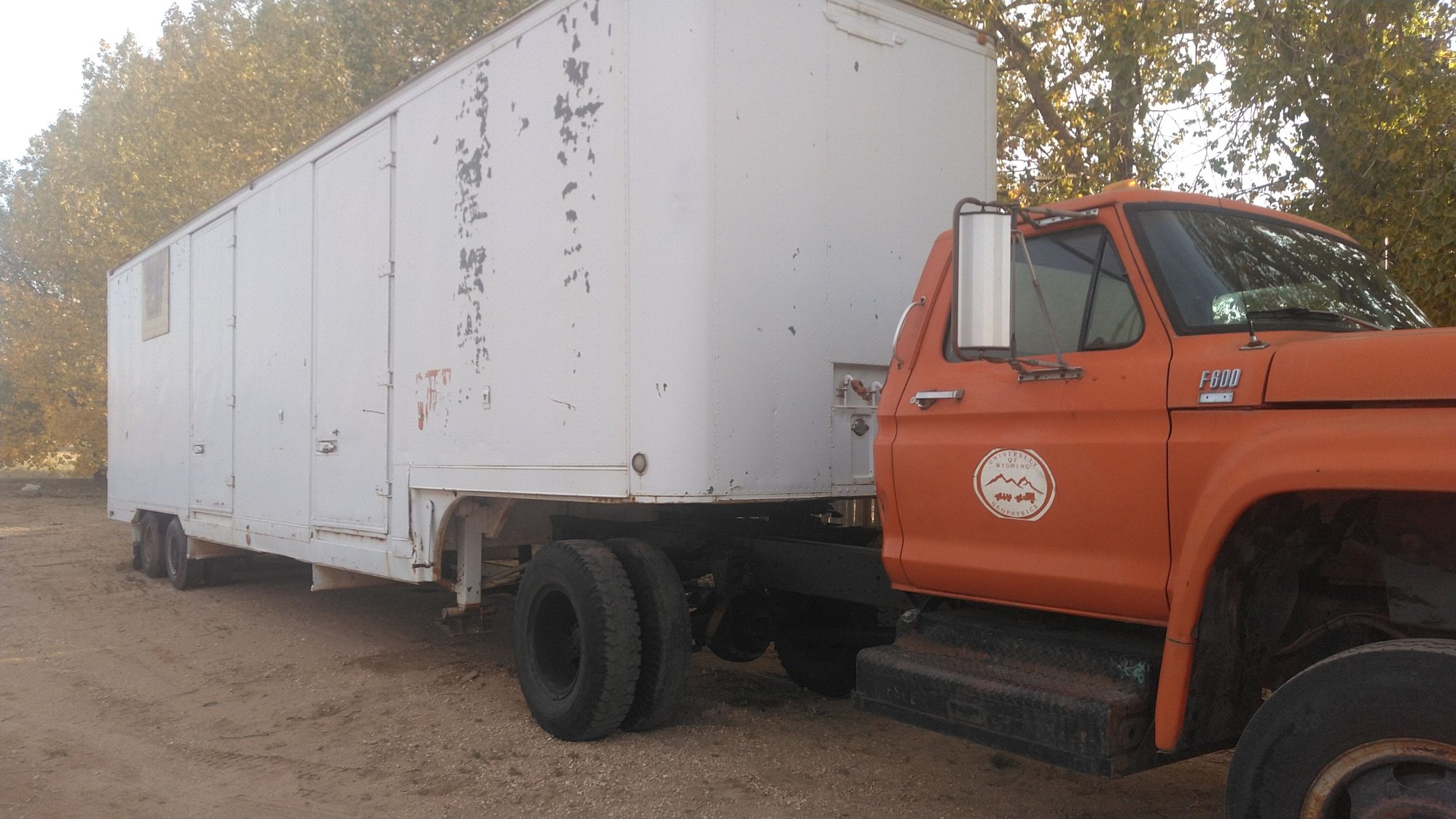

Brand new to the site so I'm not completely sure what I'm doing on here. I have a 1979 f600 4x4 with a 370 4v. I'm pulling a 40' semi trailer with it and it pulls ok but doesn't like 5th gear at all. I'm toying with the idea of a 7.8 diesel and a roadranger but I like the 370. I just wish it had more power. Any advice would be helpful
My ol 6 hundy
My trailer
