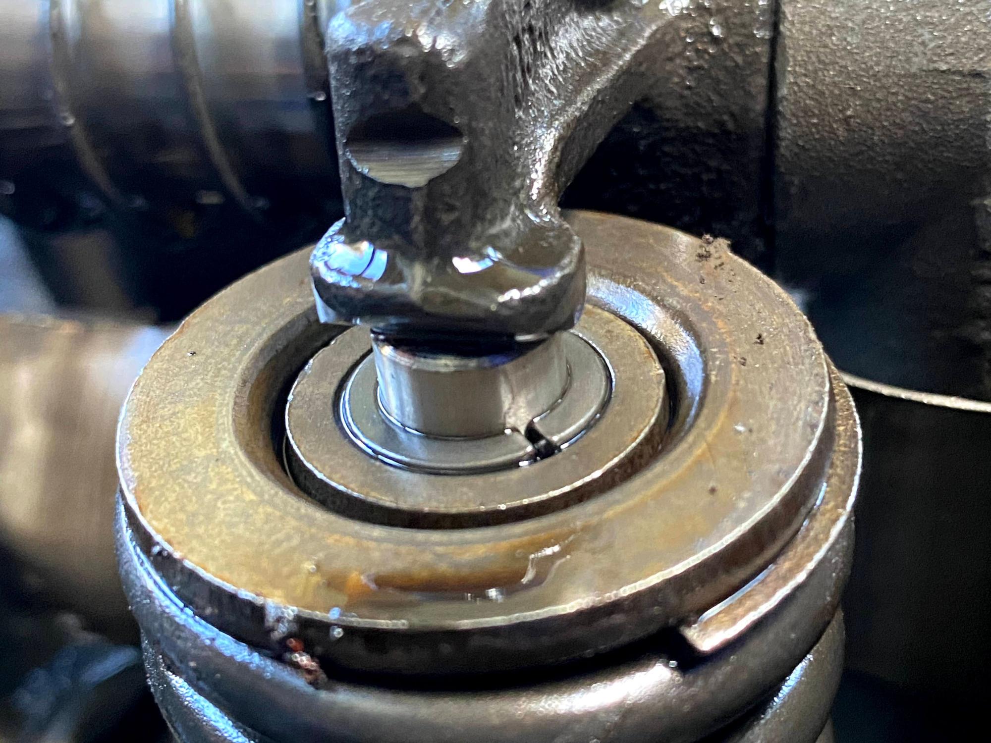

My 360 has a tapping issue. You can kind of hear it in the attached video and the tapping is coming from the left bank, mostly I think from cylinder 5. I took the rocker cover off and found a couple of rockers that are off center from the valve springs. They are still fully covering them, just off center. Is this acceptable and/or could this be causing the tapping? I have some pictures of that as well. If that is not it, what is the best way to go about trying to diagnose the issue? I should add that when I got the truck I did a compression test and #5 came back with the lowest compression at the time, although still an acceptable level (but noticeably low even for a cold and dry test). I am still learning my way through this engine so as much help as can be provided is much appreciated.
Sorry for the poor audio quality, I had to convert it to a different format to upload. I can post a link to a higher quality one if it helps.
This is the first rocker at the front of the engine.

The offset on a few rockers is normal but you may need to remove the shafts to check for wear. The rockers should be flat across the tip and not show any impression of the valve tip. Also check the pushrods for wear.
If you remove the shafts, make sure you put the bolts back in the same holes. Some years have a necked down bolt for oil flow so be sure that one goes back in the right position.

Thank you for that. They do all look flat across the tips at least, but I will do a closer inspection. I was planning on manually rotating the engine also to see how they are operating.
